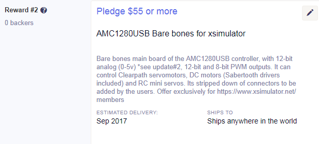

    Important update!
    I was looking around to see what the xsimulator members like to build the most and it came down mostly DC motor solution, with PWM drivers (MM) or using Sabertooth drives.
    So I decided to add a reward designed to serve all needs for all kind of platform used here, either they are 2DOF, 3DOF or up to 6DOF.
    The reward is very low price and is fully functional version of AMC1280USB (without 6DOF ext board) with only thing missing (to be added by the users) the 2.5mm Pin Headers. Removing those pesky through hole parts from the equation allows me to offer the controller for the price of $55 that will be available ONLY on Kickstarter!! This reward will be the first to be manufactured and ship out (September) when the kickstarter campaign ends.
    So take your chance and grab it as long it lasts! :)

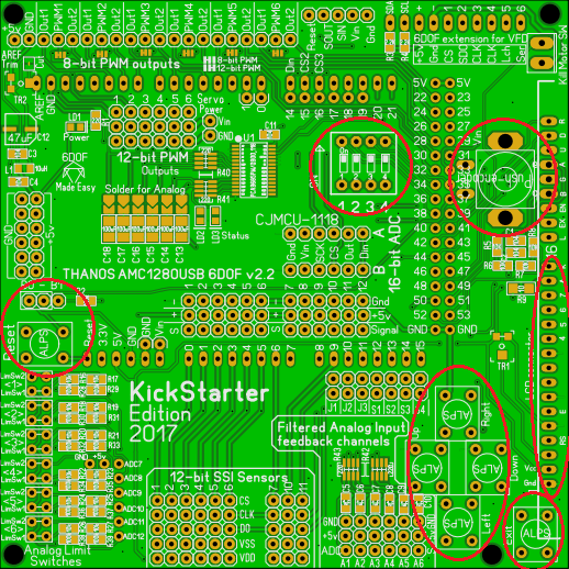

    Wow nice
    Do you have a photo of what is going to look like? And wiring instructions?
  13. Thanos
    Jul 6, 2017
    1,358
    Electronics Engineer
    United States
    2,773Coins
    +1,050 / 9 / -0
    I don't have a photo of a unit assembled like that, but I can share a image which shows what through hole parts will be on the board except the SMT parts that will be all soldered on manufacturing.
    You can see on the picture in RED circle all the parts that will be provided on the board. As you can see what remains are just 2.5mm pitch pin headers to be added as needed.
    I'll provide updated wiring schematics upon completion of kickstarter if not sooner.

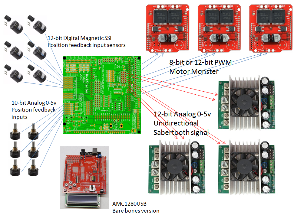

    Neat. I'm looking to do DC motors so the new kickstarter offer is tempting. Is the ext board needed for 6dof?
  15. Thanos
    Jul 6, 2017
    1,358
    United States
    2,773Coins
    +1,050 / 9 / -0
    No, the 6DOF ext board is not necessary at all for use with DC motors. The 6DOF ext is mostly additional host of DAC converters and amplifiers for 0-10v analog signals mostly for VFD inverters.
    Here a generic diagram of connection options available on the AMC1280USB Barebones version:
    I'll make more detailed connection diagram as soon is possible.
    Thanos
  16. brzez
    brzez New Member
    May 28, 2017
    Chicago, Il
    300Coins
    Cool. Im assuming the sabertooth is set to bidirectional mode which the AMC supports on the 0-5v output.
  17. Thanos
    Jul 6, 2017
    1,358
    United States
    2,773Coins
    +1,050 / 9 / -0
    Correct, all sabertooth models have this analog input setting, and it does not require calibration.
    Not sure why is called bi-directional on the sabertooth side, as one signal manages both speeds and directions.

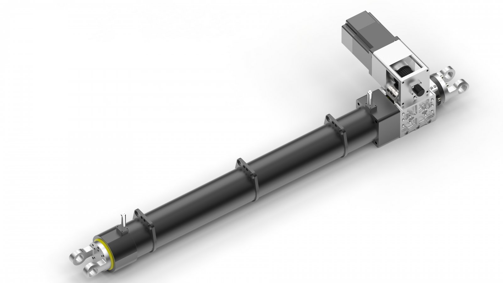

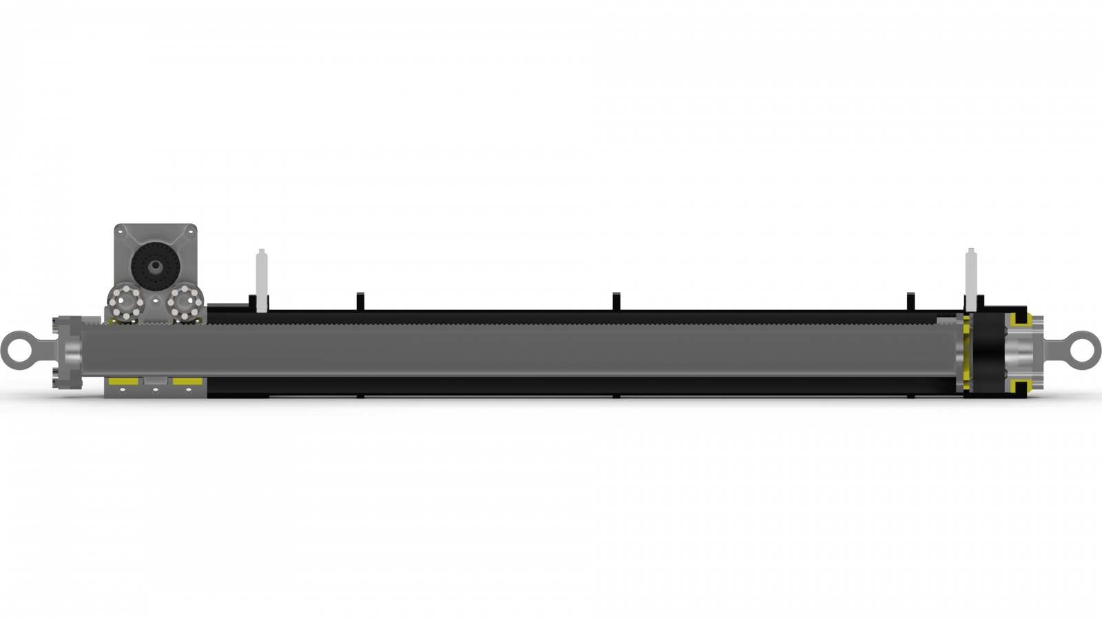

    Hi all,
    I'm working into getting a custom BLDC motor actuator reward available on the kickstarter if I reach the target goal. Its perhaps the best ready actuator solution for low voltage actuators designed specifically for motion simulators. Perhaps even better and less expensive solution than AC servomotor actuators! I'll be making available more information about these soon.
    These BLDC actuators have a custom servo driver that can be controlled even by the least expensive reward I offer on Kickstarter (AMC1280USB Barebones $55 pledge)
