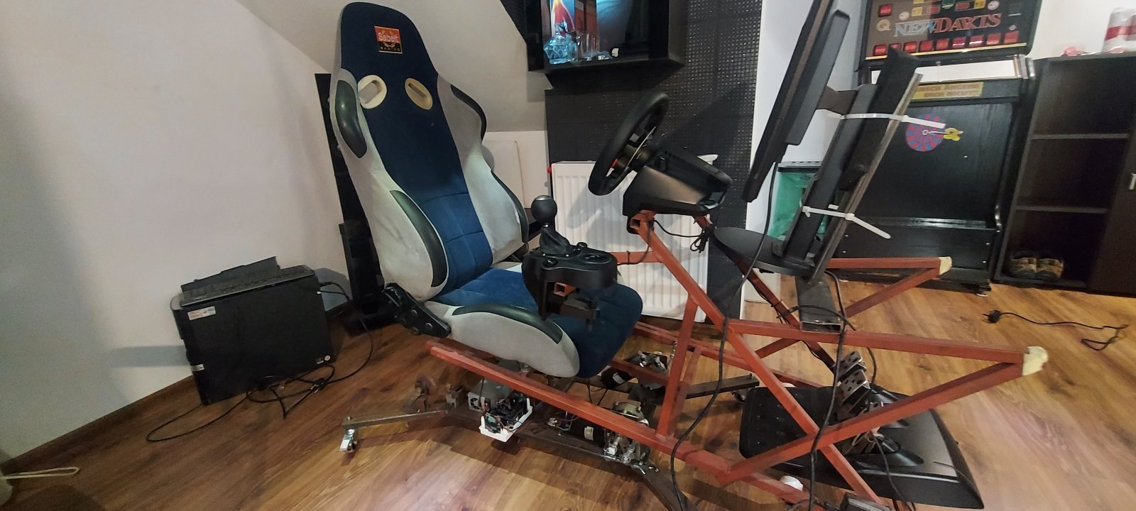

    Few words about me...

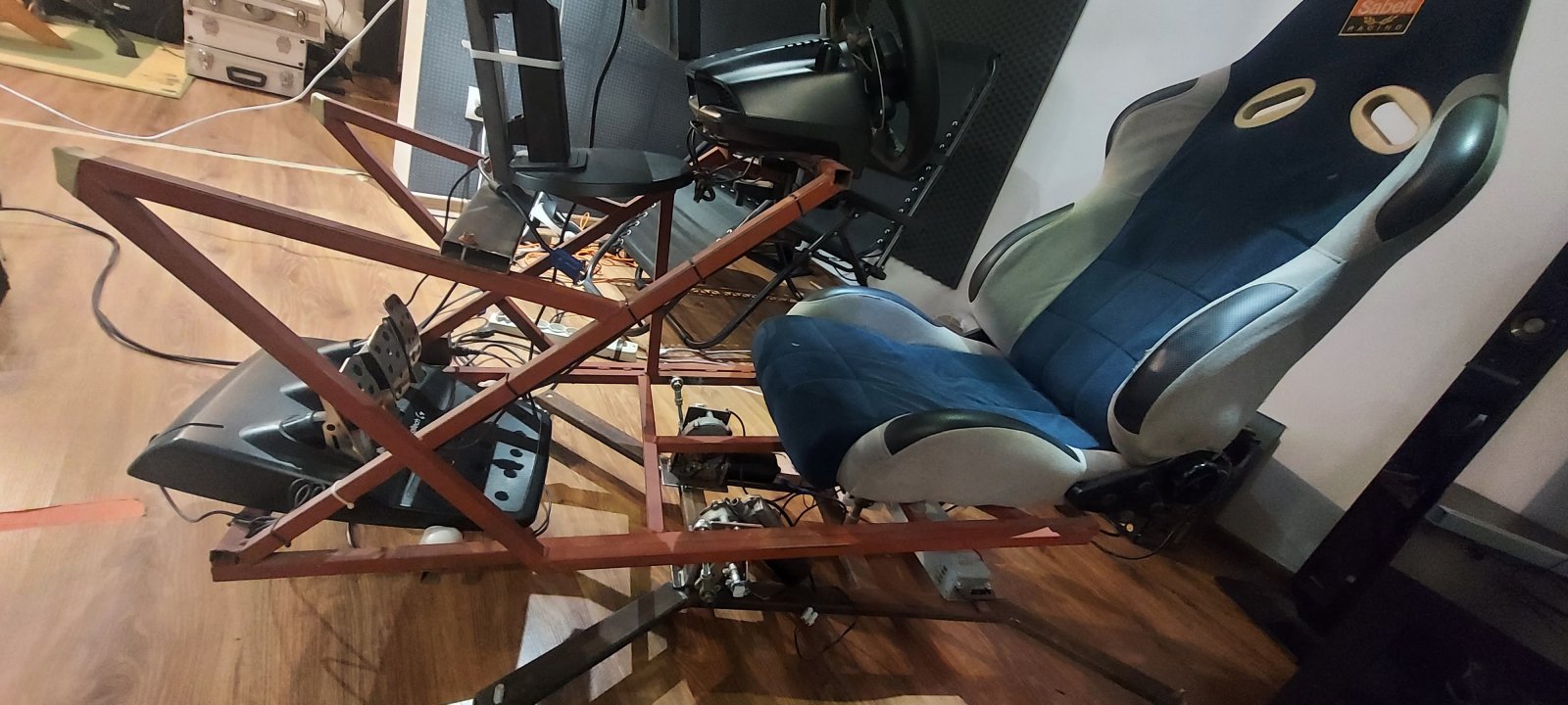

    I am a teacher, works, and tools to inform about the company that will be a tool service for CNC machines. I have experience in operating, operating and programming machines. My interests are similar to the simulator of people who found their way here: IT, mechanics, technology, Robotics, Engineering, inventions, music, etc.
    Design.
    My project is completely new. While searching the internet, I came across projects, which aroused my curiosity and inspired me. I decided which one was set in the target and here is my version, based on other people's projects (respect for that)
    Photos:

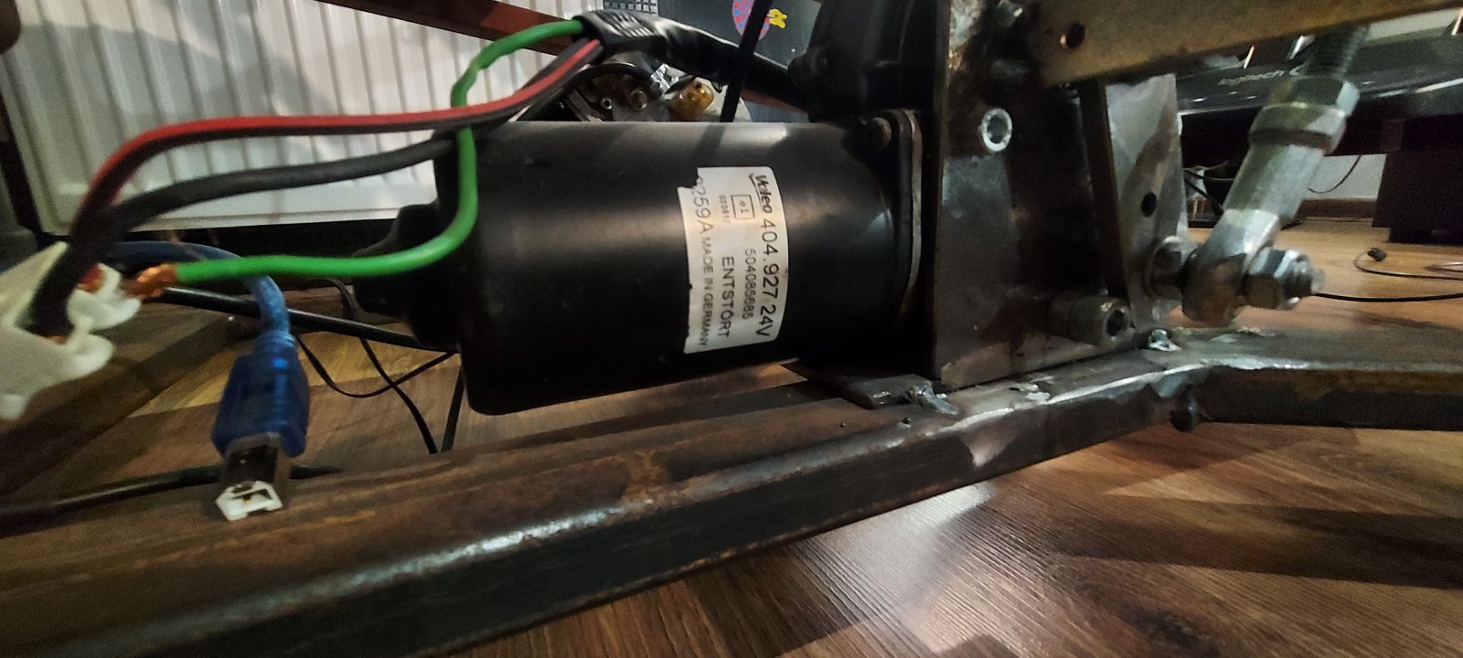

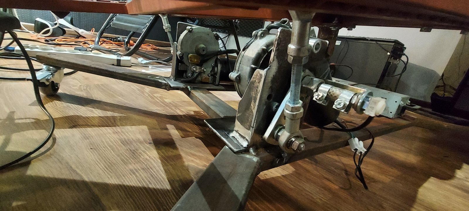

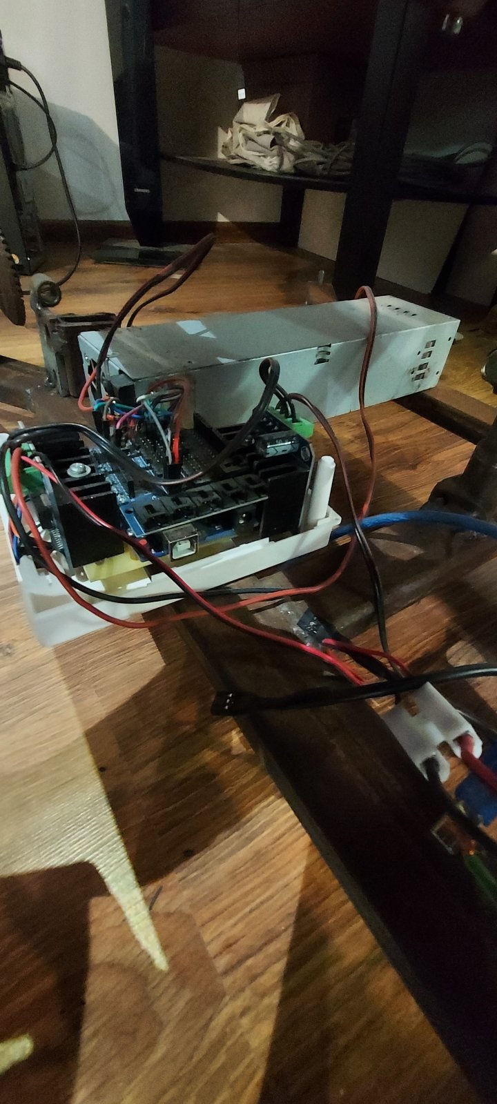

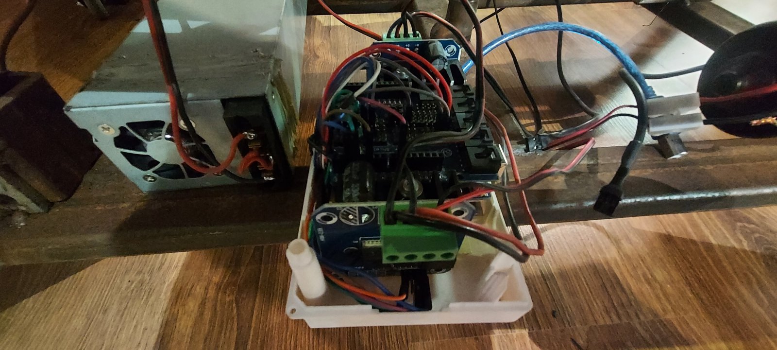

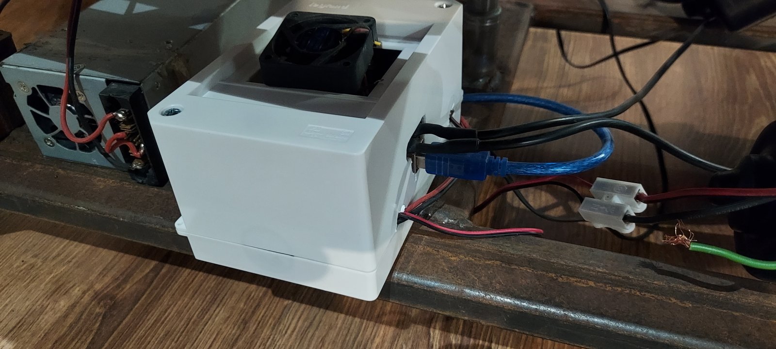

    Component list:
    - Adruino Uno
    - 2x Bridge H BTS7960B 43A
    - Arduino sensor shield v 4.0
    - 1x HP DPS-600PB B
    -2x Valeo 404.927. 24V
    - 2x cermet Vishay P11VYN010K
    - 4x uniball M8
    - electric casing
    - laminated board
    - steel frame welded according to your own design

    Preparing the power supply
    https://www.xsimulator.net/community/threads/how-to-modify-a-server-power-supply-for-12v.5774/

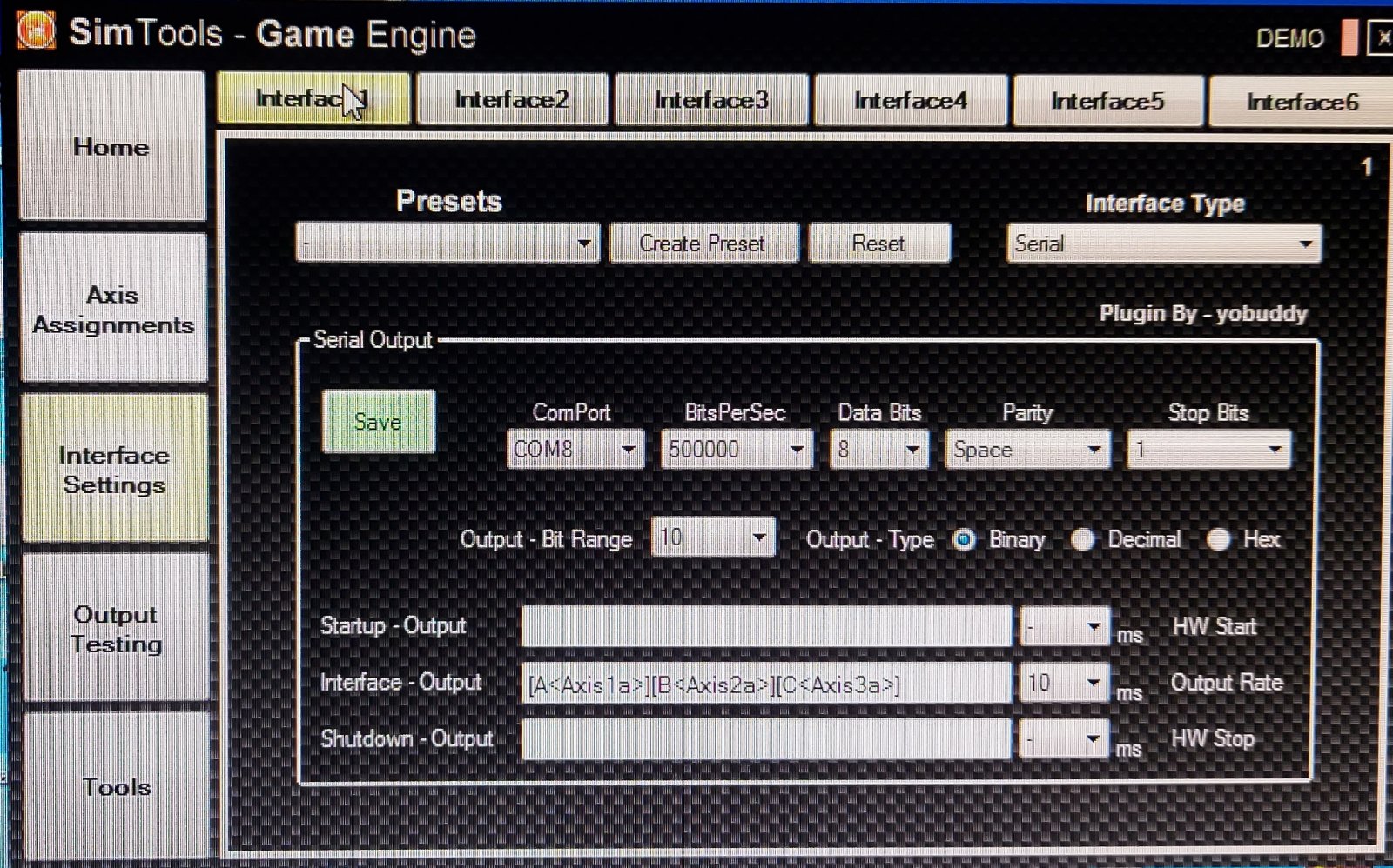

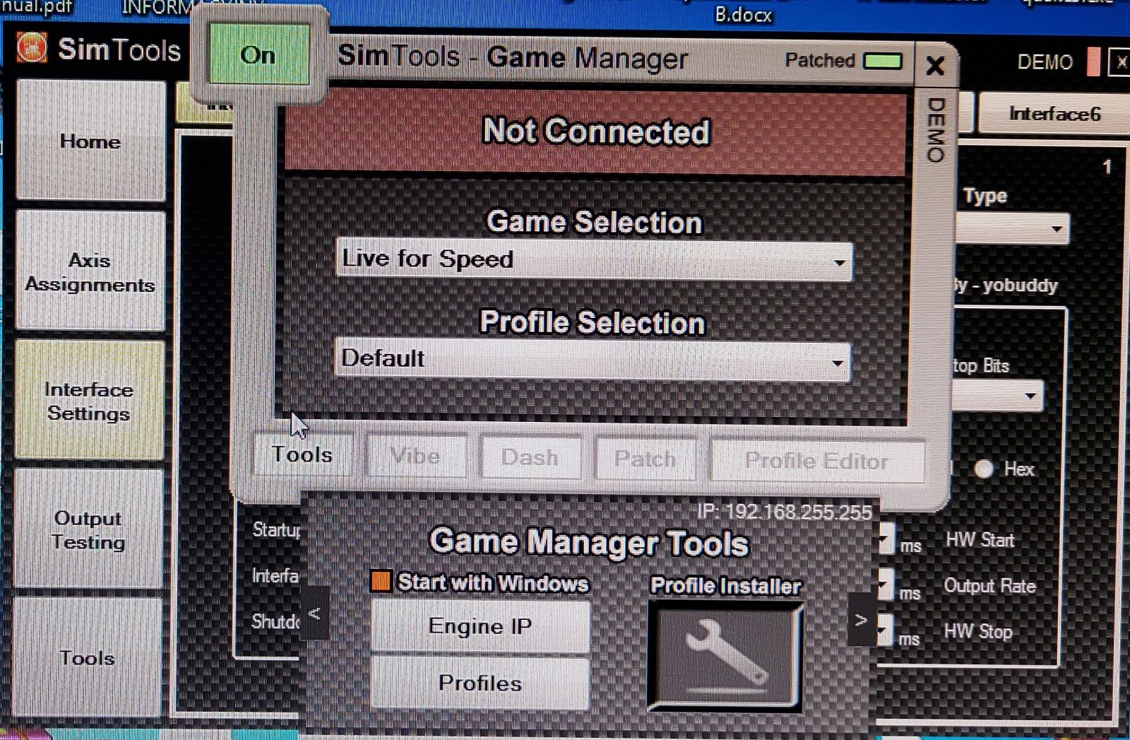

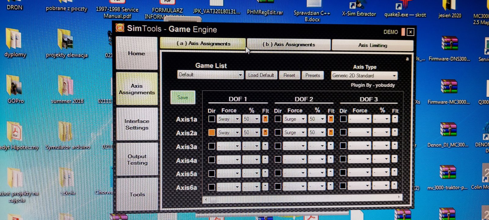

    For a 2DOF you can simplify your Interface Output - [A<Axis1a>][B<Axis2a>]
    Now the fun part begins, refining motion profiles. First up grab a copy of the SimTools manual and keep it handy for reference: https://www.xsimulator.net/community/faq/rtfm-start-with-the-official-simtools-documentation.117/
    Then see the Tuning Tips in the FAQs: https://www.xsimulator.net/community/faq/steps-to-create-a-motion-profile.228/

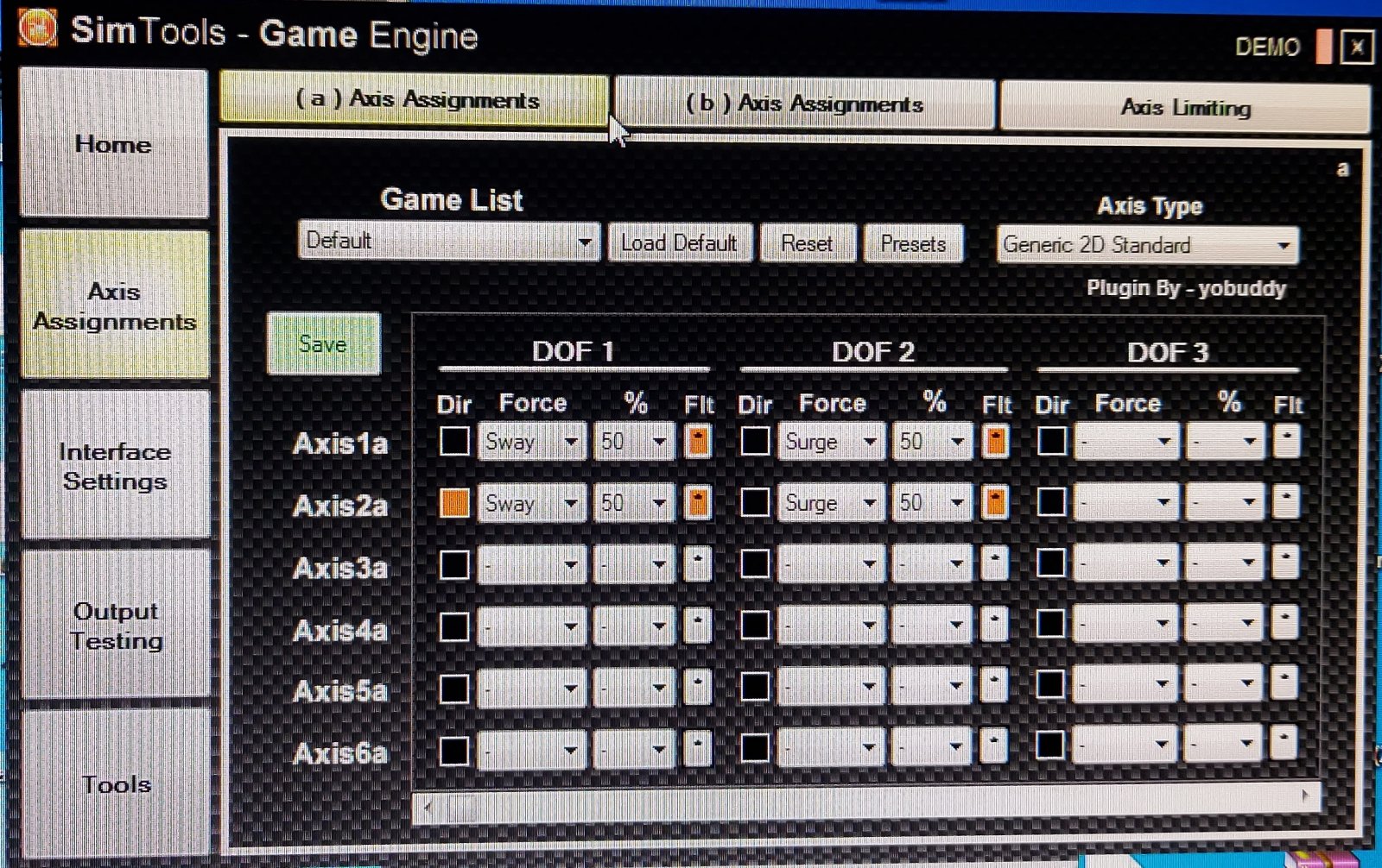

    Be mindful of the total axis allocation % total in Axis Assignments, even with a 2DOF you can include surge, sway, roll, pitch and heave: https://www.xsimulator.net/community/faq/axis-assignment-percentage-totals.120/
    Do make sure LFS is run before patching it for motion: https://www.xsimulator.net/communit...run-in-first-person-mode-before-patching.365/
    When you get the time it would be great to see a video of your rig in action.

    This is one of the first successful runs. At first I had problems with the setup. I still need to understand the advanced settings.
