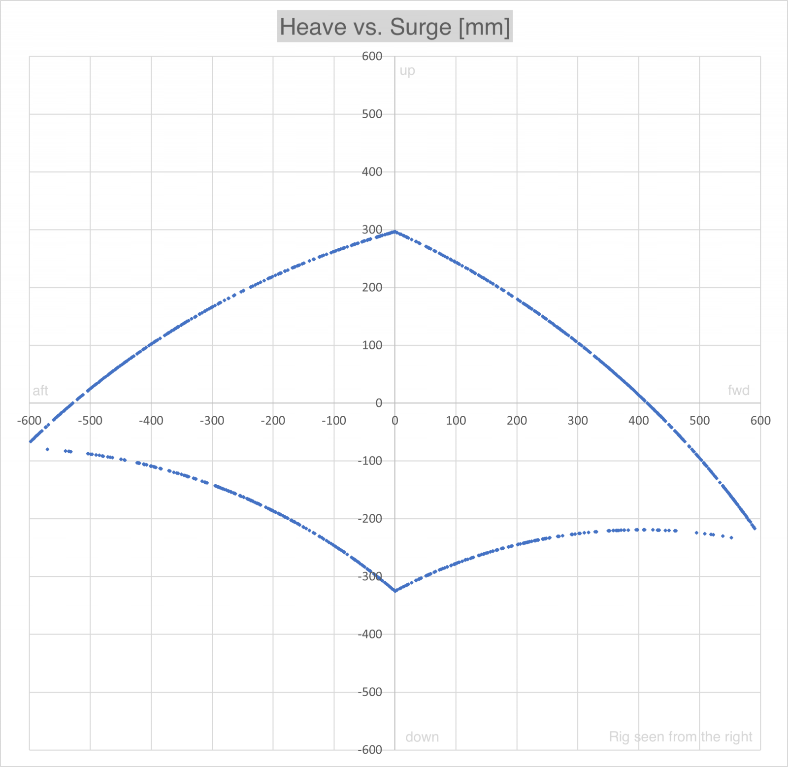

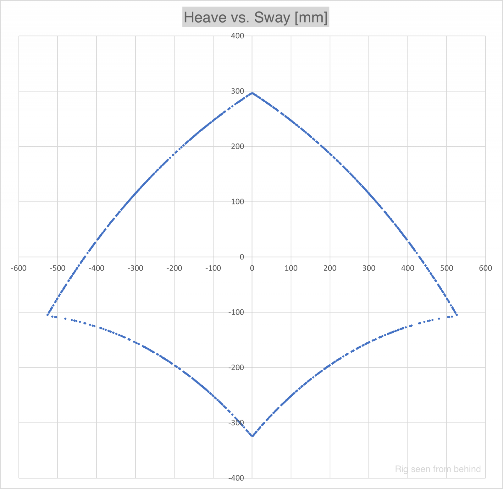

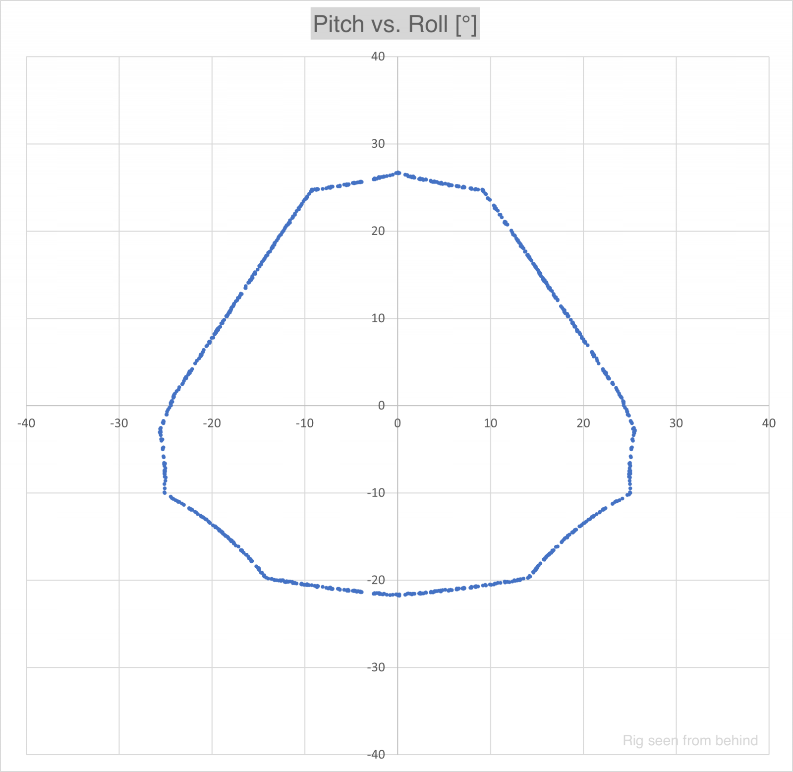

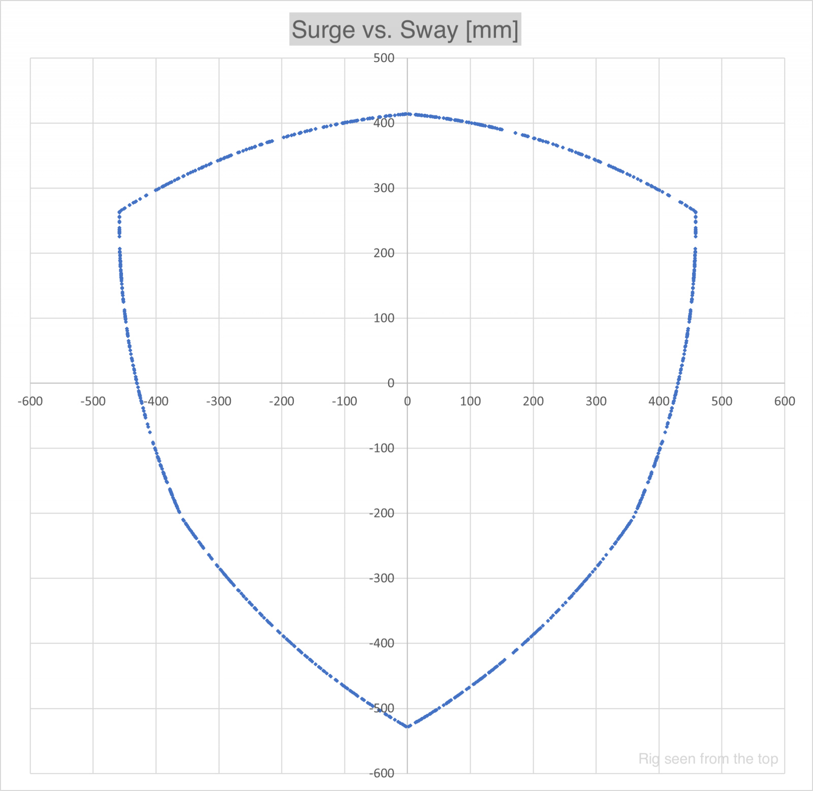

    I was able to spend a little more time on my software project lately and bring it forward quite a bit. As a sort of spin-off from the new motion engine I’m working on, I can now extract envelope plots from the rig.
    I thought I’d show some of them here:
    Heave vs. Surge.png Heave vs. Sway.png Pitch vs. Roll.png Surge vs. Sway.png
    As of now, I am still outputting the data into a .csv file that I hook up to an .xlsx file which then creates the plot. A bit cumbersome, and if anyone knows how to directly output .xlsx files or turn a raw point cloud into a plot on a .pdf, I’d be happy to get help with that!
    As soon as I have a user interface that people stand a fighting chance of understanding, I will publish the software as freeware. I don’t have a catchy name for it though,… I have been calling it the “Rig-O-Meter” or the “Rigalyzer” :) Let me know if you have a witty idea :)

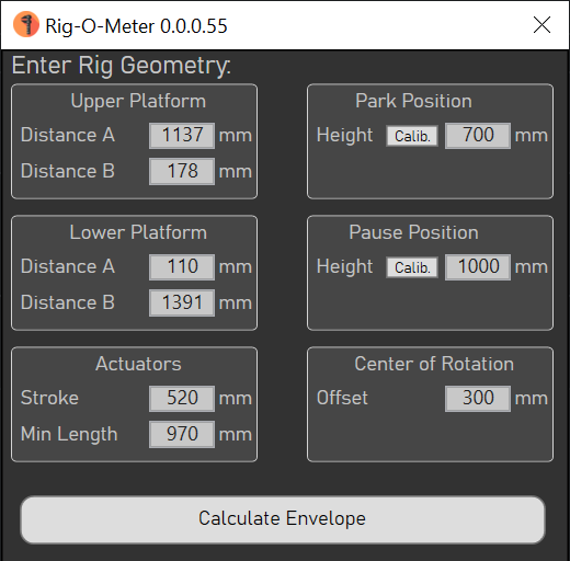

    The UI is rather simple:

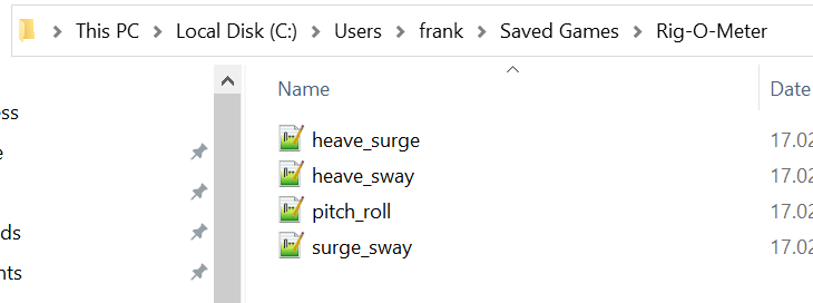

    Fill in the parameters that define your rig, click "Calculate Envelope" and it will put 4 .csv files in "Saved Games/Rig-O-Meter" :
    You can then open them in Excel to create an envelope plot. Use an x-y scatterplot for that!
    As of now, it only calulates 100 points on the envelope per plot and it takes a few seconds for them to calculate. I will increase that number to ~500 per plot soon.

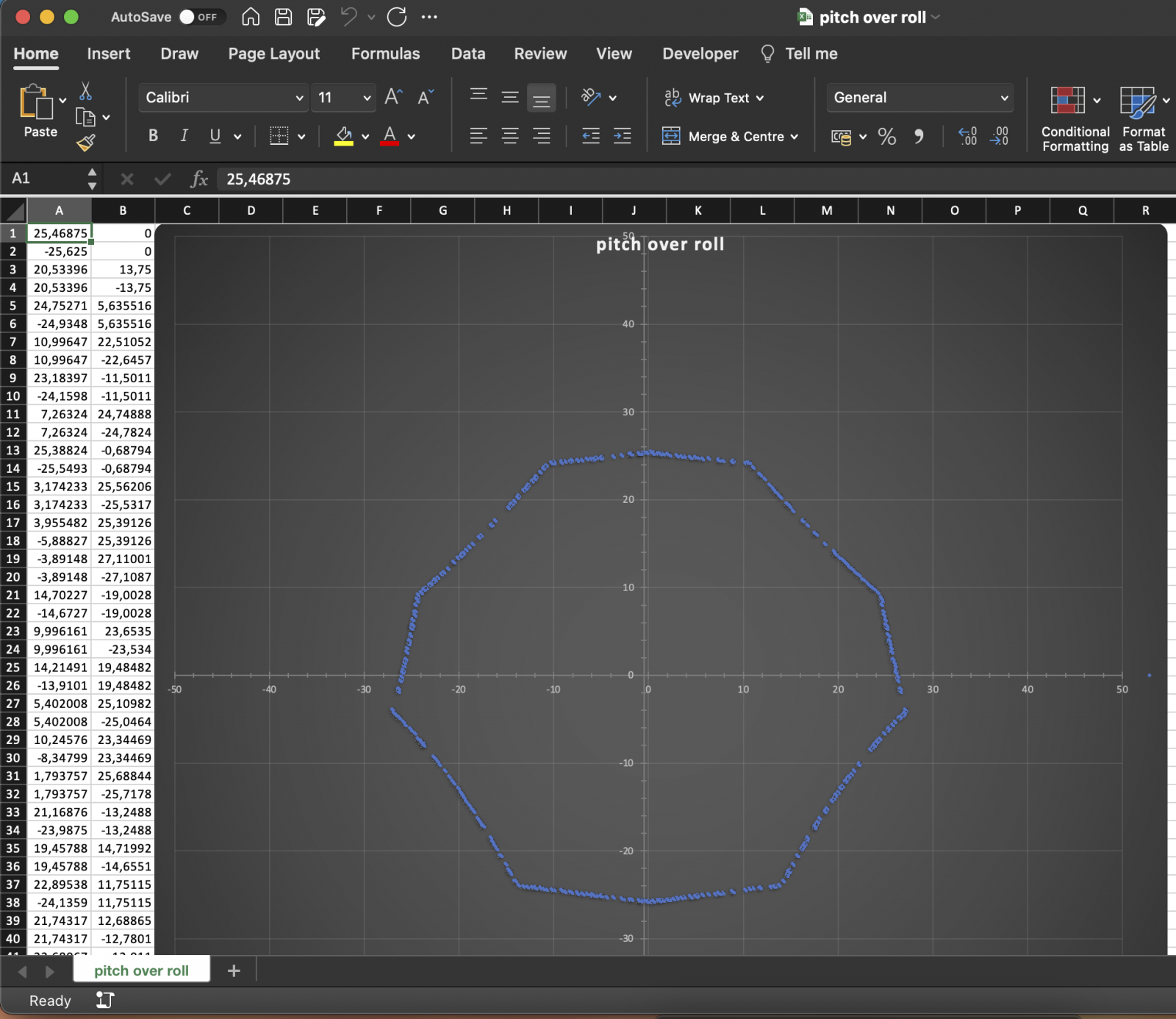

    I managed to output the data directly into a .xlsx file that contiains a chart already created for the user :) That should make it much more user friendly.
    Enjoy :thumbs

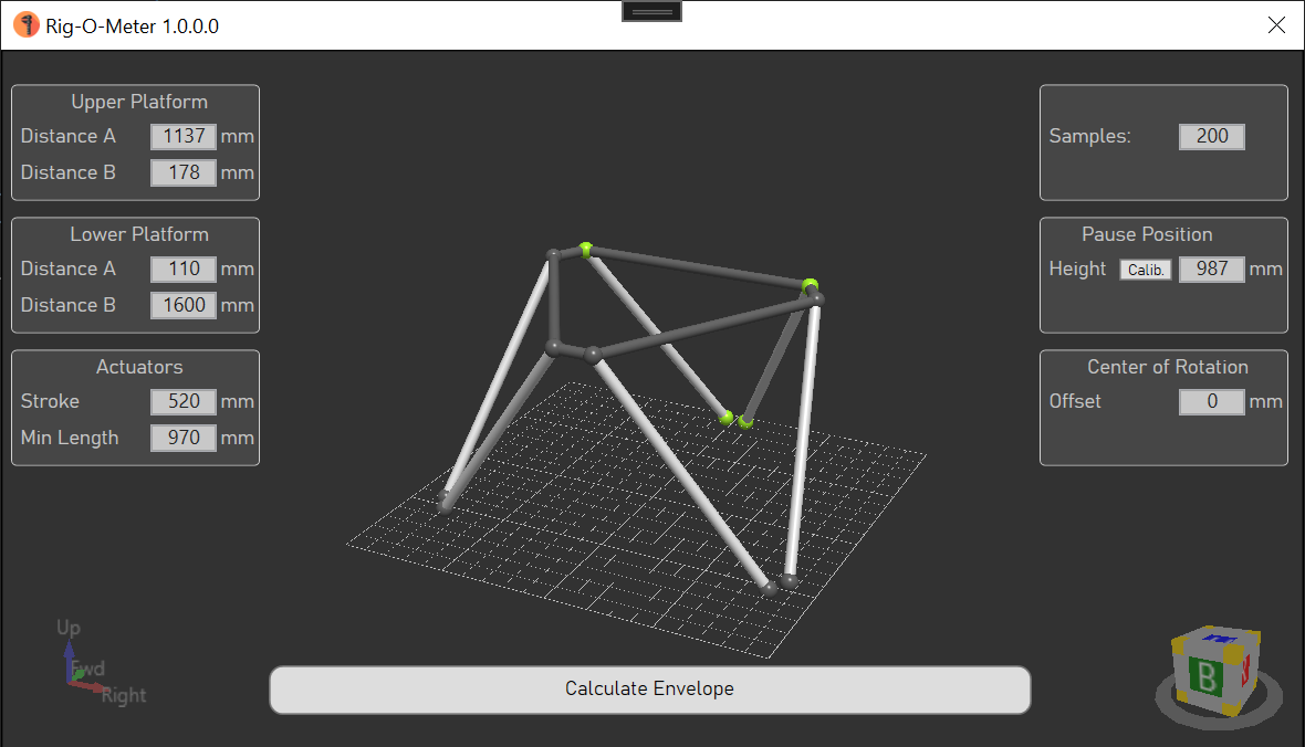

    It is just a design tool to help people decide on the dimensions of their rigs. I often heard people speculating whether a certain design choice would give them more or less of this or that DOF, myself included! Now you can enter the dimensions of your rig and the software will move it through it's full envelope to determine the limits.
    It should be noted that (for now) it can only determine a point on the envelope by the max/min extension of the actuators. Other potentially limiting factors like U-joint angles are not taken into account.
    Your U-jonits should anyways be designed in a way that they will never(!) limit the motion of the rig.
    Internal collisions (rig/actuator) or external collisions (rig/wall) can be modelled and I'm doing it already, but the user interface does not reflect that, because it is a hassle to implement.
    I have given it a graphical representation of the rig:
    The software will auto update to this version some time next week...
    Cheers,...
    Dirty :)
