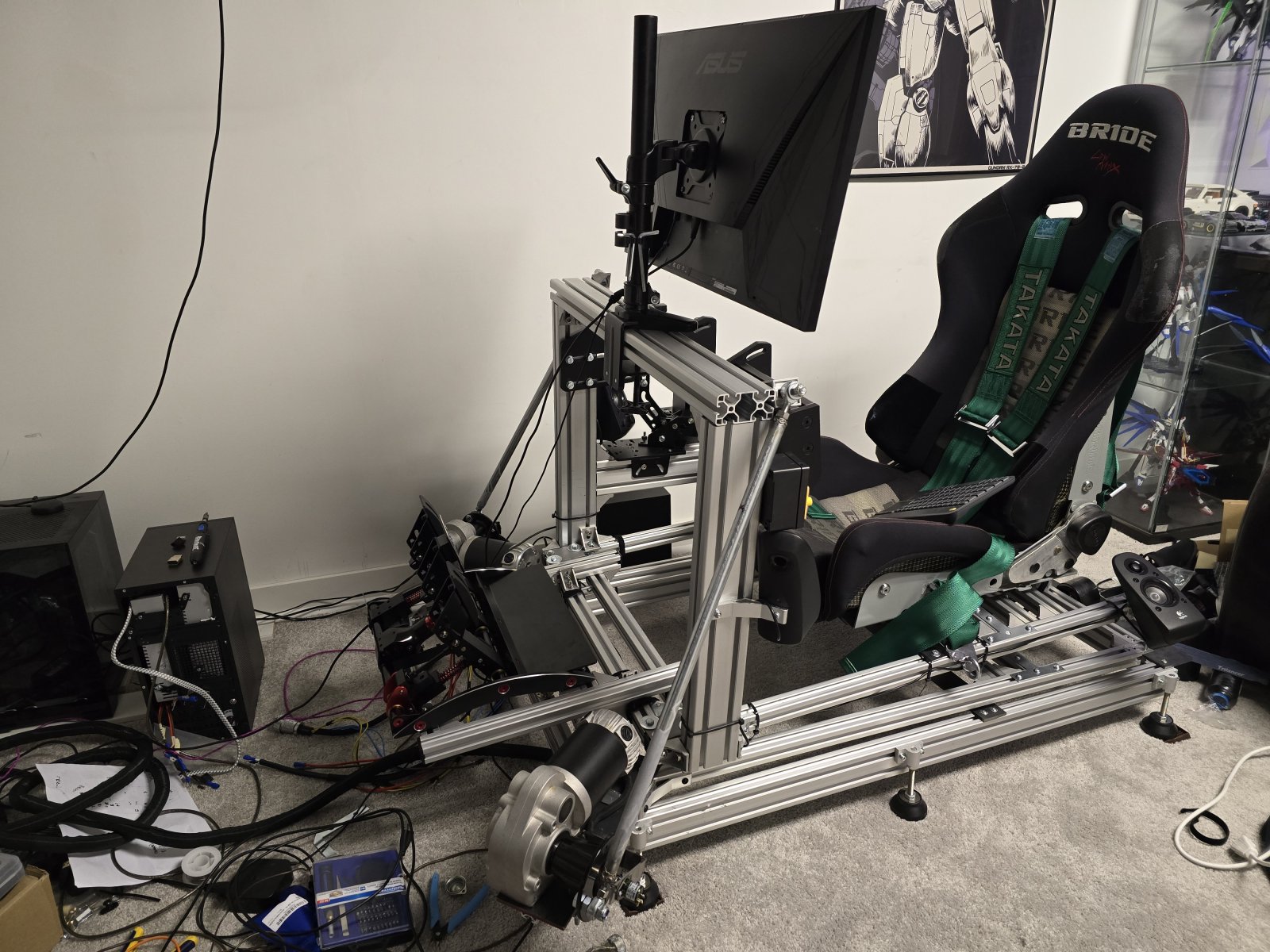

    First, I wanted to mention how this journey all started with by trying VR on Assetto Corsa for the first time. I was immediately hooked by the immersion. However, it felt like it was lacking something still. I looked into a motion simulator and discovered DOFReality. Looks like a great product but the price was out of my range. I put it off for a bit, and then one day I discovered Dave from D Max on Youtube. After watching Dave's videos over and over again, I felt inspired to try my hand at building my own. It is still a work in progress as I wait for some parts to arrive. However, the bulk of it is complete and configured in SMC3 Utility.
    Majority of the frame is made out of 30 series profiles excluding where the wheel base will be mounted. If I were to do this again, I would probably use 40 series for everything. Using 30 series resulted in my having to buy additional steel flats to strengthen the joints and to add some more rigidity.

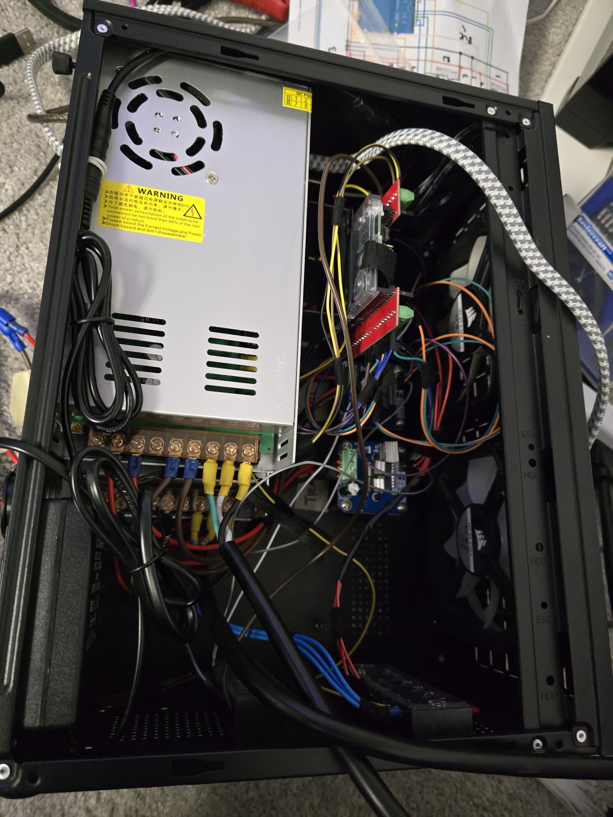

    Most parts were sourced on Amazon Canada and AliExpress. This rig is powered by H-Bridge controllers and wired up in that little tower case to the left of the pedal setup. I added 2 fans and a fan controller to help keep that case cool. I was able to fit everything in this tiny case. Don't worry, the wires on the right were tucked away from the fans. Also, I would recommend adding thermal paste on the heat sinks of the H-Bridge. I also added tiny heat sink fins with thermal pads on the chipsets.

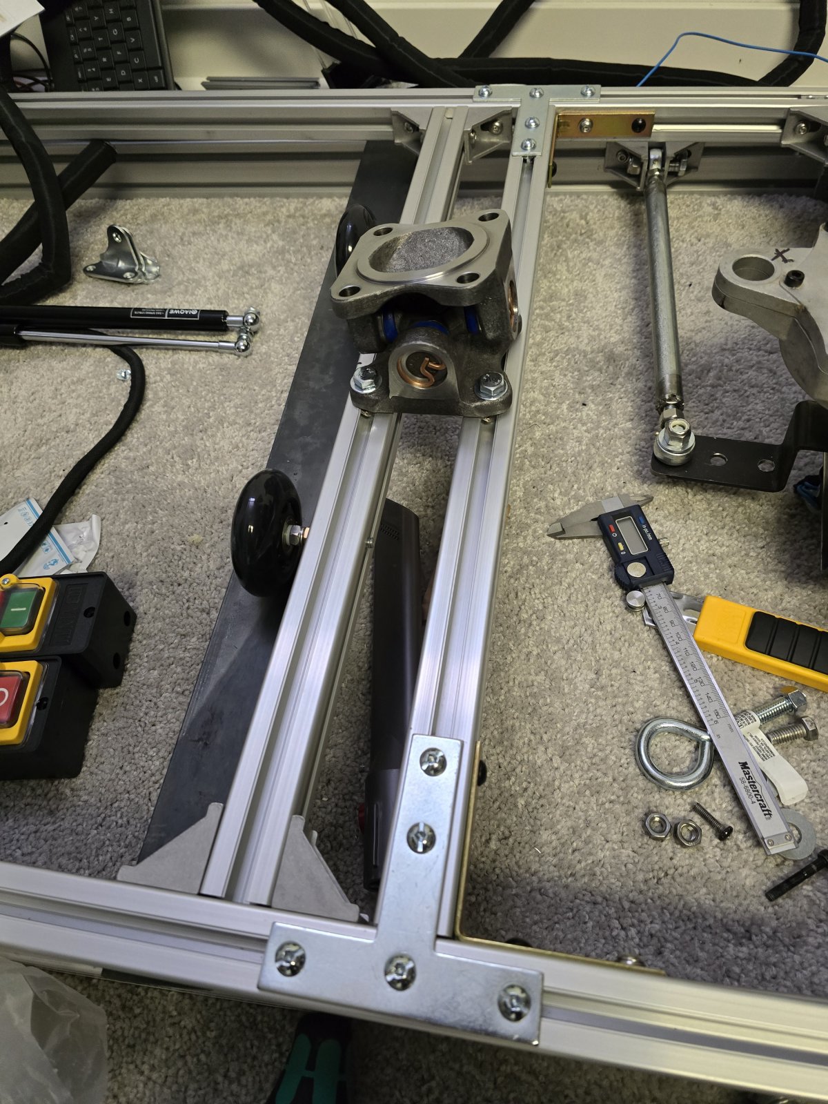

    Unable to get center of balance on U-Joint flange - Because of how close the seat sits by the traction loss motor, I was not able to get the center of balance on the flange. This will result in more load on the motors. One way I plan on alleviating the extra load is by adding some Hydraulic Support Rods near the front. They are about 15" long and have about 67lbs of pressure each. I plan on having one on each side. Stay tuned to see if it helps

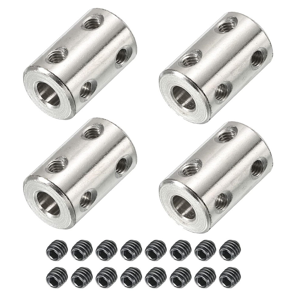

    Potentiometer to motor connection - I drilled and tapped the center of the motor and added a threaded rod. I tried various ways of attaching the pot to the motor such as a 3d printed coupler(could not get the set screws to hold its place, so it would always loosen), I tried to use a long hex nut and drilled my own holes into it; creating my own metal coupling. The best thing I found to work is just to buy the metal couplings with the correct Inner Diameter. On Amazon Canada, they are about $15.99 for a set of 4. Worth the headache lol

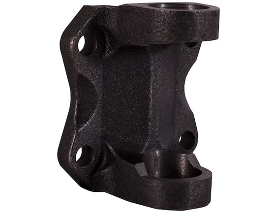

    The U Joint used
    The U-Joint was sourced separately. The flanges were ordered online from a local shop that ended up just ordering it from the states and taking over a month to get. Had I known, I would have ordered it from the states myself to cut the middleman out lol. The joint itself was from Amazon. I ended up pressing everything myself and mounting it with Graded M8 bolts.

    Cool build! I'm building in profile as well. Would love more pictures. I'm struggling to get scale. It looks like there is no clearance for the top frame to move.
