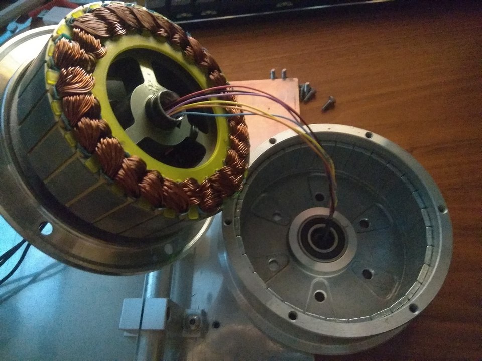

    I'm using an ODrive, hoverboard motor, EMC project Arduino control, with a custom encoder setup and hardware.
    I had to machine a new shaft for the motor to allow a central feedback shaft, and room for wiring which seems to work well. There is also an integrated slip ring to allow me up to 9 buttons on the wheel, TBD.

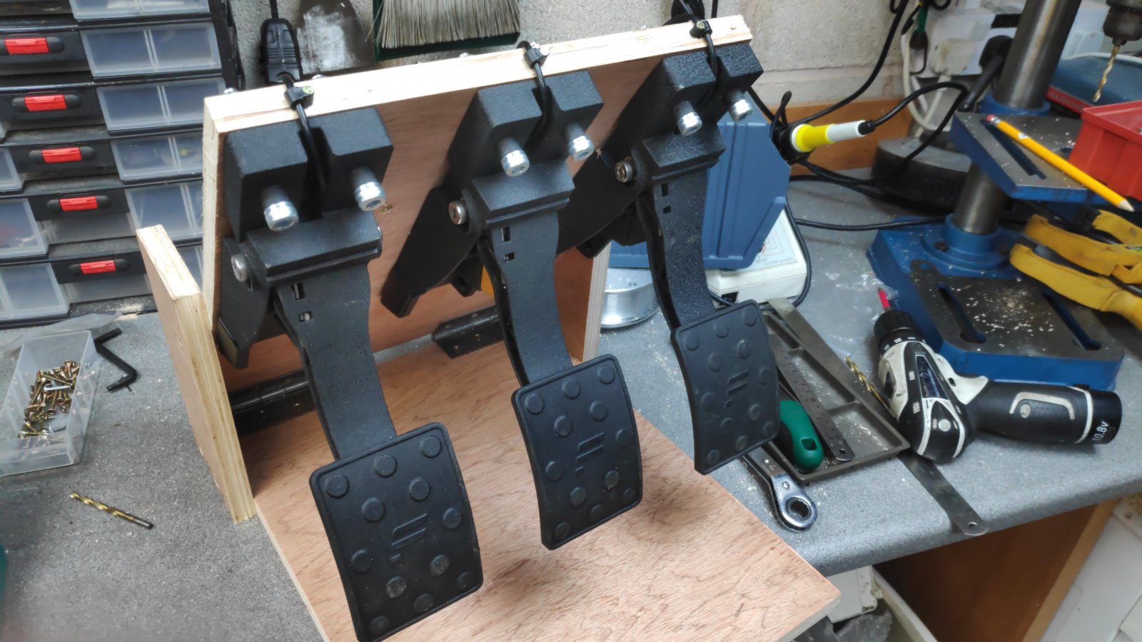

    Pedals are second hand fanatec ones from a local SIM racing center that is closing down. I made my own pedal box as a temporary measure until I've got my motion rig going.
    Looking at an Arduino based load cell brake next. And have fitted my office chair with locking casters to use as a racing seat too!

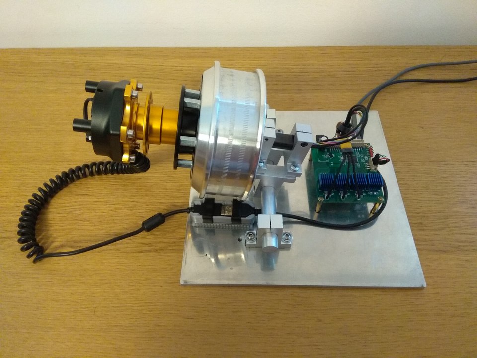

    You give me an idea with mounting on standard shaft holders and I made this :) With custom board so. It needs much less components to integrate.

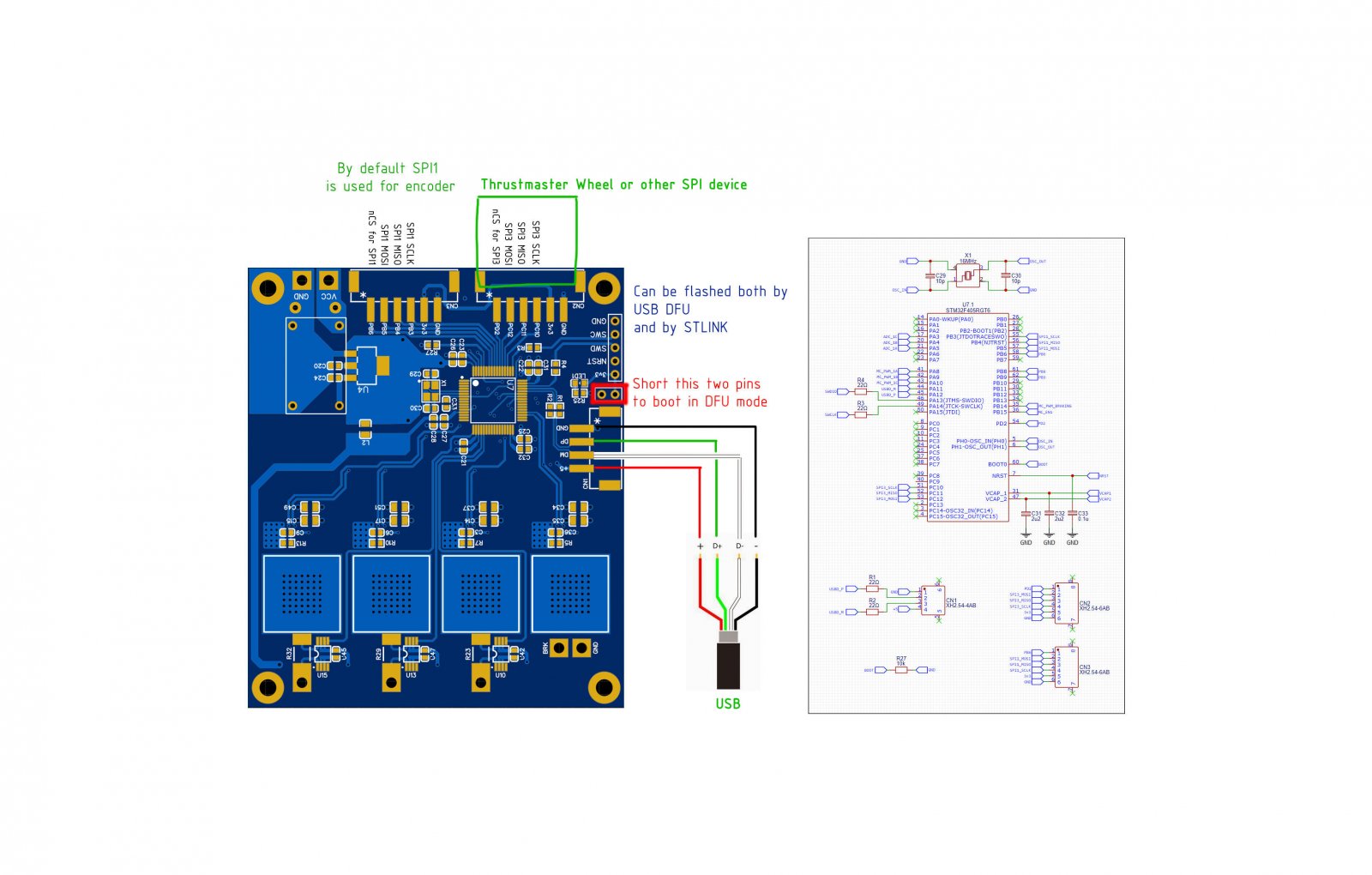

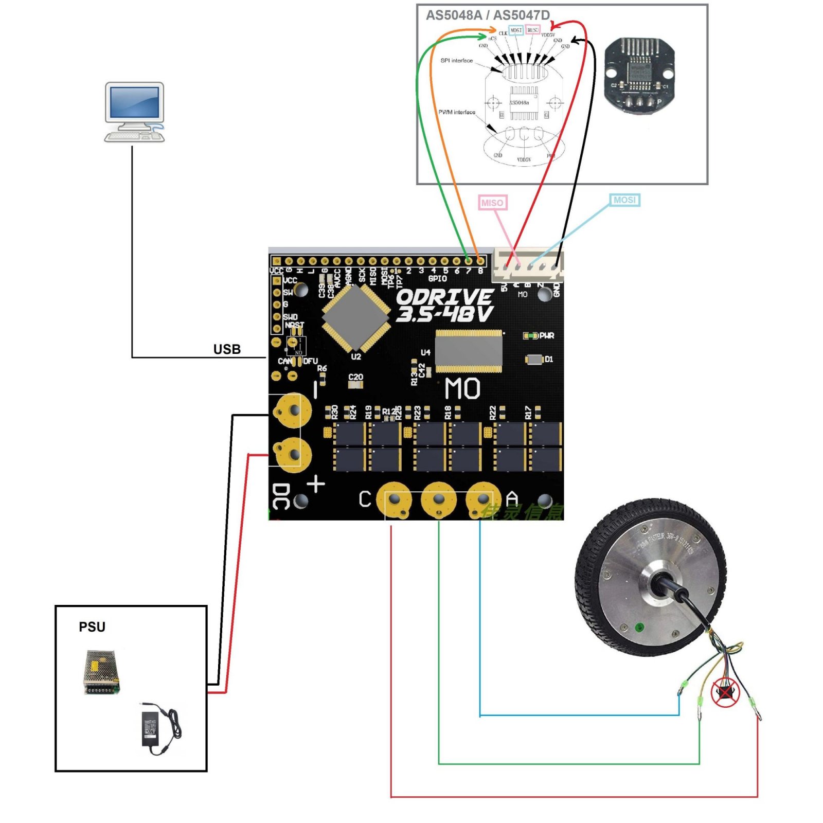

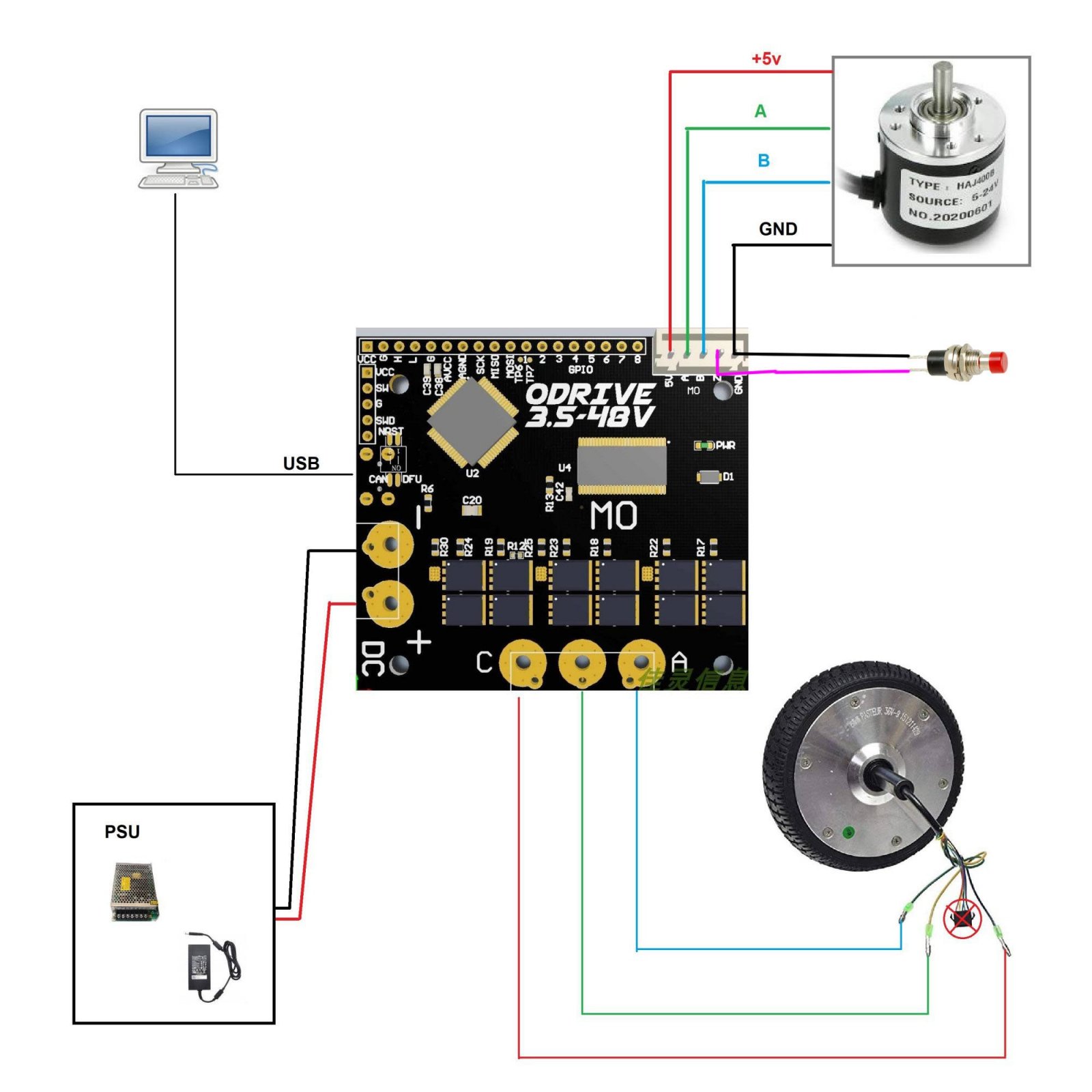

    Yes. It is brushless controller developed by me https://easyeda.com/olukelo/btn8982-three-phase-controller_copy_copy. I use custom firmware for it developed from zero. But ODrive can be used as well. I have developed version of firmware for it, both for use with incremental encoder and absolute SPI encoder. Here are compatible connection schemes:
    absolute.jpg.81b6265f52c97ce95539fe20b62e9e7a.jpg connection_scheme.jpg incremental.jpg.614067eed5ac52b21784be5c867f3bff.jpg.14b6976692a1d7bb4a91f8e7ff695aa4.jpg

    Yes. And not only single one:)
    Here is Wheel Check step log of first copy:
    Here is video of another instance done by one of my frieds:
    And he liked it so much that already built several copies for his friends:

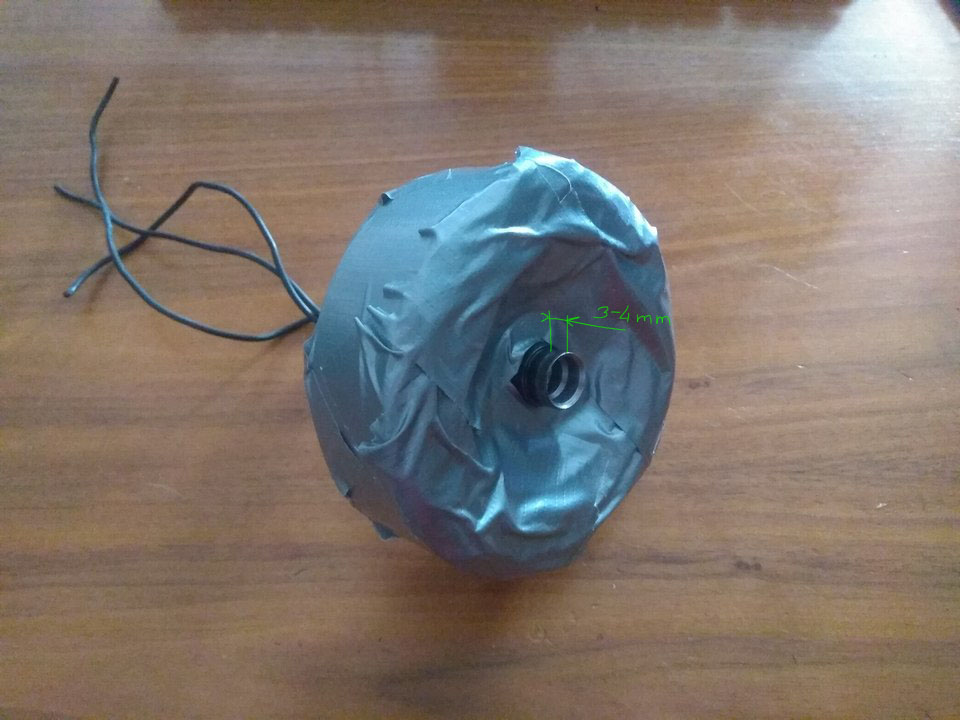

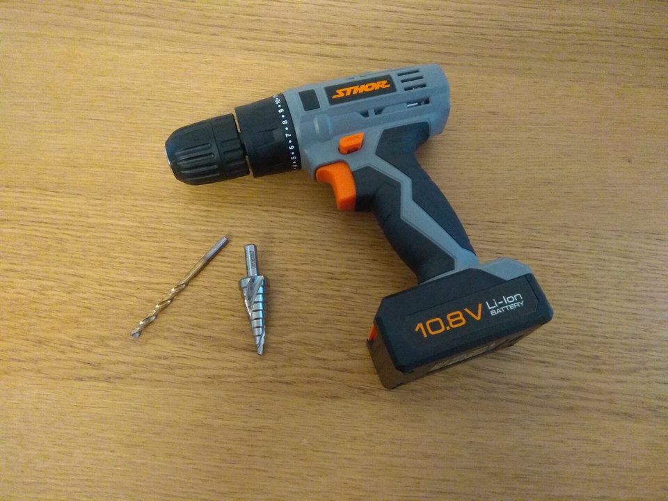

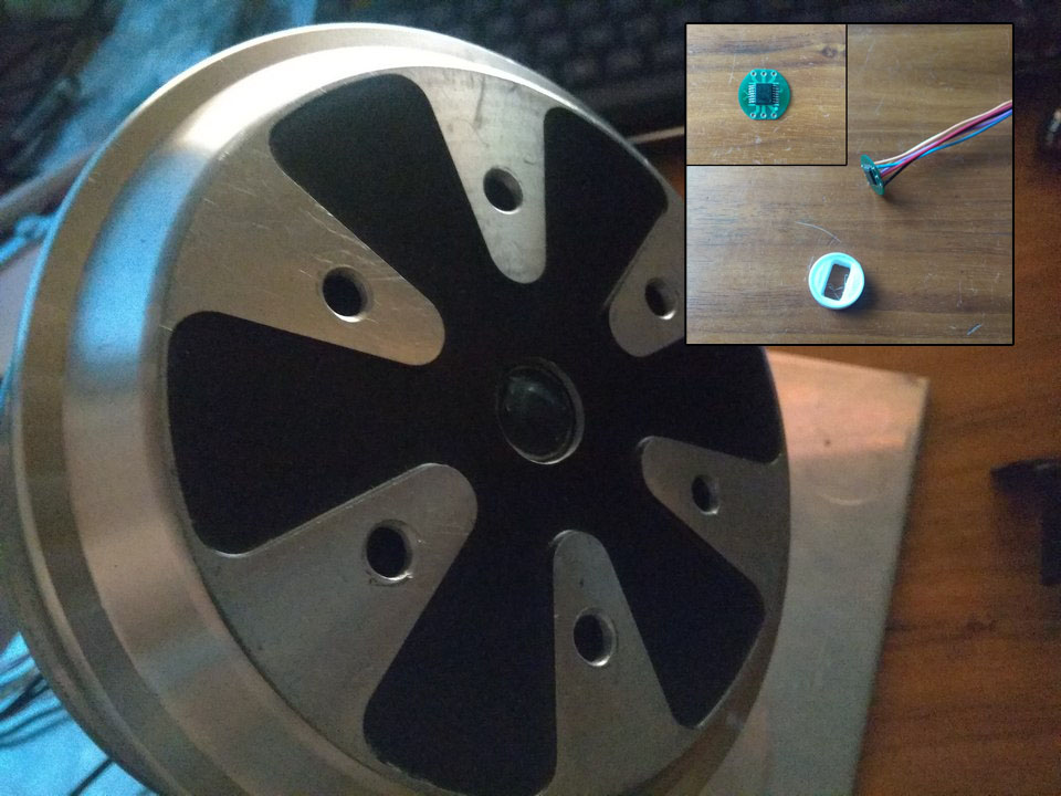

    We managed to place encoder inside the shaft. Magnet is fixed on mooving part. It is possible to drill the shaft with simple handheld tools. Encoder pcb is ordered on JLCPCB, cut to round shape and glued with epoxy to 3d printed part. Wires are passed through the hole in the shaft.
    IMG_20210716_194801.jpg IMG_20210708_181729.jpg IMG_20210711_203222.jpg IMG_20210711_203021.jpg
    Joystick is on my custom controller board. Originally I used ODrive as hardware with my custom firmware, but I did not manage to use two SPI encoders simultaneously, so I have fully working firmware for my custom board only at the moment.
