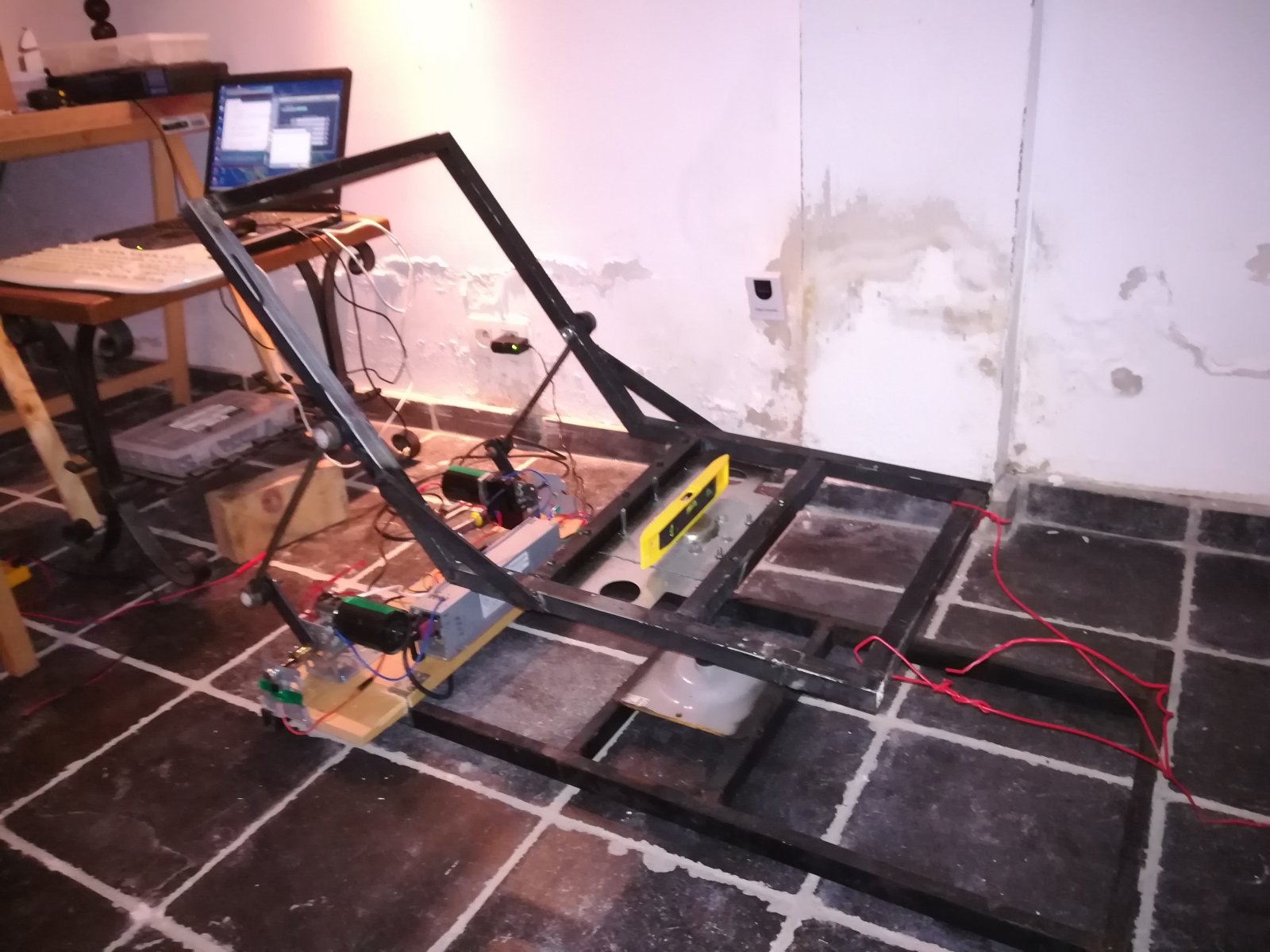

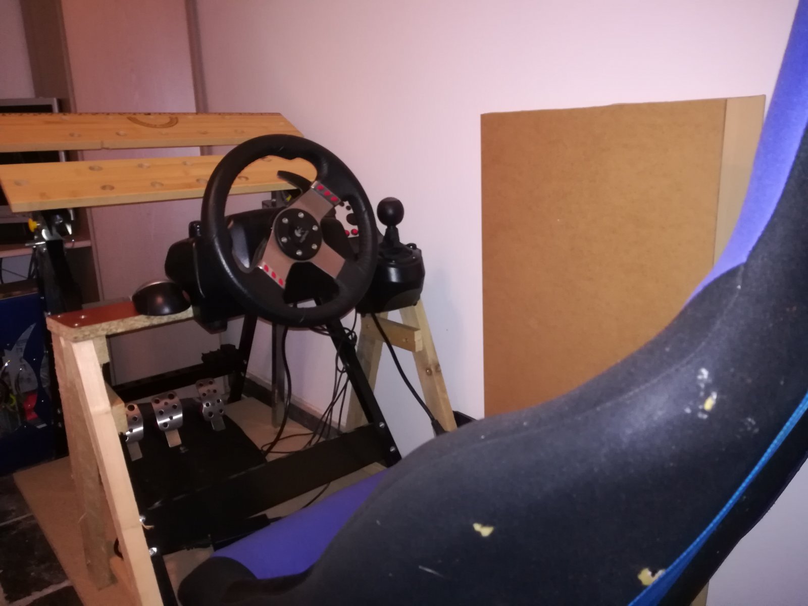

    Hi all,
    I enjoy to come back on this forum, after more than 2 years. The source of inspiration that you are is not dead! My motion simulator project get further! Big thanks to all of you for support, and more specific thanks to @RacingMat, from who my project is based. (http://www.x-sim.de/forum/viewtopic.php?f=37&t=943 )
    After strugling against severals issues (here find the solutions too ,) ):
    - structure components & assembly : visiting a car demolition will help you !
    - wipe motor insulation : see post "sparkfun moto monster only one direction"
    - communication issue with arduino : try to change cable. The one I used was for charging only...
    - motomonster pins welding : at least two motomonster are dead because of my poor welding capability. Train you on a PCB board ! or buy it all assembled
    - uncontrollable behavior of my simulator with Engine manager : try to shorten the loop time of the code. ex : remove the testpot() debugging function.
    My "fix" race station will soon be upgraded to mobile station ! see you soon.
    Some picts of the current status :
