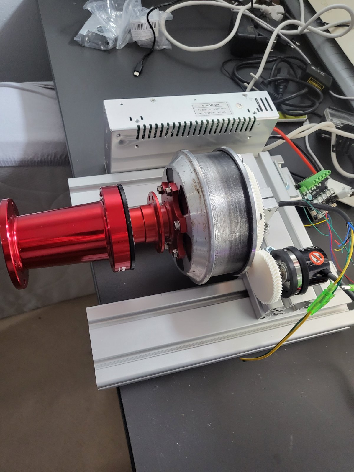

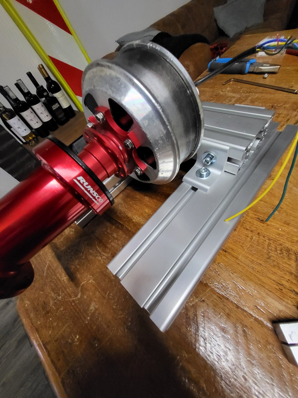

    After Finishing my 2-dof chair last year, this project interested me.
    So I started to collect my things, based on the solution of Roman Smoliakov.
    Bought a few Hoverboard motors, Odesc 4.2 and a e6b2-cwz6c Encoder.
    Also found this tutorial: https://diy-blog.org/2023/08/23/diy...ck-lenkrad-aus-einem-hoverboard-motor-teil-2/
    So first started to flash the Odesc with the FFBoard image... that was a very easy step...
    I had some issues testing my Encoder...but RTFM ;) .. As the A- and B signal was on another part of the cable as in the DIY blog description.
    So next steps...
    - Connect motor
    - Arduino flash to recognise my Thrustmaster wheels: https://www.noelmccullagh.com/
    - find a proper solution to connect it properly to my Rig(so I can also adjust it)..
    when all finished... I should have a
    - 2 DOF Rig
    - Loadcell
    - shaker engines(behind pedals)
    - DIY FFB Wheel

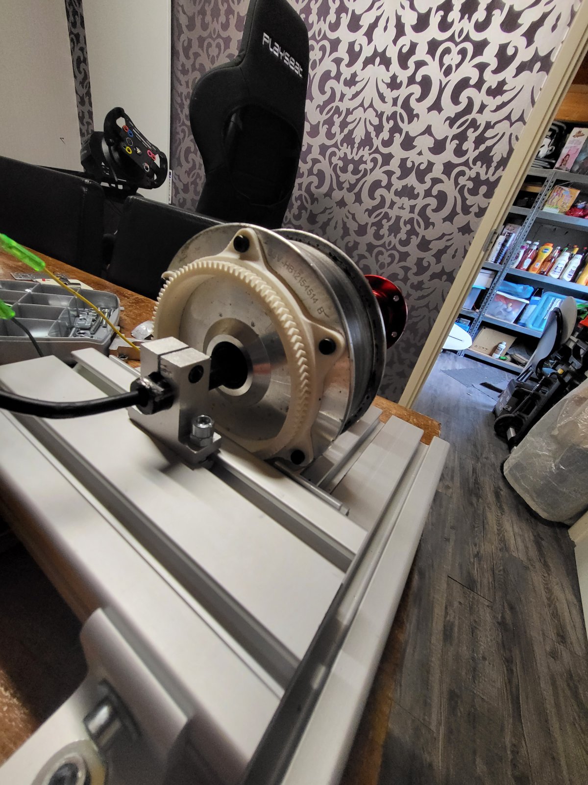

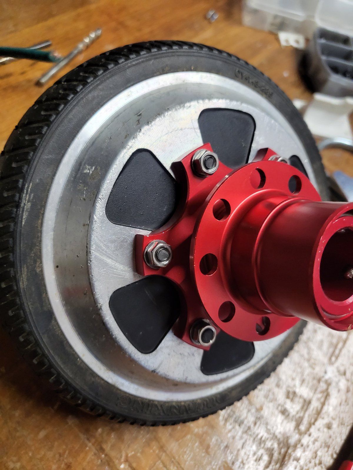

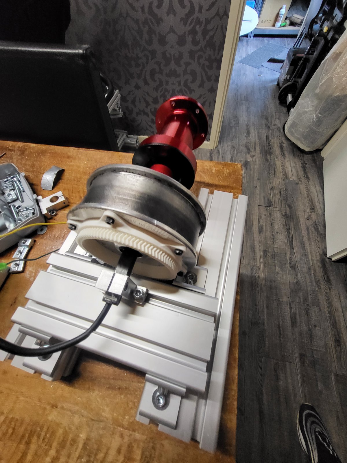

    Starting to become a wheel now....
    Next step....connecting :)

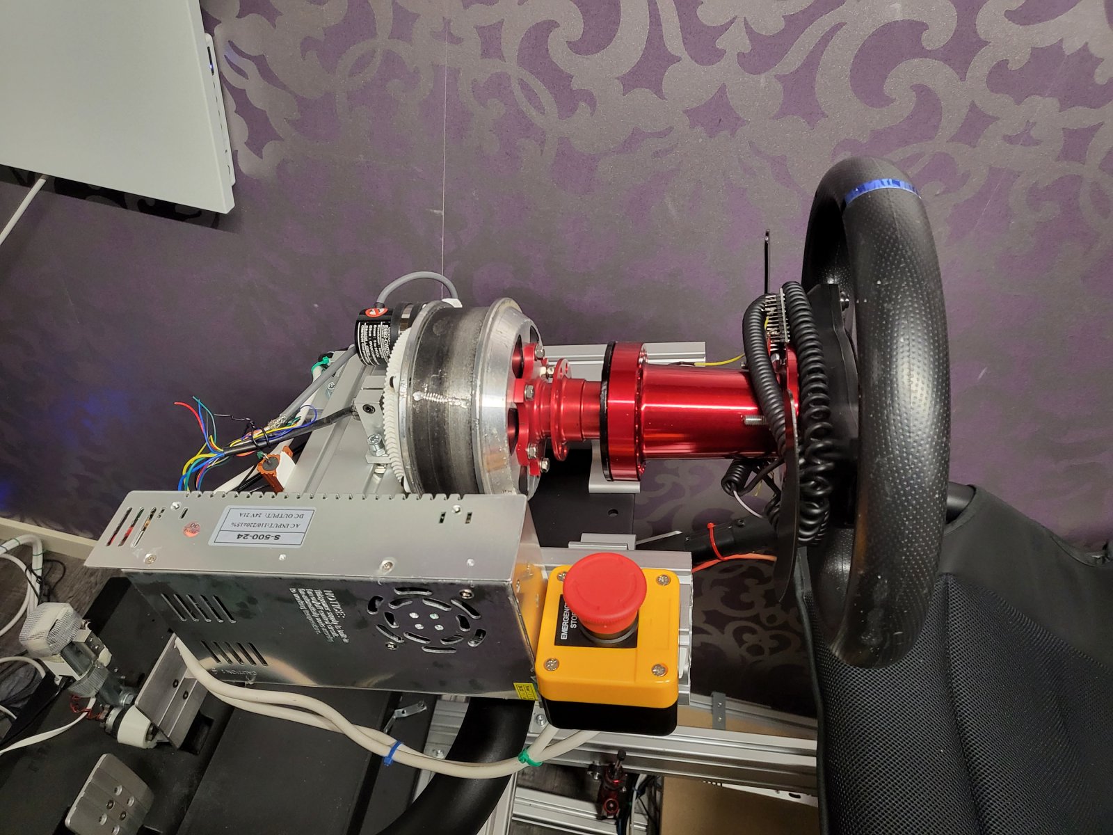

    Question... everything seems to work. But....
    One problem I have, is that when with no game, just on power...when I turn the wheel from left to right and let it loose it moves very aggressive to 1 side.and keeps spinning...what to do about this?
    thanx!!
    # solved..thanks to @SaltyEddy .... I made a mistake in the config...so in games it all worked ok, as the game can swap the force... but it was wrong in Windows...so instead of pushing to the middle...it pushed from the middle... :)

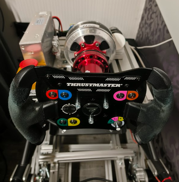

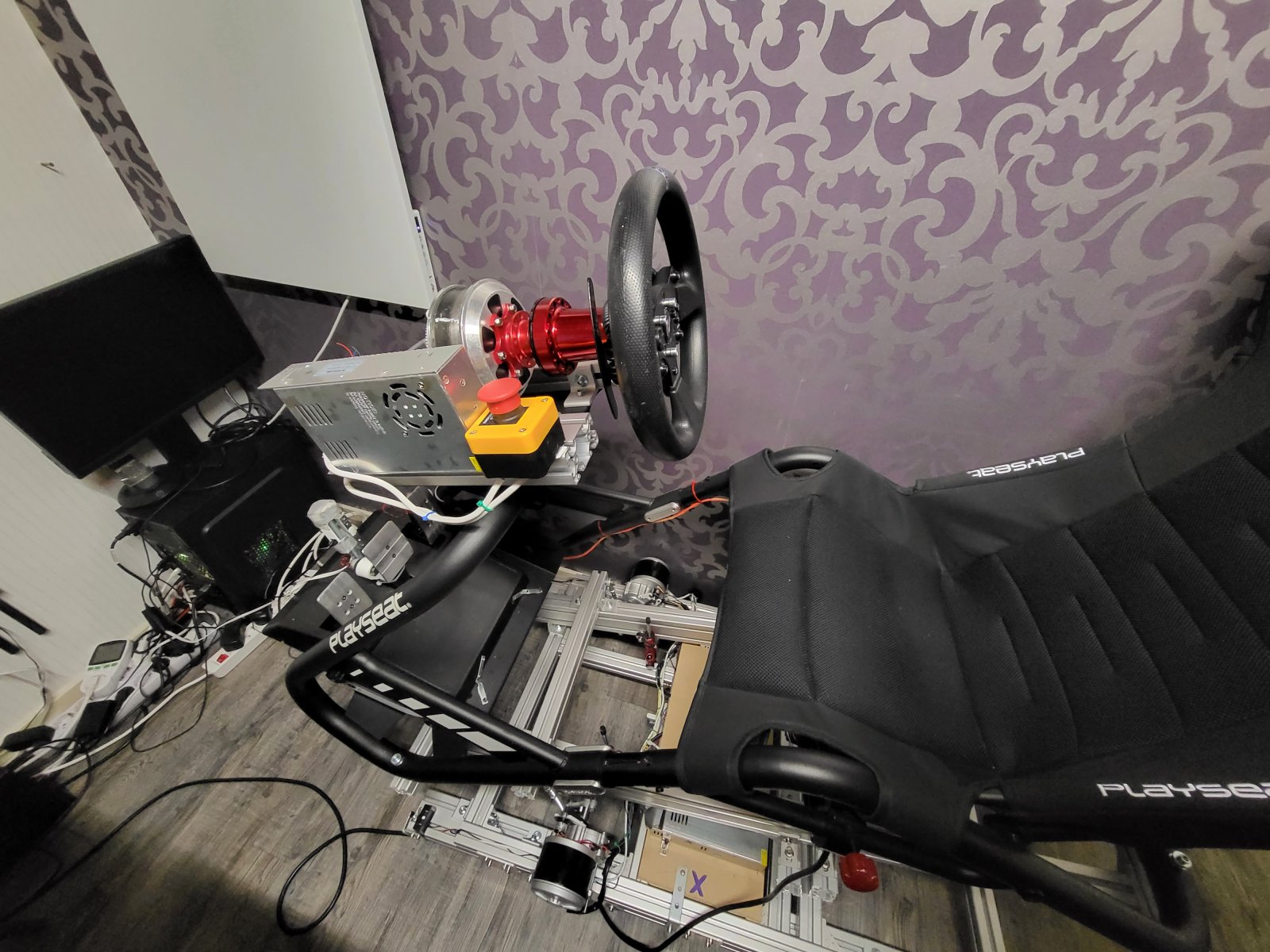

    It is on 95% now.... all working.... Thanks to the FFBeast discord channel and great assistance of @SaltyEddy ...
    The power and speed is enormous, I run it at approx 19v...with 30% power...tried it beyond 60%, but it is simply too strong :)
    Last things to do:
    - swap the steer to my F1 wheel,
    - game finetuning....
    - cablemanagement
    - sorting out a better solution of my Arduino(for the Buttons)... Checking out how I can make it wireless.
    So...thanks to Xsimulator forum I now have:
    - a fully working 2 dof chair
    - Working buttkicker
    - vibration motors behind pedals
    - DD wheel
    - Load cell
    What a great project :)

    The solution for me was to inverse the force direction....

    I bought a simple Ali 24v 15A 600w PSU.... enough power for it...
