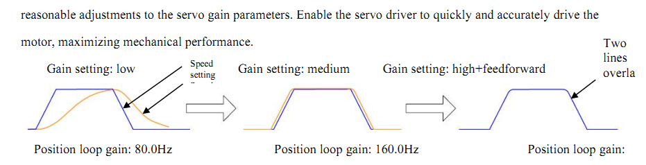

    But I have quite some experience of how to tune servo drives, mainly industrial servos for CNC machines, but the procedure is the same for sim rigs. The most important rule is to tune the innermost control loop first, that is, the one at the end of the chain of command and with the fastest response. If your motors have sloppy response the different feedback loops tend to fight against each other creating a chaotic result where it's hard to find out which parameter has to be adjusted in which direction.
    So before tuning filters in FlyPT Mover try to get the best possible response from the motors with a deterministic stimulus. Trapezoidal or triangle waves work best because opposing to sine waves they have sharp corners with sudden changes of acceleration.
    Generally, the default parameters of servo drives are chosen very conservatively by the manufacturer to avoid oscillations independent of the load connected to the motors (left picture). But this means that the motor follows the command only with much delay and position error. Try to increase the gain (velocity gain first if you have nested control loops) to get the best possible result without oscillations or overshoot. (second picture) Adding velocity feed forward decreases the following error further (right picture).
    Industrial servos like the AASD15 and similar ones usually have a bandwidth in the 100Hz to 1kHz range. And 750W per motor even with a 10 or 20mm pitch ball screw generates forces higher than what feels comfortable. So you surely have to add low pass or spike filters to avoid excess jerking.

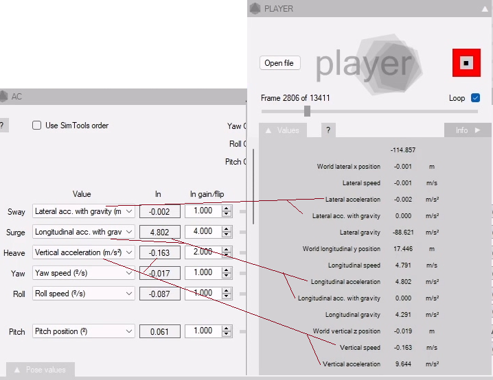

    I try to create a profile for RRE, using the online available profile for ACC.
    I merged it with another profile adapted to my Hexapod (Edge6D).
    So logically it should work, and it does, but without any gravity effects.
    Only positions of the car and the road.
    So I recorded a Racing Start in RRE with a right turn.
    And noticed the values OUT of the player do not match the values IN of the pose
    Why does Vertical speed go to Vertical acceleration
    Lateral acc. to Lateral acc. with gravity
    Long.acc. to Long.acc.with gravity

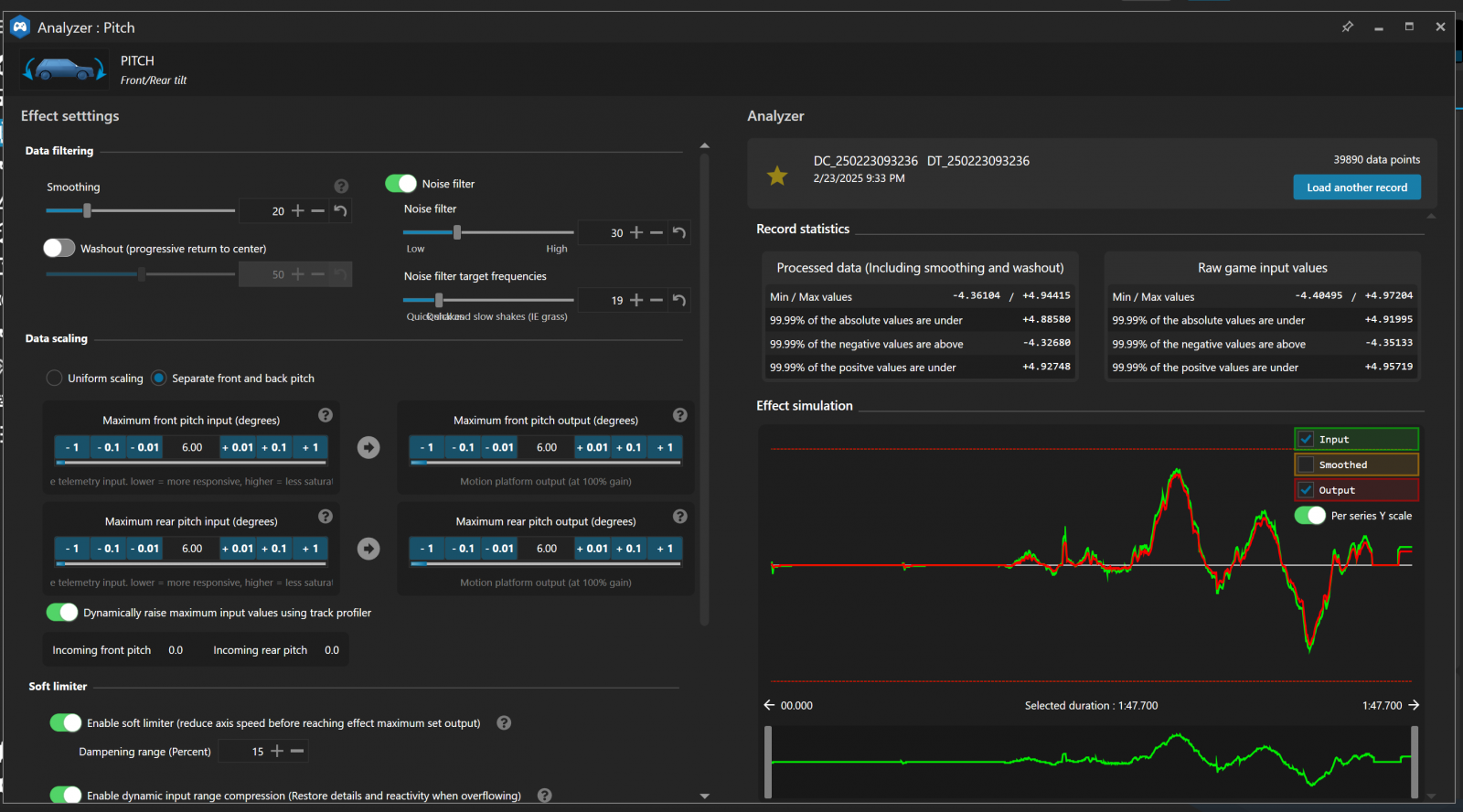

    Simhub has exactly what you want and it´s called Effect Tuner. 6DOF Support will published the next few weeks. Zrzut_ekranu_2025-03-13_092848.png
