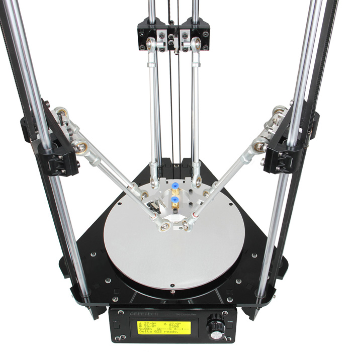

    Just to close the loop on this :)
    I ended up going down the kit route and built a Delta based printer, using the RepRap Marlin firmware. Took me ages to build the damn thing, but after some early head scratching with setting a level plane, I've managed to get some half decent prints out it!
    It's pretty much identical to this model:

    @Pit - I ended up going with the same brand (Geeetech) but I got their Delta printer, the G2S Pro.
    For me, the printer has been excellent, with a few cons I will point out shortly.
    Print quality overall has been excellent, and if you want to see things I have made with this printer check out my Thingiverse profile here: https://www.thingiverse.com/archie73/makes
    Pros:
    Great Delta setup with Dual Bowen extruders. Takes the weight off the print effector for some fast prints.
    Easy to build, I had mine built in a few hours - Config is more (see cons)
    All metal parts for the hotend and delta arms
    Arduino based board, so can take Marlin or Repetier firmware with ease.
    Really good quality prints (I only use PLA) for the price point. Budget printer for sure, but prints well.
    Heated Bed, with full control of Temp range via PID setup.
    Dual extruders - (also a con, see below)
    Cons:
    Dual extruders - Due to the budget nature of this and it being a Delta printer I am convinced the Dual one is pointless.
    You just can't get both heads level enough to get the dual part working. I ended up removing mine and had never looked back.
    I print with one extruder now, and simply change PLA via Gcode to get different colours.
    Need a lot of tinkering to get right. My heated bed is slightly concave so needs to be compensated by the firmware. Took me a while to get my head around it, but now I have I can tune it. Just don't expect to build and print. You will need to tune / tinker / pull hairs.
    Delta's a re quick to print, but also very quirky. Given my purchase again I would likely go for a moving bed model.
    Having said that, once setup correctly watching a Delta based printer 'print' is fascinating to watch and a little bit quieter than tray based ones.
    Build quality is random. I was lucky I got a good one from the suppliers, but I have heard many people say the extruders fail after a few hours, heater won't work, steppers are not precise. I was lucky, mine has be fine. YMMV.
