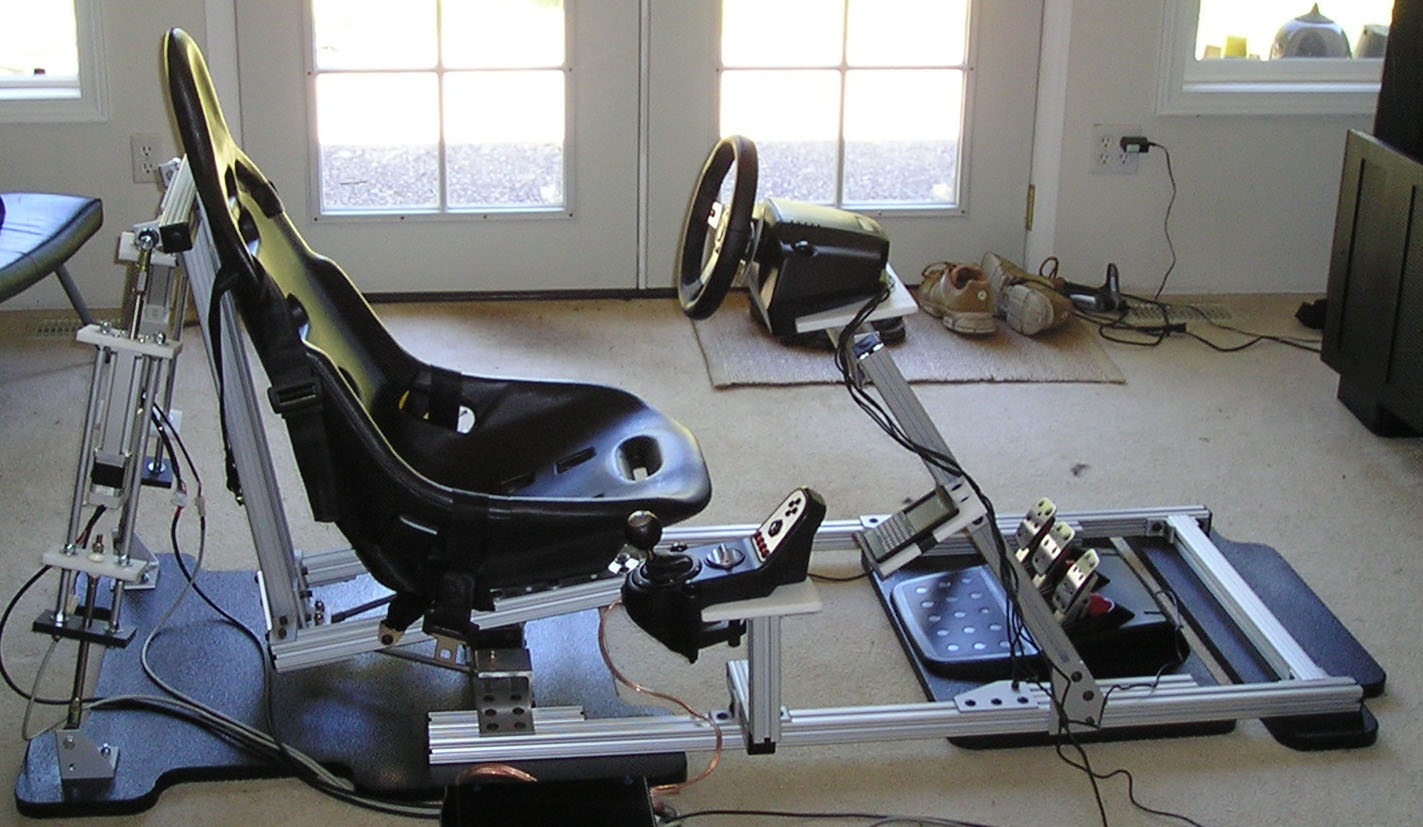

    3DOF, SCN5
    hello , I agree with yobuddy you regarding dampening , jumping rig etc.
    I had good results playing with the position of the universel joint and the angles of the actuactors.
    the rig is dampened with rubber feet and base. a perfect angle and perfect position of the pivot heps a lot reduce stress on the rods. reduce as much as possible torque on rods of the actuators. you need linearity as in pic from yobuddy. torque on rods translate in a significant stree on gears of the actuator.
    in that pic, the actuators are aligned with the axis of the 8020 with bracket . mine is built in a similar way.
    the squeak could be reduiced of about 50 per cent
    I tried to upload pics but I cant. sorry

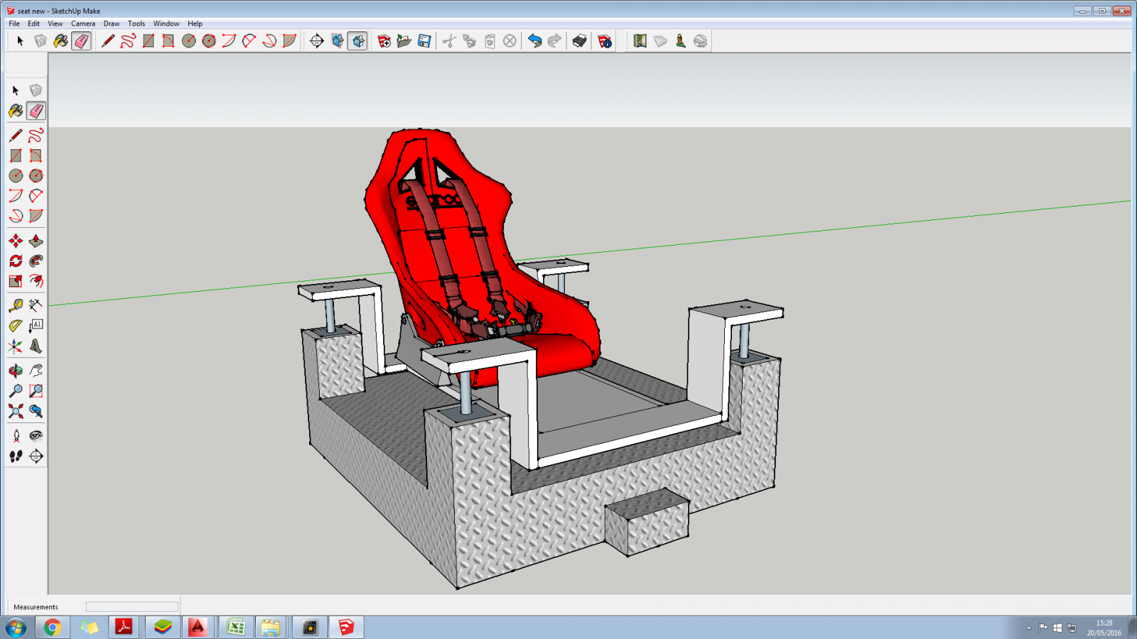

    SCN6, 4DOF
    My current rig is similar to a prosimu t1000 5dof. when i first set it up it was very noisy as i had a lot of movement on the actuators. They also got extremely hot. I have now changed them to short movements, and i personally prefer it. it feels a lot more snappy and faster. the actuators are a lot quieter and they don't even get warm. Short movements are more of a chirp, but long movements are the constant squeal.
    I am currently building a new rig so the actuators are upside down and then boxed in so i shouldn't get and noise at all.

  10. crammy
    Feb 23, 2016
    563
    Fabrication
    essex
    4,633Coins
    +326 / 2 / -0
    SCN6, 4DOF

    That's a really creative solution to the noise problem and extremely cool looking as well! It looks a bit like the captain's chair out a spaceship. It should look awesome once it's done.
