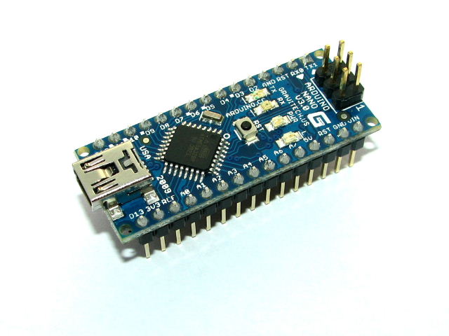

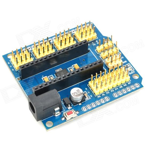

    Hi. Having seen Martin's (@Schluzu) thread - Ultraforce GS-4 DIY - Software, I am seriously interested in putting together a DIY version of the GS-4 seat, using a Kirkey seat. I've purchased a couple of Arduino Nano V3.0 boards together with two Multi-purpose Expansion Boards - see images.
    These are of course very cheap (thankfully) but with no documentation I'm at a loss as to know where to start. Any Nano manual that I find online is more like a brochure. Can anyone recommend a good starting point - so that I know to connect it up even would be a good start.

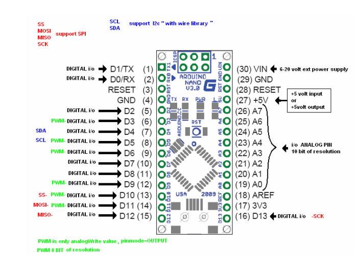

    Managing slowly to answer my own questions here so hopefully this will help other users. I've found a couple of good pinout diagrams for the Nano, see below. Nothing on the Expansion Board but this is pretty much self explanatory now that I have the info on the Nano. G V and S on the connector strips refer to Gnd, +Ve and Signal (helped when coming across a very similar board that used black, red and green base strips - good thinking whoever designed that I thought).
    Making progress. Need to get hold of a couple of servo's now I think and start getting to grips with the next stage, the code :)

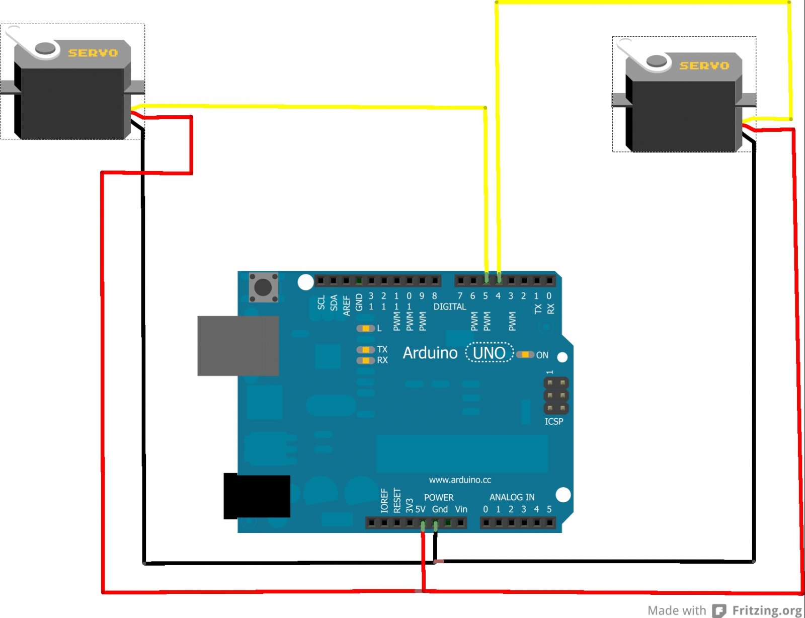

    Ok I connect the servos directly to my Uno , same with the nano, if the servos requires more power than the nano/uno can provide then you need to connect the power and gnd from each servo to an external power supply and feed the signal wire directly from a pin from the Ard.
    From code you can set the pins for where the servos are located, as in its changeable.
    No expansion card is needed, but if you wish to use it then I will look into it, can you do a simple wiring sketch in MsPaint. Will help.
    And we can change the code to suit what you want and you can release it as your modified code to run a G-Seat, the code is provided free to mod change and reclaim.

    Hi. Thanks for the help eaorobbie. I'm sure I'll need more but things are coming together slowly. I bought the expansion boards mainly because they were so cheap and and provide an easy way to mount the Nano and connect to it. Knowing where the servo's would connect to the Nano makes it easy to see where they would connect on the Expansion board so that's Ok.
