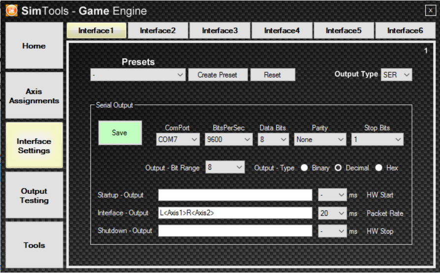

    No problem, this is what I used for the interface settings:
    And @eaorobbie's wiring:

    @noorbeast I did "Please install the RC Model Test_InterfaceConfig.cfg to Game Engine - Tools - Preset Validator." but this next step is not working as nothign is showing up in the interface "After that the preset can be selected in the Interface Preset box and you just need to specify the Comport Number of the Ard and then Test the Output will work correctly."

    When uoloading @eaorobbie's code onto the arduino I am gettign foloowing errors
    Arduino: 1.6.8 Hourly Build 2016/02/19 10:33 (Windows 7), Board: "Arduino/Genuino Uno"
    Sketch uses 3,902 bytes (12%) of program storage space. Maximum is 32,256 bytes.
    Global variables use 248 bytes (12%) of dynamic memory, leaving 1,800 bytes for local variables. Maximum is 2,048 bytes.
    avrdude: stk500_recv(): programmer is not responding
    avrdude: stk500_getsync() attempt 1 of 10: not in sync: resp=0x2d
    avrdude: stk500_getsync() attempt 2 of 10: not in sync: resp=0x2d
    avrdude: stk500_getsync() attempt 3 of 10: not in sync: resp=0x2d
    avrdude: stk500_getsync() attempt 4 of 10: not in sync: resp=0x2d
    avrdude: stk500_getsync() attempt 5 of 10: not in sync: resp=0x2d
    avrdude: stk500_getsync() attempt 6 of 10: not in sync: resp=0x2d
    avrdude: stk500_getsync() attempt 7 of 10: not in sync: resp=0x2d
    avrdude: stk500_getsync() attempt 8 of 10: not in sync: resp=0x2d
    avrdude: stk500_getsync() attempt 9 of 10: not in sync: resp=0x2d
    avrdude: stk500_getsync() attempt 10 of 10: not in sync: resp=0x2d
    Problem uploading to board. See http://www.arduino.cc/en/Guide/Troubleshooting#upload for suggestions.
    This report would have more information with
    "Show verbose output during compilation"
    option enabled in File -> Preferences.
    21,149
    148,590Coins
    +10,907 / 54 / -2
    Do you have the correct board set on Tools -> Board of the Arduino IDE?
    I have attached the sketch I am using, if I recall I think I fixed a closing tag in it somewhere.
    I did not use the preset, I just set up the Interface as per the earlier picture, then the Axis Allocations as I normally would. I did use a fair bit of axis limiting while I was testing the servos, as I have not built a platform for them yet.

    Also @BondeX when using @eaorobbie s code ,make sure you have // in front of #define DEBUG ,,,,,like this //#define DEBUG ,,,
    That had me bamboozled for a bit,,

    Thanks @stevemontuno and @noorbeast, I got that code working and it actually works really well. Tried AC and while there is movement, there is not a lot of movement unless I drive off road. Will post a video showing what I mean.
