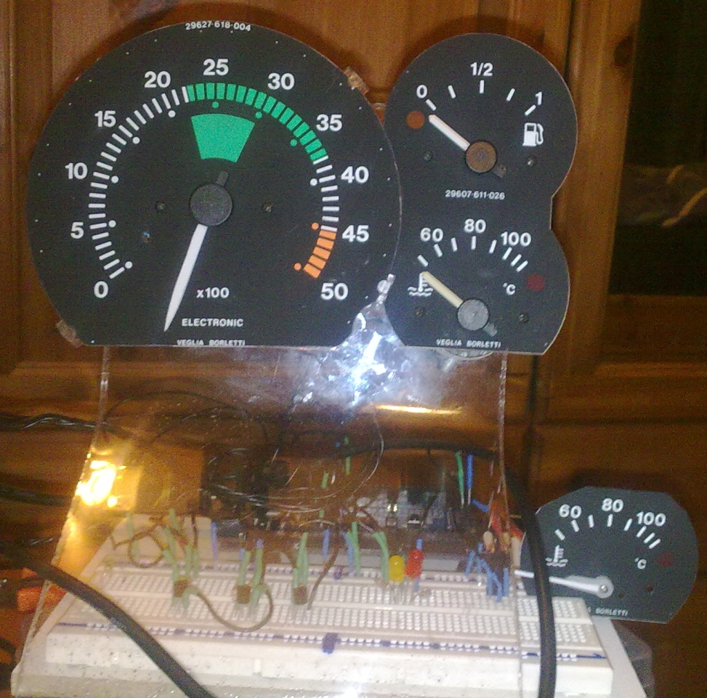

    okay, i'm really getting somewhere now,
    i've modified the script Dan very kindly pointed me to, and i've got all 3 of my air-core gauges working, one of them must be a bit dammaged as it's jerky and the coils are pretty noisey, the other is nice and smoooooth, but the coils sing a bit too, but i know that's due to the abrupt pwm signal they are being fed,
    these gauges have been sat in the bottom of my toolbox for about 5 years.
    The rpm gauge is moving beautifully, but then it does have it's own board for interpreting the signal and running the air-core.
    Now, i'm not being ungratefull here or owt, but it was mentioned this script can be done a lot simpler, any pointers to how to do that??
    i am not sure i need the high speed data transfer, but if it dosent use many resources then it's fine (i will eventually be driving 2 x frequency controlled gauges, 3 x pwm driven gauges and 4 x servo gauges, plus a fair few led's for idiot lights on the dash)
    and also the error checking, is that needed? for a motion platform it's a good idea, but for my use the worst that will happen with a bad packet is the needle points to the wrong value :)
    i tried to make it run 4 gauges, 1 servo and 3 air cores, but it wouldent have it, i imagine that's due to the error check feature?
    And the high bit rate, is that needed? as i believe the arduino is an 8 bit devise, so it cant give me any more resolution on the gauges, just thinking 0-255 numbers would be easier to work with... i think,
    i dont even know what the omsi simulator outputs yet, that's my nest step, but i've moved so far in the past few hours it's still catching me up.

  15. gazz
    gazz Member
    Feb 16, 2012
    35
    Scarborough
    105Coins
    It's an actual rev counter, from an iveco turbo daily, originally fed from a hall effect sensor in the bellhousing to pick up the magnet in the flywheel as it whizzed past (diesel engined vehicle, so no ignition pulse to read from)
    the gauges by the side of it mounted on the same plastic holder are from the same vehicle,
    all 3 are air-core gauges,
    fuel and water gauges use 3 pins (so 2 coil ends are common to one of the pins), and there's a resistor between the + and signal pins, other pin is earth.
    The rev counter uses 4 pins (so separated + and - sine and co-sine coils) but it has a circuitboard that counts the pulses and takes care of feeding the relevant coils and polarity of them.. so no glitches as the needle passes between coils) PCB has 3 inputs, + 12v, earth and pulsed input.
    same way as an electronic speedometer works, and i hope a tachograph works, as that's what i want to work on next.
    The 4th gauge in the photo is the face from another spare gauge that had a bent shaft, so i just glued a servo on the back of the face (and got some super glue down the shaft... part of the reason for it's jerkyness i keep moaning about) then i made a needle with some scrap plastic shaved to a kind of needle shape, glues to the servo arm, this gauge pod is just a quick mockup for testing with,
    Once i get the code sorted, i will be getting proper complete gauges from a bus to go in my dash,
    My plan is to use as many air-core gauges as i can, as they are near silent, my rev counter is inaudiable when the needle is sweeping, but the fuel and water gauges produce an annoying high pitched hum (singing coils) due to the square wave signal it's getting, need to put an R/C filter in there and see if it helps, but i need to do some component harvesting to get some capacitors.

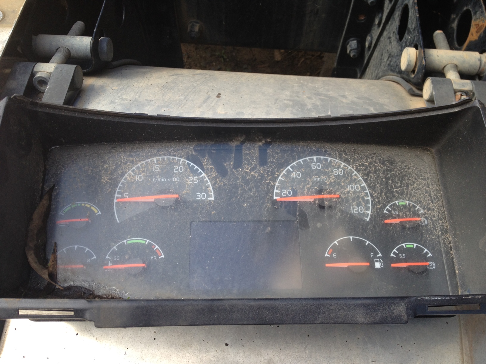

  17. stowaway
    stowaway New Member
    Mar 16, 2009
    213
    Gold Coast - Australia
    1Coins
    unforuntely my board has many many inputs, (it controls a LCD screen as well)
    It has some sort of servo or motor on it, I have pulled one off to try and see if i could get it run.. I tried using standard Servo signal, and PWM with varying signals, but I couldnt get it to move..
    it may aslo require 24volt which im only using 5 or 9volts. The truck runs off 24 volts.. :(

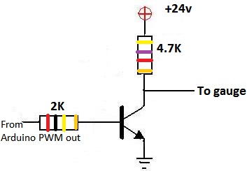

  18. gazz
    gazz Member
    Feb 16, 2012
    35
    Scarborough
    105Coins
    Cool,
    That gauge pod could well be can bus controlled, apparantly that can be run off an arduino but needs lots of work and the knowlage of the can codes,
    But if it is definitely the type that has seperate sensors to feed the gauges, then great,
    If you can find the rev counter connections start with that,
    you will need 24 volts, so find a power brick from a force feedback steering wheel, as they are usually 24 volts, find where to feed the power into the gauge pod, when you apply power to the pod, you'll see the needles flick a little and probably raise ever so slightly off the stops,
    Then load the TonePitchFollower sketch on the arduino, http://arduino.cc/en/Tutorial/Tone2
    But dont bother with the photo resistor, instead put a potentiomiter in it's place... one side of the track to +5v from the arduino, other side of the track to - on the arduino, and the centre pin of the pot to A0 on the arduino,
    You will now have a variable frequency output at 50% duty cycle, which is what most rev counters want,
    Then inplace of the speaker and it's resistor on the breadboard, put a common emitter transitor setup:
    Any NPN transistor will do, im using 2N551, and 2N3004 transistors as they are what i had lying around,
    Run a wire from the 'to gauge' point to the rev counters signal input, this will give it a 24 volt variable frequency signal, you must ensure all grounds are tied together... i.e arduino's ground, power bricks - wire, common emitters ground terminal and the gauge pod's - connection must be connected together, but keep the + 24 volts away from the arduino, i.e. dont try running it on external power of 24 volts as i believe it's too high for it,
