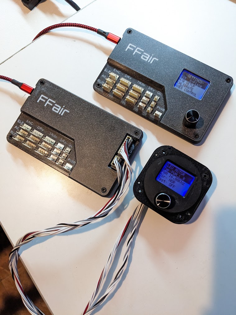

    I have made a system to build your own force feedback yokes (and rudder pedals) in xplane, p3d, and msfs.
    you can see here how it works in youtube writing "ffair a2a comanche". I can not put links here yet.
    The problem I saw with open ffb is that you depend on how force feedback is implemented in the simulators.
    And msfs is not supported, p3d is poorly programmed.... So you end up depending on software like xpforce, which is not very configurable.
    So I made my own central box, which contains all the configuration software to simulate any type of aircraft. With multiple forces, types, intensities, effects, autopilot following, etc..
    You can use your own motors, motor drivers and encoders (it is compatible with a lot of them) and build the system as you like.
    The control unit talks to msfs through a fsuipc lua script that is easily manipulated to link it with the variables of any aircraft.
    For example, advanced aircraft like A2A use a different RPM variable than the standard msfs variable, and there is no "xpforce" that can be compatible with all aircraft.
    With my system, you edit the lua script and tell it which engine RPM variable you want to use, and it sends the correct data to the control unit, which can simulate the effects correctly.

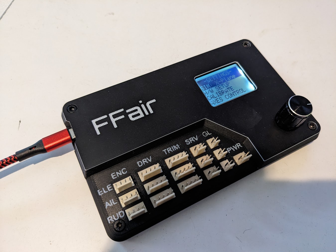

    That is correct. I used MY1016 / MY1025 dc motors.
    The central box is based in a teensy 4.1 using my own code.
    I don't use the FF windows api.
    I send the data to the teensy (torque, air speed, trims, autopilot modes, on ground, surface type, rpm, stall state etc etc etc). The teensy computes all the data, and read encoders to know the yoke position, and taking account all the config setup done in the teensy with built-in menu, drive the motors.
    I will put some docs here in next pots when I can use external links.

    Here is another one working with xplane:
    This is the central box:
    I am building central box with a remote gauge (same dimension real aircraft gauges so you can put a gauge in the panel to setup the system:
    you can see wiring manual here:
    https://drive.google.com/drive/folders/1x9gZsUDggGmZ0Zr5zCQv19v83EzOYOEE?usp=sharing
    There is the setup guide there too, but it is only in spanish yet. You can translate with some translator to give you an idea.
    Thanks.

    the central box...
