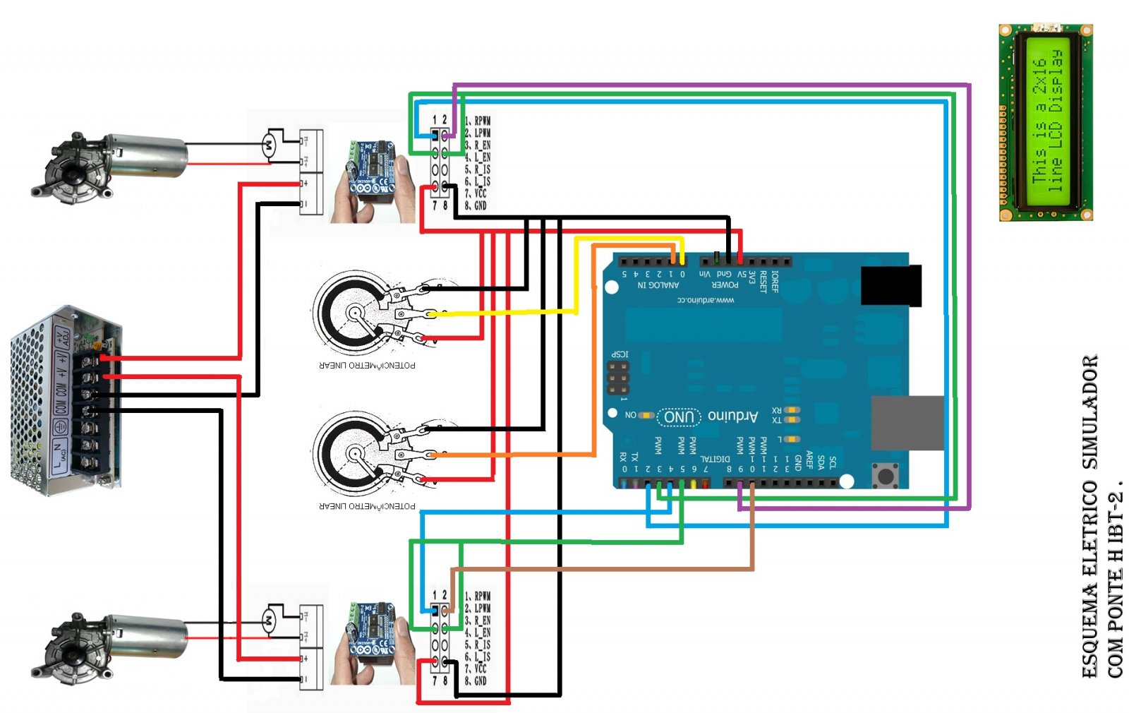

    Hello everyone following the advice of some users of the forum I decided to shelve Pololu jrk12v12 and switch to Arduino with h bridge ITB2. You tell me if you know this wire configuration is correct?
    with this configuration that Arduino code should I use? I have Smolka engine 24v 404.458

    You should write your own code probably...
    And your schema is not good. You need to separate all pwm. Each is a different analog signal to drive a motor in one direction.
    EDIT : you need pwm signal on Lpwm and Rpwm and digital outputs (separate too) on R_en and L_en

    These are already supported using the SMC3 arduino code. Just check the SMC3 thread for wiring and setup details.

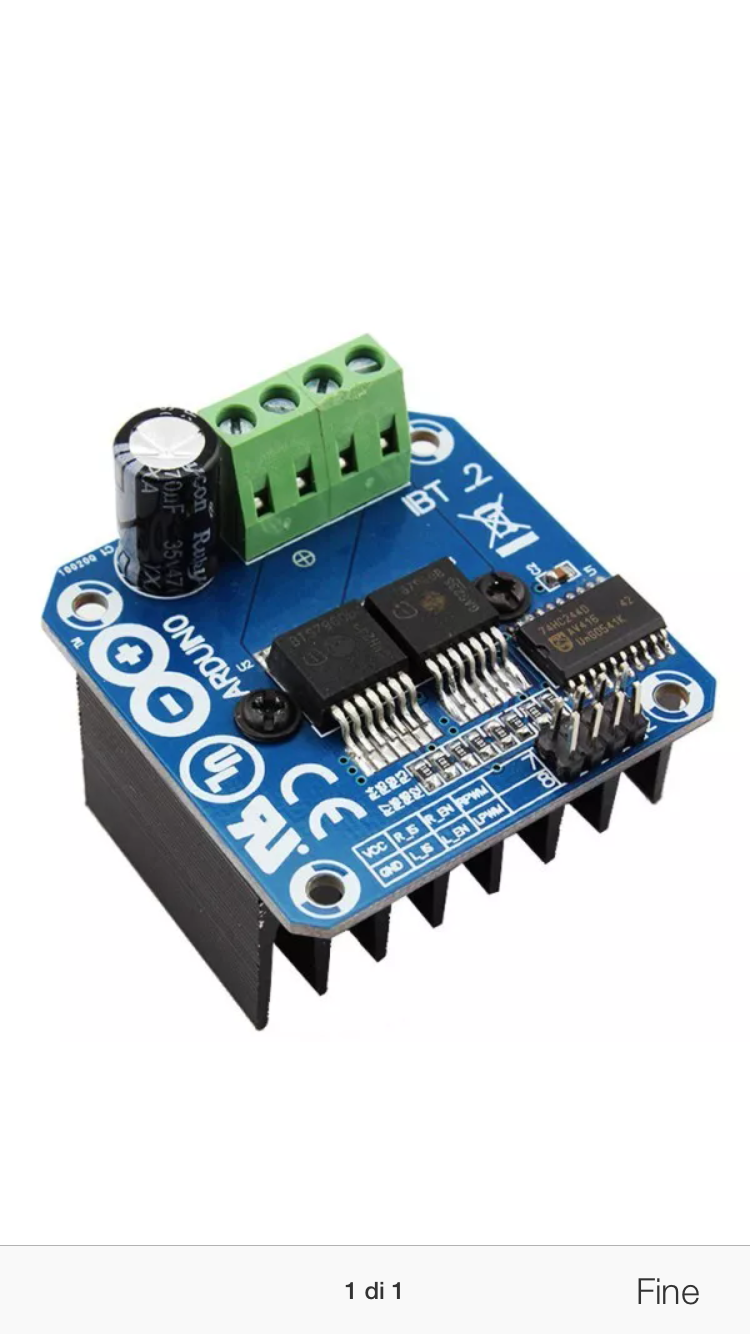

    Motomonster ha 14A continue 30A picco, ibt2 43A picco e monta già di serie un buon dissipatore di calore.
    Io uso 2 Ibt2 in parallelo x 86A sul mio volante directDrive e funzionano alla grande.
    Motomonster has 14A continuous 30A peak, ibt2 43A peak and already sets a good heat sink as standard.
    I use 2 Ibt2 in parallel x 86A on my directDrive steering wheel and they work great.
