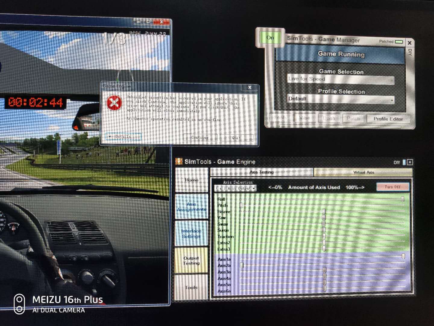

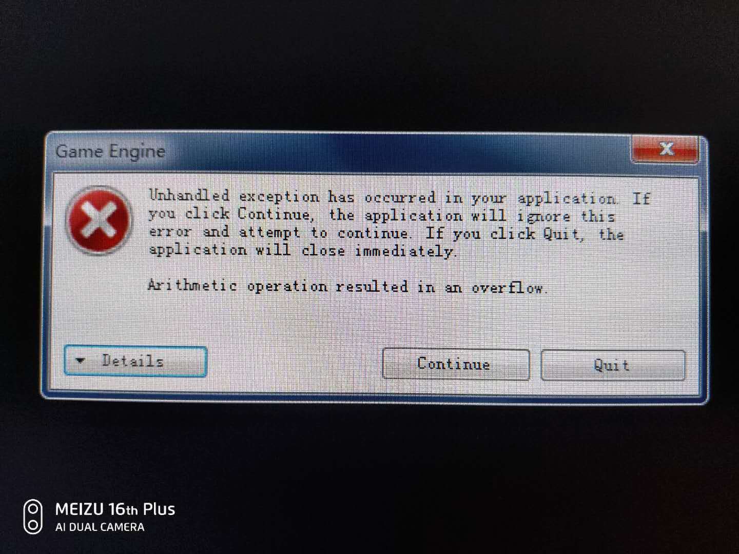

    Hello i need help urgently
    The following error always appears in Simtool, which is very annoying.
    The LFS patch has been prepared. An error occurred immediately after starting the game monitoring virtual axis. I don't know why.

    I have taken the liberty of editing your post and added a Google Translation.
    Can you please expand the error message using the Details button and post the full error message.
    Can you also please describe the conditions that trigger the error message.
    Are you using English Local, as that is a known issue: https://www.xsimulator.net/community/faq/simtools-language-setting-bug-change-to-english-local.233/

    I changed the current system locale to English (US), and it is normal,Thank you very much!
    21,031
    147,884Coins
    +10,880 / 54 / -2
    Glad you got it sorted, that is a bug @yobuddy has been trying to squash for ages, so he may be interested in some of the specifics about your computer setup and configuration. You could run Belarc Advisor, edit security info out of the report and then PM it to @yobuddy: https://www.belarc.com/products_belarc_advisor
