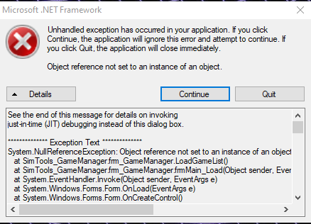

    I installed ACC plugin with plugin updater and now game menager and game engine wont start at all.
    What is happening, what can I do? Can I somehow uninstall the plugin, reverse this? Nothing works now.
    This is the error.
    System.NullReferenceException: Object reference not set to an instance of an object.
    at SimTools_GameManager.frm_GameManager.LoadGameList()
    at SimTools_GameManager.frm_GameManager.frmMain_Load(Object sender, EventArgs e)

  3. yobuddy
    5,282
    49,198Coins
    +5,093 / 18 / -0
    Delete the plugin from, "C:\Users\(user name)\AppData\Local\SimTools\GamePlugins".
    Looks like it's 26_GamePlugin.dll, please note that this is a v3 plugin and not a v2 plugin.
    As V2 plugins are only for v2, and v3 plugins are only for v3.
    Take care!

    Deleting the "AssettoCorsaCompetizione_GamePlugin.dll" plugin did not change anything.
    Same message even after windows restart. I deleted "26_GamePlugin.dll" now game menager and game engine starts normally (motion works in output testing) but not in game.
    What is the best course of action now?
    And while we are at it, can you please provide a link for V2 plugins? Your page is a bit puzzling and I can only find the link for V3 plugins.

    UPDATE:
    It works fine now. In the process I deleted Assetto Corsa plugin also, so it didn't work in asetto.
    Returned the Assetto corsa plugin from my backup file.
    A link for the Assetto Corsa competizione V2 plugin download would be much appreciated. :)
    Thank you for the help.

    All SimTools v2 plugins are here: https://www.xsimulator.net/community/marketplace/
    Including Assetto Corsa Competizione: https://www.xsimulator.net/community/marketplace/assetto-corsa-competizione-plugin.220/
