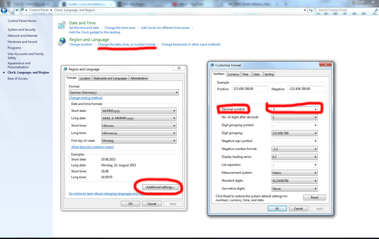

    Hello everyone!
    i'm trying to make my dash work with Assetto Corsa and i hit a bump with Gamedash.
    I can't get the speed working.
    The game sends me values of speed but i cant ROUND them.
    123.5432km/h for example. i can't convert it to 123km/h
    if i use a combination of different functions a can get 123km/h but when the speed drops below 100 the output isn't good. 99km/h i get 990km/h
    im thinking it something with the decimal value that doesn't get converted right.
    any issues with comma math?
    thank you

    Maybe the same problem I had.
    Check thios screen i got from value 1 and set in the right screen "Dezimaltrennzeichen" to a "." not a ",".

    the image link doesn't work :(
    i think GameDash doesn't see the data as decimal value but as thousants.
    example: game sends 121.4532km/h
    and if i use ROUND 0 i get 1214532
    i even tried first to ROUND then MATH / 10000 an then ROUND 0 again. i stil got the same result (121.4532). I know it's stupid but if there was any problems with decimal places this coul fix it.
    So no luck so far. Maybe if the author could implement a new function let's say REMOVE 4 ( rour numbers form right to left) for example. then it could work ;)

    sorry my answere wasn't helpfull, but i was in hurry.
    I even don't know if this is the solution for your Problem but it helped me with some Gamedash value Problems.
    I try to descripe it better this time:
    First you go to:
    Start-->Control Panel-->Clock, Language and Regions
    Now you go to Change the Date,Time or Number Format-->Additional Settings--> Set Decimal symbol to a dot "." like in the Picture below.

    My friend you are the best! That was exactly the problem!! Now everything works like a charm! O owe you a couple of beers!!! Thank you sooo much:)
