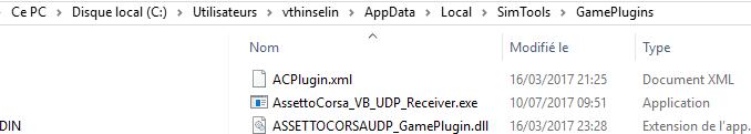

    Hi.
    Already tried everything and could not make it work on my ps4.
    Could you tell what I should configure in the game and in the Assetto corsa UDP XML file? Pictures or video please.
    Thank you.

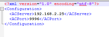

  3. vthinsel
    vthinsel Well-Known Member
    Feb 20, 2015
    439
    FRANCE
    6,010Coins
    +564 / 2 / -0
    Arduino, 4DOF
    nothing to configure in the game.
    xml content: put the IP@ of your PS4

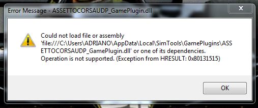

  4. FrancescoRoberto
    FrancescoRoberto Member
    Mar 31, 2018
    87
    Italia
    96Coins
    +25 / 0 / -0
    I try to connect my playseat and the Assetto Corsa game for PS4 but i didn't success becuase after I completed the actions that you described, when the Game Engine start I find an error message. I think I execute the copy file and the edit of .dll with the PS4 IP.
    This is in attachment.
    May you help me.
    Best regards

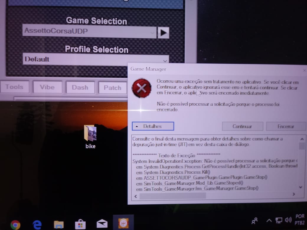

    Hello.
    Anyone with this problem?
    In the PS4 Assetto Corsa.
    When o change track or car the crash Simtools.
    I have already reinstalled plugin, patch, and replaces the ACPlugin.xml file.
    It did not work.
    Any idea what to do to fix it?
    Thank you.

  6. Leandro Kemp
    Leandro Kemp Active Member Gold Contributor
    Oct 14, 2015
    161
    Brasil
    - 10Coins
    +33 / 0 / -0
    Error picture.

  9. vthinsel
    Feb 20, 2015
    439
    FRANCE
    6,010Coins
    +564 / 2 / -0
    Arduino, 4DOF
    Hum. Strange. Probably a value goes out of normal range when changing lane (going to the pit lane you mean ?), and thus crash occurs.
    It is going to be difficult to debug this as I do not have the game anymore......
    A capture using the UDP tool I made could help somehow I guess but I cant promise anything.

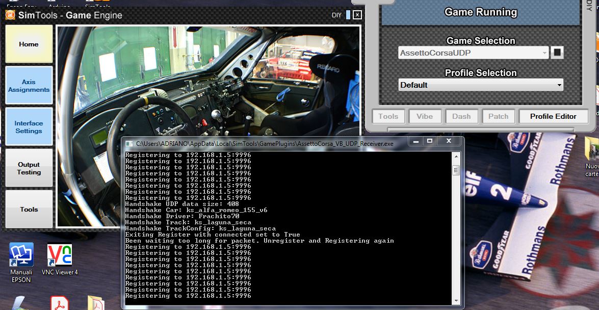

  13. FrancescoRoberto
    Mar 31, 2018
    87
    Italia
    96Coins
    +25 / 0 / -0
    Sorry but all my tests failed.
    I've changed the local country and language, I've changed the car and the truck, I don't understand what do you mean about "pit lane".
    Anyway I don't succeed to start the playseat and Assetto Corsa.
    I attach the text that I watch on pc monitor when I start the plugin in Game manager.
    Is there a precise comands or actions sequence that I make to obtain the correct functioning? For example:
    1^ Start Assetto Corsa
    2^Start Game Engine
    3^Start Game Manager
    4^Start the plugin UDP in Game Manager
    5^Start the race
    Is there any setings that I need set up on AC menu before I start to play?
    Regards

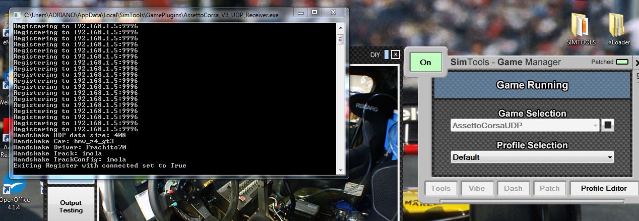

  19. FrancescoRoberto
    Mar 31, 2018
    87
    Italia
    96Coins
    +25 / 0 / -0
    I'm just an inability, I downloaded phyton but I did not understand what to do. I tried to start two applications, but the palyseat does not move. Perhaps the problem is related to the version of the game? Somebody help me.
    Thank you.
    See the attachments.
