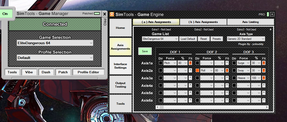

    Hi there
    I'm new here and I had the opportunity to get a Atomic A3 from a good friend of mine. It's a very simple device.
    I now am configuring everything over SimTools because the Simphynity software of Atomic doesn't support the games at all - need to have a special version etc. - I wasn't able to get it work.
    With SimTools it works and I really love the tool
    Here my issue:
    - Atomic A3 has settings for speed and vibe - I'm not sure how to configure the Acceleration forces correctly. At the moment it seems that I only get motion when pitching and rolling (Elite) but not when I accelerate the ship.
    The same thing in the racing games. No acceleration force when speeding up.
    - Can anybody help me to configure this correctly?

    The SimTools version is on the SimTools Game Manager splash screen.
    The Dir box in Axis Assignments being checked orange or not determines which way each axis/force moves, this is what SimTools expects: https://www.xsimulator.net/community/faq/which-way-to-set-simtool-axis-movements.230/
    Follow these steps one axis/force at a time to refine a basic motion profile for each game: https://www.xsimulator.net/community/faq/steps-to-create-a-motion-profile.228/

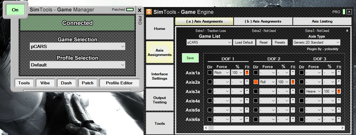

    Thanks for the help guys! I'm a very noob...
    Is this correct now?

    Setting up SimTools depends on how your axis are designed.
    If this is a tradition 3DOF, say two axis at the front and one at the rear or the opposite of that, then you should allocate all axis/forces for each axis, sticking to around 100% total. Some sims have a single axis for just one effect, say traction loss, where that is all that axis does, hence it gets a single 100% allocation.
    I am guessing yours is a traditional 3DOF so should be configured accordingly, so each axis will include an allocation for sway, surge, roll pitch and heave.
    I would suggest you not mess with filters until you have the fundamentals correct.

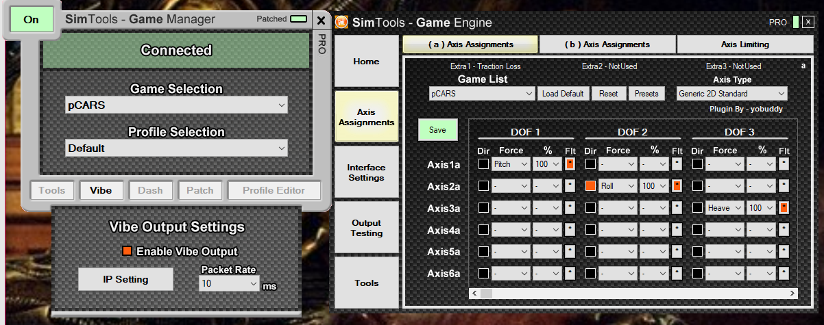

    Sorry for my late reply & thank you so much for your nice support!
    It seems that the Atomic A3 software (Simphynity) has its own axis management. It is only a 2DOF device, but it seems to have DOF1 only for pitch and the DOF2 for roll and DOF3 is not a motor, but a virtual device that is for all the forces like surge, sway or heave. And you can put them on 100% and the software is balancing this itself with a slider V-Force that is attached to the DOF3. That's what I think after experimenting. On DOF1 and 2 the device is not moving for surge, sway and heave.
    Regarding the filters: I only used some smoothing because it liked it more this way. The Simphynity software also has a Slider for strenght of the forces and this seems to do some smoothing, too.
    And after installing the OpenVR-input-simulator 1.3 I also has the motion compensation for the Vive Pro. What's very important: You should deactivate the motion cancellation in the Simphynity software and also delete the Simphynity drivers in the VR folder because this is an older version that makes a conflict with the newest Input simulator 1.3 and SteamVR (or beta). https://github.com/matzman666/OpenVR-InputEmulator/releases
    But hell I like it now - SimTools is such a mighty tool and it helps a lot to get a more and more realistic feeling. I'm still experimenting! But I love it! I wish there is a way to get the tactile transducers getting to work. I'm not sure if the vibe value will trigger it or not. I have to test it this week.

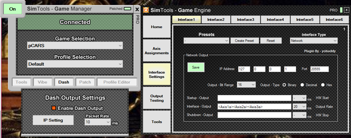

    Wow again! You guys have a software for everything - incredible. I will test it this week and give some feedback.
    Regarding the vid. I first want to configure it right and it's no Pro device - but I really like it :) Later on I can link a vid.
