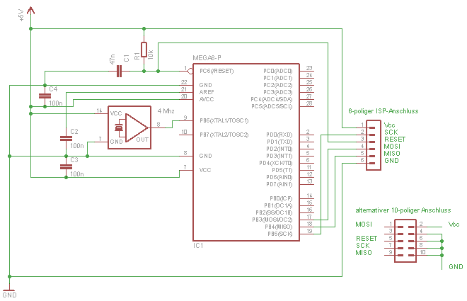

    I think, I'll solder a small PCB with a 28pin socket, restet button, a quartz and break away headers to use with breadboards. Clean and simple like this one:
    Maybe I'll make a PCB (toner transfer method) and use SMD components to keep it small.

    I think it is pointless to make such a simple board, especially for 28pin uC's. It takes about 2mins to throw everything on a breadboard and make it organized too. Every time you hook things up, you learn more and more about the controller as well.
    I have a small component bag that I always use for the essential connections for the controllers such as: 0.1uF and 10uF caps for power, 10uH inductor for AVCC, 18pf caps for Xtals, R/G/Y LEDs with 470ohm(because I have lots of them) resistors for troubleshooting, jumper wires from different lenghts.
    If you want to make a board like this, make sure you check the pin connections on different AVR's or uC's you want to use. You could put a 8pin, 28pin, and 40pin socket on it for more flexibility. I strongly advise not to solder a crystal in the circuit and don't make AVCC and AREF pins permanently connected to anything, but use sockets and jumpers instead.
