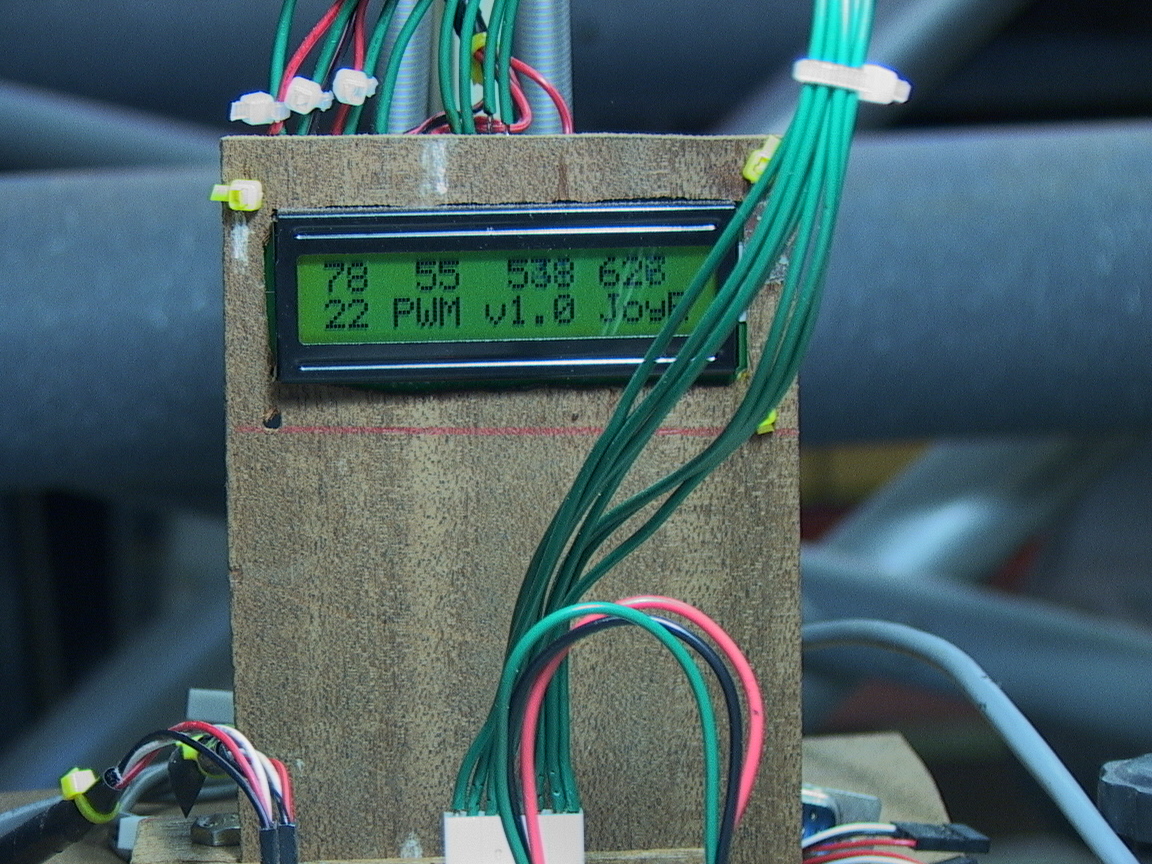

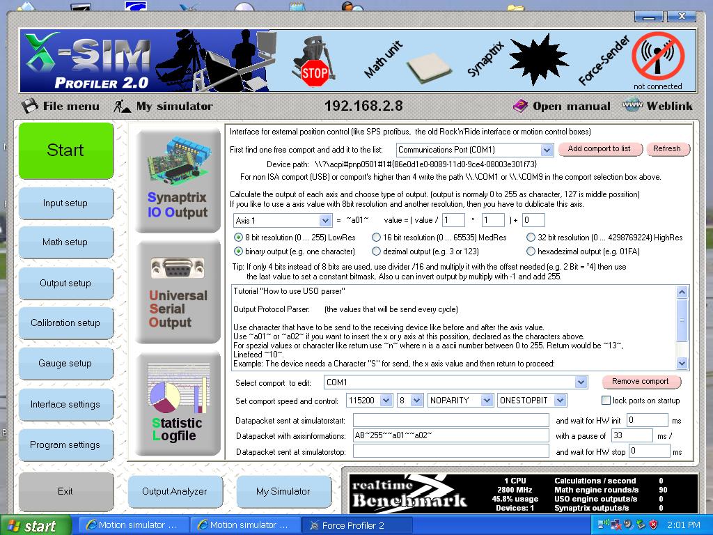

    Greetings,
    My avr 1.5 will not hook up with the computer running profiler. In the amc video guide pt 4, it shows Force Sender with a IP address 127.0.0.1 and right below that, Microsoft Sidewinder Force Feedback2. It is not clear where it came from or if it is of any great concern. I don't have anything on my computer, it resides on computer #2, not hooked up. The video does not show how to do this. Any help is greatly appreciated. :? In running Profiler, the first and second values on the avr LCD are static @ 128 and the third and fourth go 0 to 1043, and come to rest in the middle aound 600 and 500.

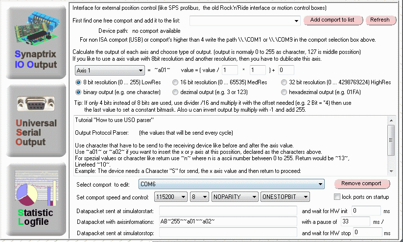

  2. tronicgr
    tronicgr
    Depends on what version profiler you are using... you might want to look on your USO output settings... AMC is not plug and play detected device.

    Thanks for your response, the version Profiler 2.0! :)

  4. tronicgr
    tronicgr
    Is your USO settings like this?

  5. jsmith2307
    jsmith2307 Member
    Oct 2, 2010
    105
    Respiratory Therapist
    Corpus Christi, Texas
    324Coins
    +7 / 0 / -0
    2DOF, DC motor, Arduino, Joyrider, Motion platform
    Affirmative, that's the one! :yes:

    It WORKS!! I switched a 18.432 crystal with a 22.1184 crystal and it now works. :yippiee: :mug1: :D
    Now, if I can get the thing to flash. I purchased a Sparkfun BOB-00718, thursday. I hope it works
