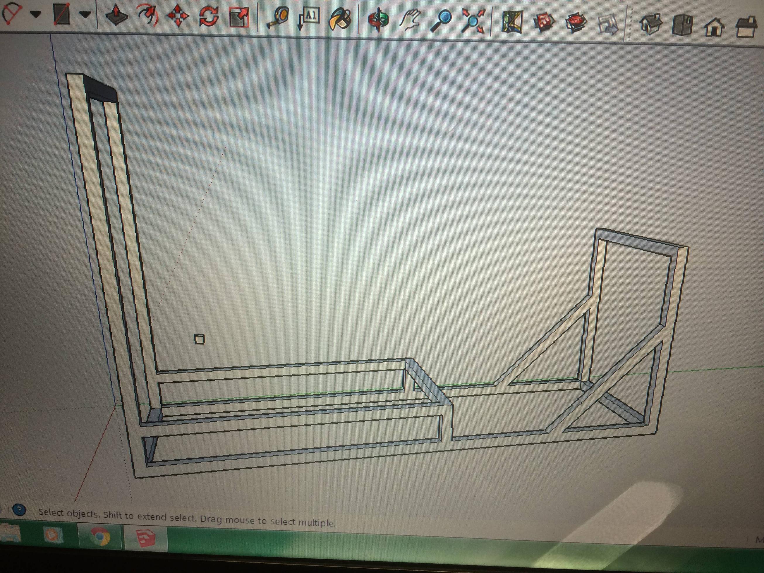

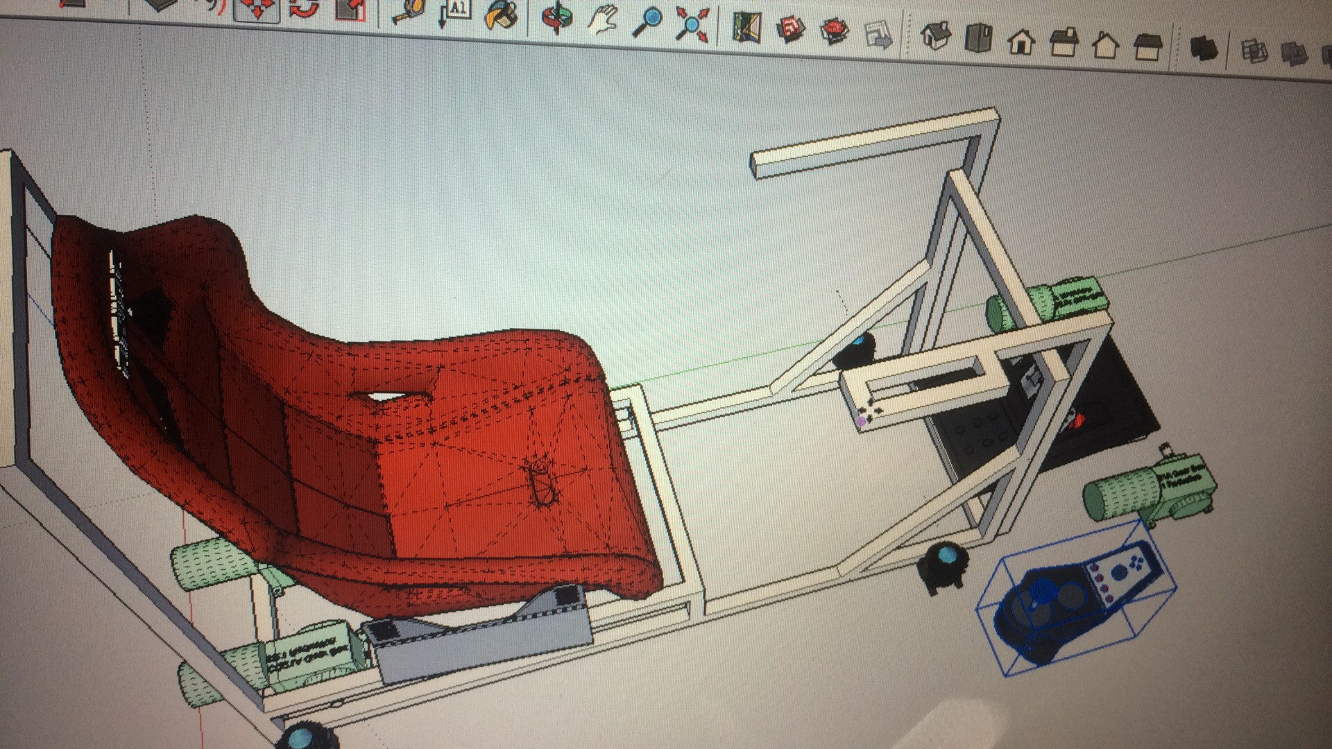

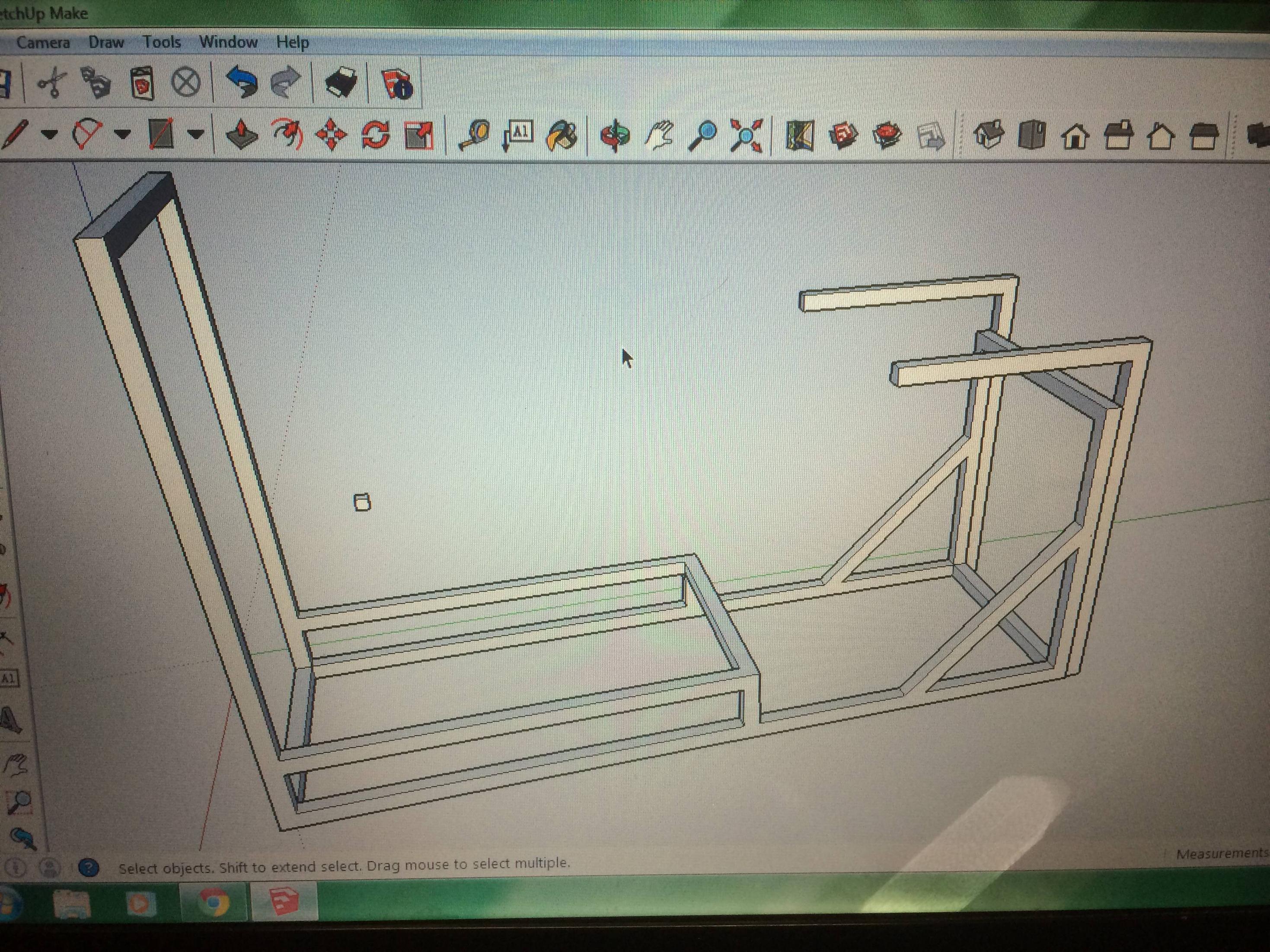

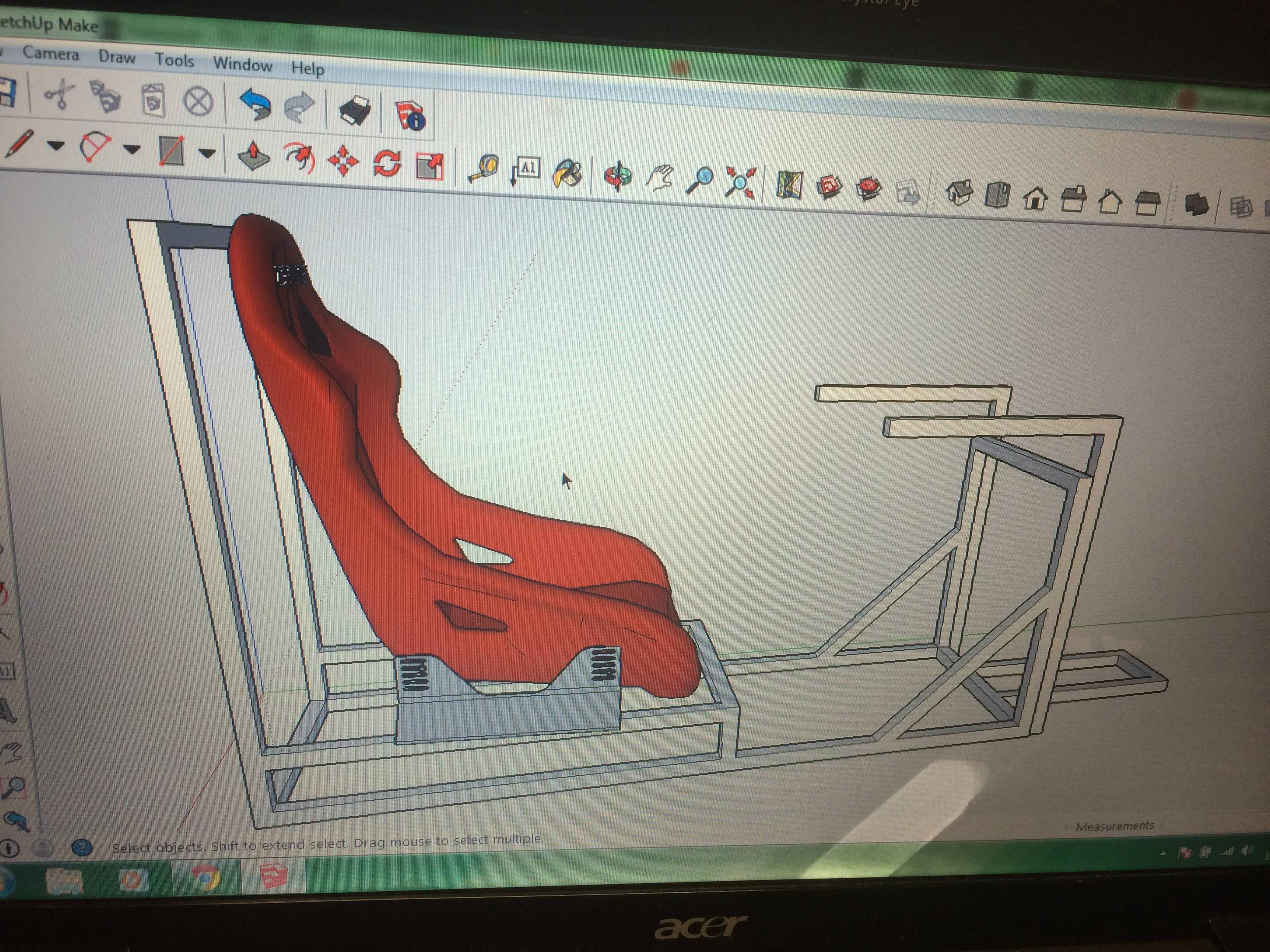

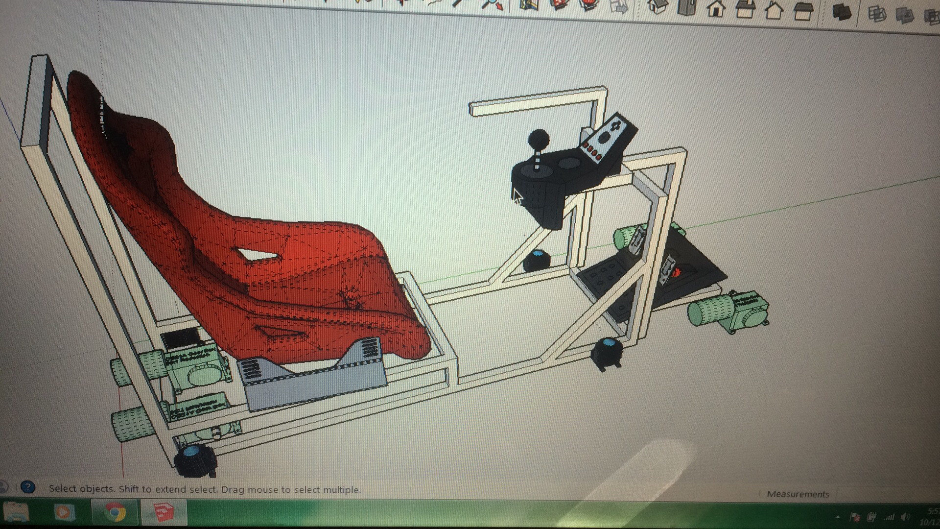

    As for the motion side of things I have stayed off until now and am looking for suggestions and setup advice. Over Sunday and some drinks I decided to give sketchup a go and have come up with a fairly accurate representation of what the rig is now minus bolt holes and such.

    On the physical side of things I believe a 4 motor setup will be the balance of power and price since 6motor seems to add quite the configuration change when looking at size and layout. I have a basic positioning of the motors in the screens which is a bit like u/bsft rig if not mistaken but would require linkage/supports not shown. Suggestions here are welcome in relation to the current rig shown above or convince me that 6 motors and a compact design is possible.
    Along with the motor layout, from what I have read it seems that even on a supported 4motor rig one should still use a balance point gimbal to ease motor strain? Also the idea of spring tension is of interest and I was curious as the pros and cons on this.Elaborations in any form are welcome.
