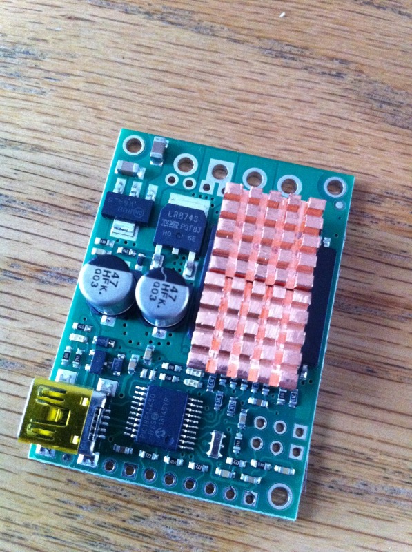

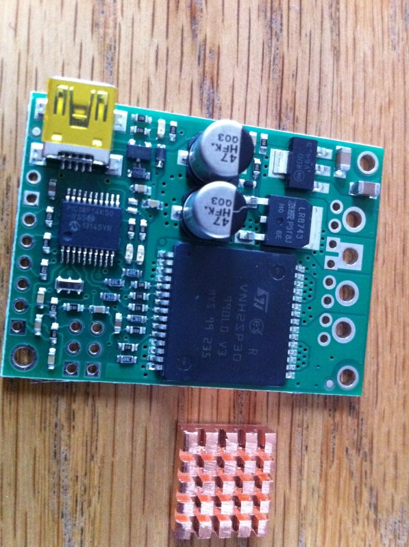

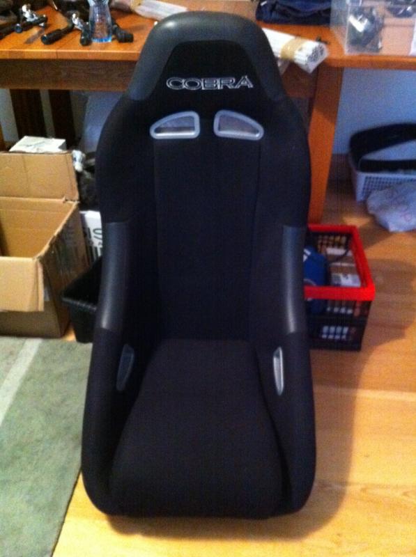

    Got myself a seat. I also ordered some copper heatsinks for the JRKs.

    You can use the two axis that you have for Pitch, Roll, Sway, Surge and Heave, no need for another axis. They mix together very well.
    Nice seat, makes me wish I were skinny again ;)

    The seat is pretty soft, it's not carbon backed or anything so it should fit most people.

    I am 6'4" with shoulders as wide as a bull, unfortunately my middle is just as big, lol. :D So most seats will not fit my frame.

    I plan to run a good ventilation system in my rig but I bought small heatsinks for the JRKs as well.
    Are these too small or should I just stick 2 of them on each one? Or are they still too small? I've seen people running huge things large than the entire JRK with an 80mm fan.
  15. bsft
