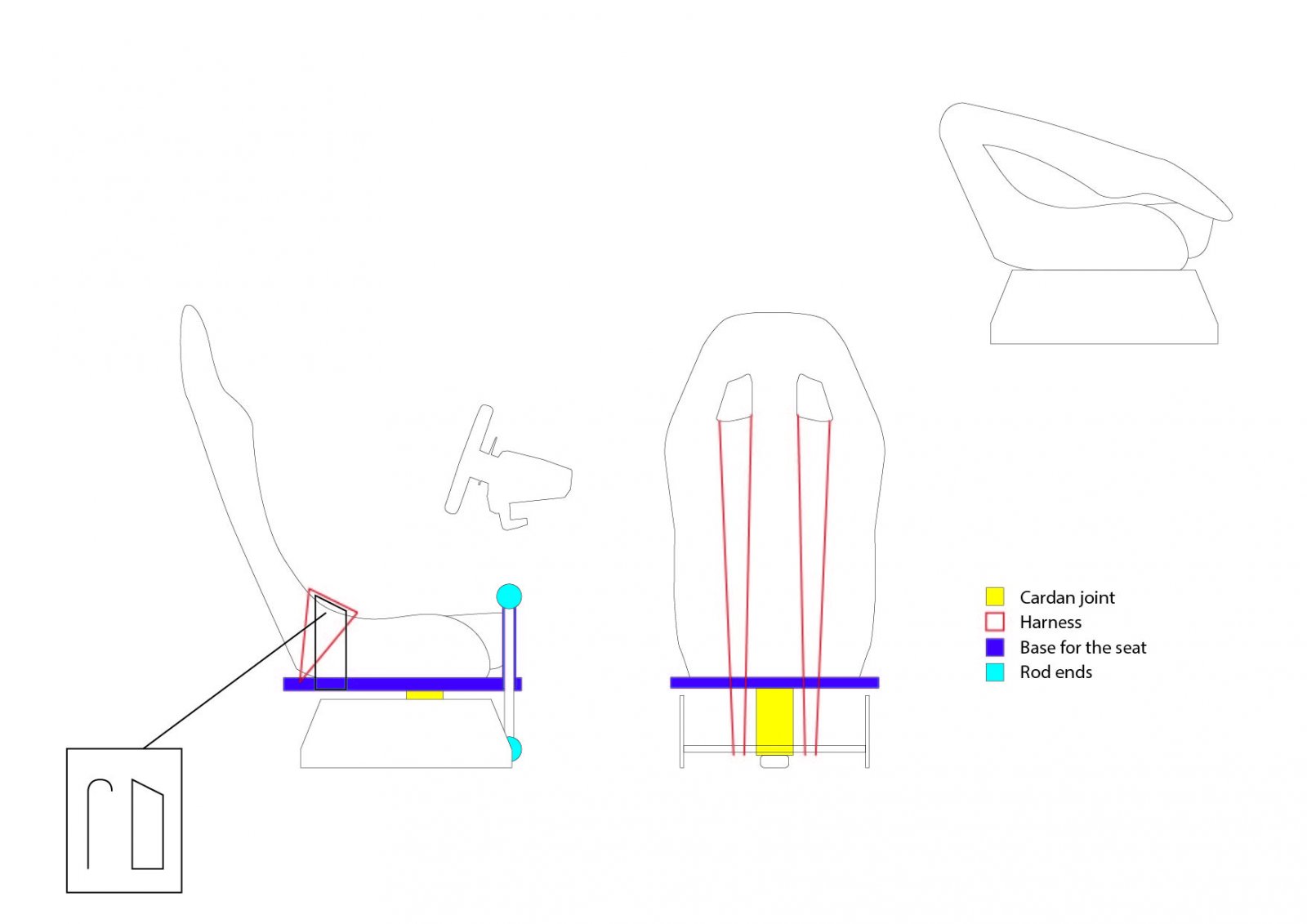

    As I said, my project will be 2dof desk racer where the motors will be mounted to front of the seat and only the seat will be moving. Seat will be Playseat Evolution with as little modding as possible. Motors will be some random 12v wipers from a wreck. Also I will be getting an u-joint from a friend. 4-point harness will be added too, I heard it gives a nice addition to immersion of G-forces!
    Key aspects (in order)
    -robust
    -cheap
    -compact
    -safe
    Is there any drifters here? Is it worth it to build a motion simulator? What do I need to consider before starting to build?
    Thank you :)
    31.03.2016:
    Some initial drawings

    If you like drifting I'd suggest you evaluate also adding the 'traction loss', so a 2DOF + TL
    About your sketch: I'd go up to the shoulders and not to the base of the seat, especially with weak wiper motors

    Thanks for the fast replies :)
    I did not mention about traction loss because i thought its not that well suited with static wheel and shifter? After lots and lots of time thinking I decided to keep feet static and only the seat moving. And I got this feeling that this will be first of many builds :) Traction loss and more juicier motors will be added
