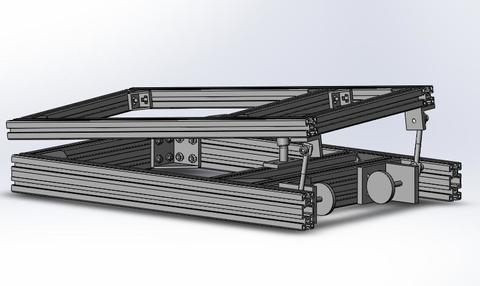

    Here it is:

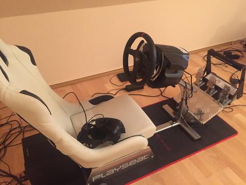

    And this is my current racingseat. The parts of this, i will use for my 2DOF.

    Another question, that keep me occupied...look at my stech...i plan short steeringarms to control my platform. Why sometimes the people use really long arms (nearly so long like the seat height)? Is this better, because the angle is better for the speed/power? What is better in your opinion? I try to do no mistakes.
    Edit: the benefit of longer arms i see is, a bigger movement, because on the upper connection, the lenght is shorter then the downside (in the most videos i found). Now i'm not sure, is my sketch good enough. My plan is, to use my seat plattform without cut this. And the second wish is, do bring a flat solution.

    Hi! As being a newbie myself, I figured this arm-thing purely based on how long the distance is from pivot point and where the center of mass is. So you can calculate movement when you know distance from pivot and how much your lever in motor moves... Then the force required depends if the mass center is lot away from the pivot. How long arms you use, does only a little difference (mainly that long arms angle changes less and in my opinion they may bend easier). This is my theory :)
    In my design I figured that there is less twisting power then my arms is connected to more center of whole moving base, than on the back.
    Good luck with your project!

    The reason for longer arms is to make the most of leverage, with a longer length from the pivot point and the connection high up it takes less torque to drive the rig.
    A compact design can work just as well, as the the seat back acts as a natural lever, but it does take more torque to drive a compact design because there is less design leverage.

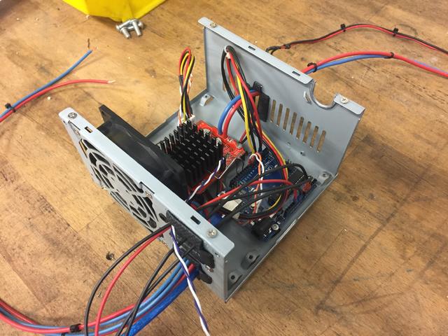

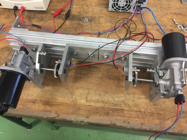

    Some news about my project. My Arduino box is ready and my motormount is near ready too. I think, next week, i can do my first tests with simtools. I'm in fear for this tool. I hope i can do the setup correctly. I let you know. :)

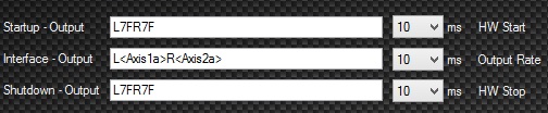

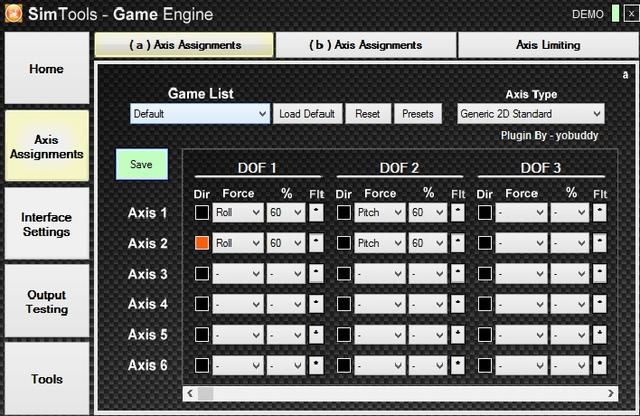

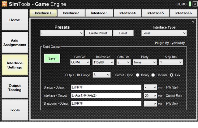

    Hey friends. Now i stuck with a problem. Output testing on sim tools dont work correct. I use the "RacingMat_2DOF" code. On test without simtools by turning the potentiometers, the motors look working right. But if i test by output testing, i can't control the motors. If i turn on the testing, the motors start drive 20 degree up and stop. But nothing happen, if i use the slider...this is the problem. If i turn of the testing, the motors drive back to the start position. What i do wrong?
    This is my interface setting: (com settings are exact the same, like my windows settings)
    And this is my axis settings.... but i tried so many different settings...
    Please help me out. I really clueless at the moment.

    For simtools v2.x , in interface-output you should put an (a) L<Axis1a>R<Axis2a> if you are using the (a) Axis assignment tab for you motion profile

    Yes! Perfect! That was the solution! Now all works right...but my vipermotors are not good for this job. They are to fast and have a overrun. I had to play with the arduino code, to stop jitter and become a good position stability. Maybe i have to change the motors...not good. :/

    Finally i could do my first real test, with my two motors. I'm not really conviced, that this works correctly. I recorded a video for you...sometimes, i accelerate and only one motor moves (in the video at sec 12). That seems not normal for me. And somtimes after a corner, the arms don't find the correct position back. (sec 33)
    Link:
    https://www.dropbox.com/s/7wcrwjmb9kxzmda/LFS Test1.mp4?dl=0
    In know, my gears position is wrong...the small one have to be on the poti. But my problem is, that the motors are to fast an have a overrun. If i do the gears, how they have to be, then i become a strong jitter. That i can't compensate wise with the code. What you see, is the best result, i become today. I Hope, i can found a better solution. The motors was not a good acquisition.
    This is my interface setting. Maybe here i can do some optimations? If you have a idea, that could help...
