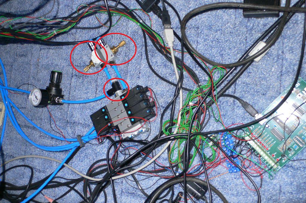

    Check this picture, i found it finally:
    You need 4 valve per cylinder, for 3 speed. 2 valve per cylinder, its only 1 speed. (you don't need the relay card, controlled directly is perfect)
    Use airflow limiter in the valve output. You see the marked limiters, still enough only one piece per valve.

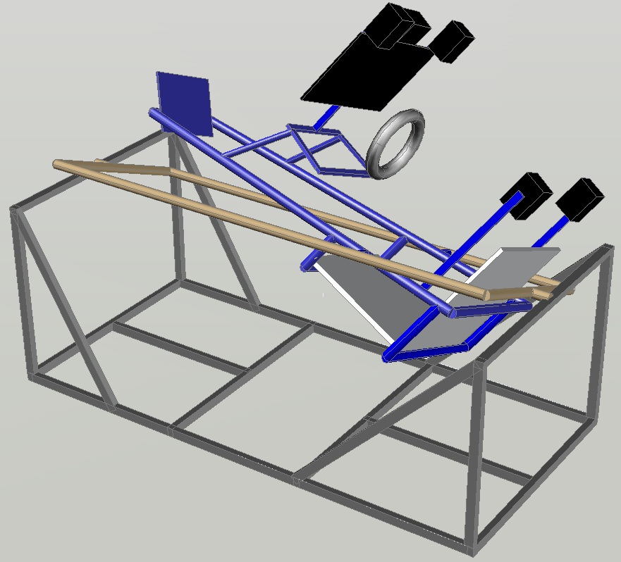

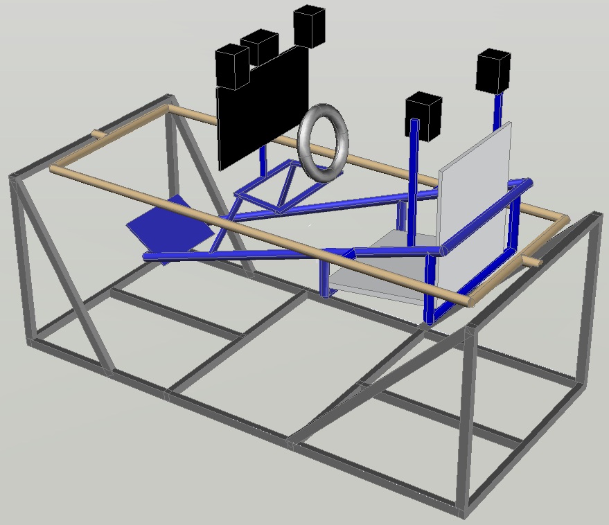

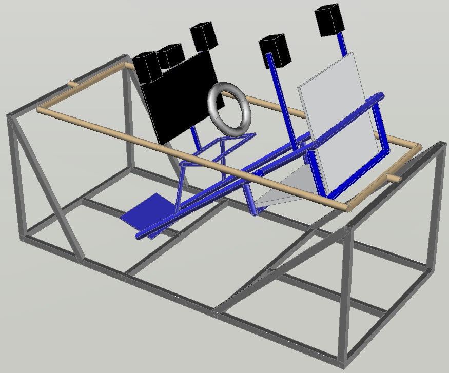

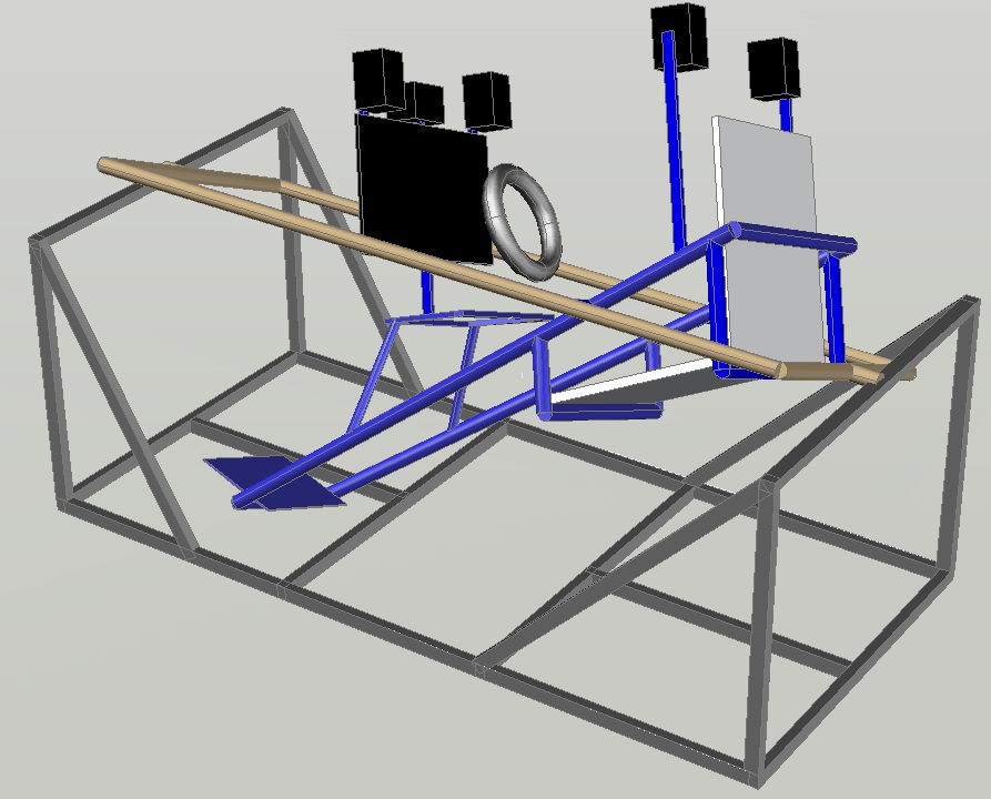

    The design I have in mind is the one from Thanos, it would be something like this:
