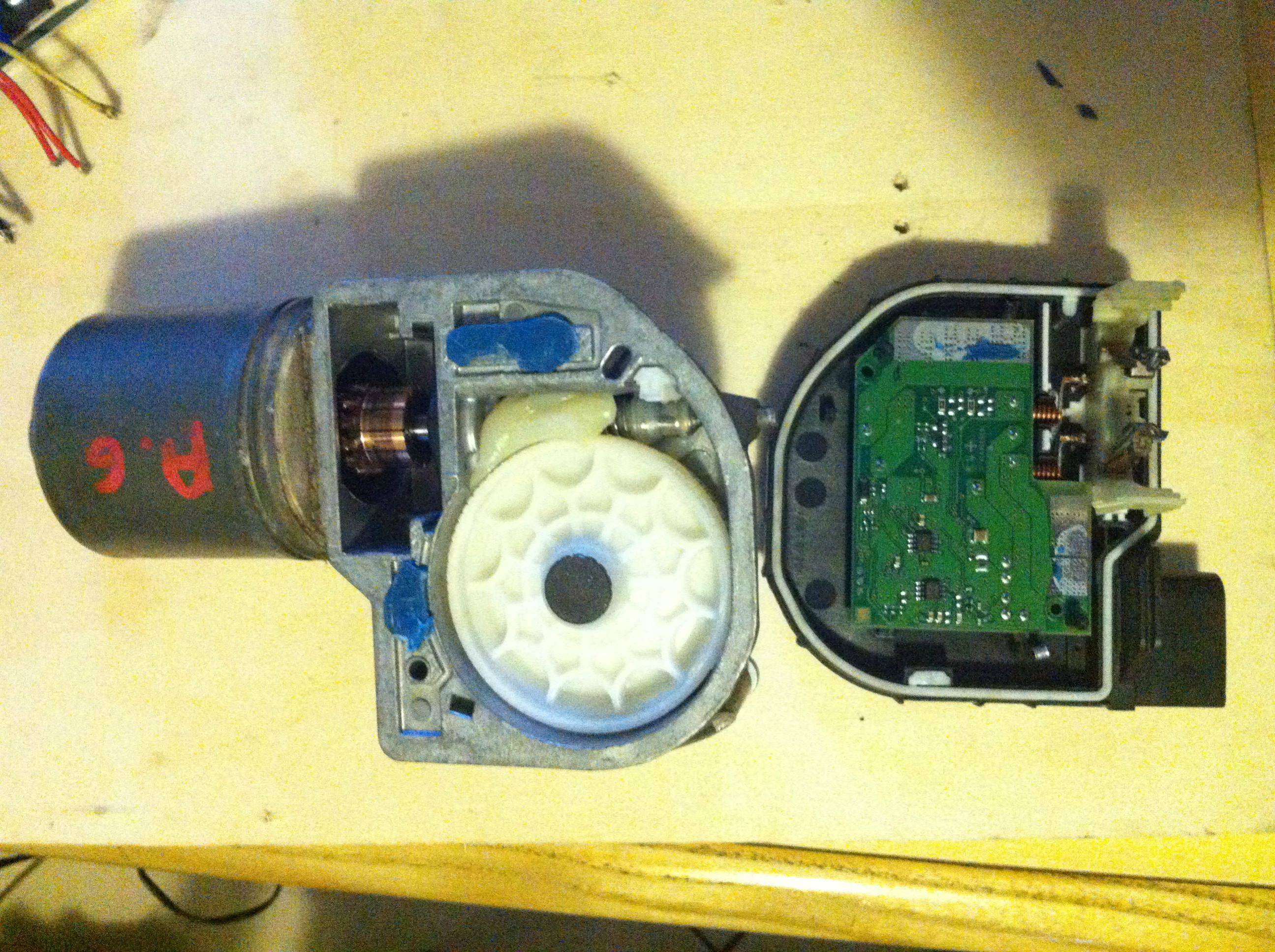

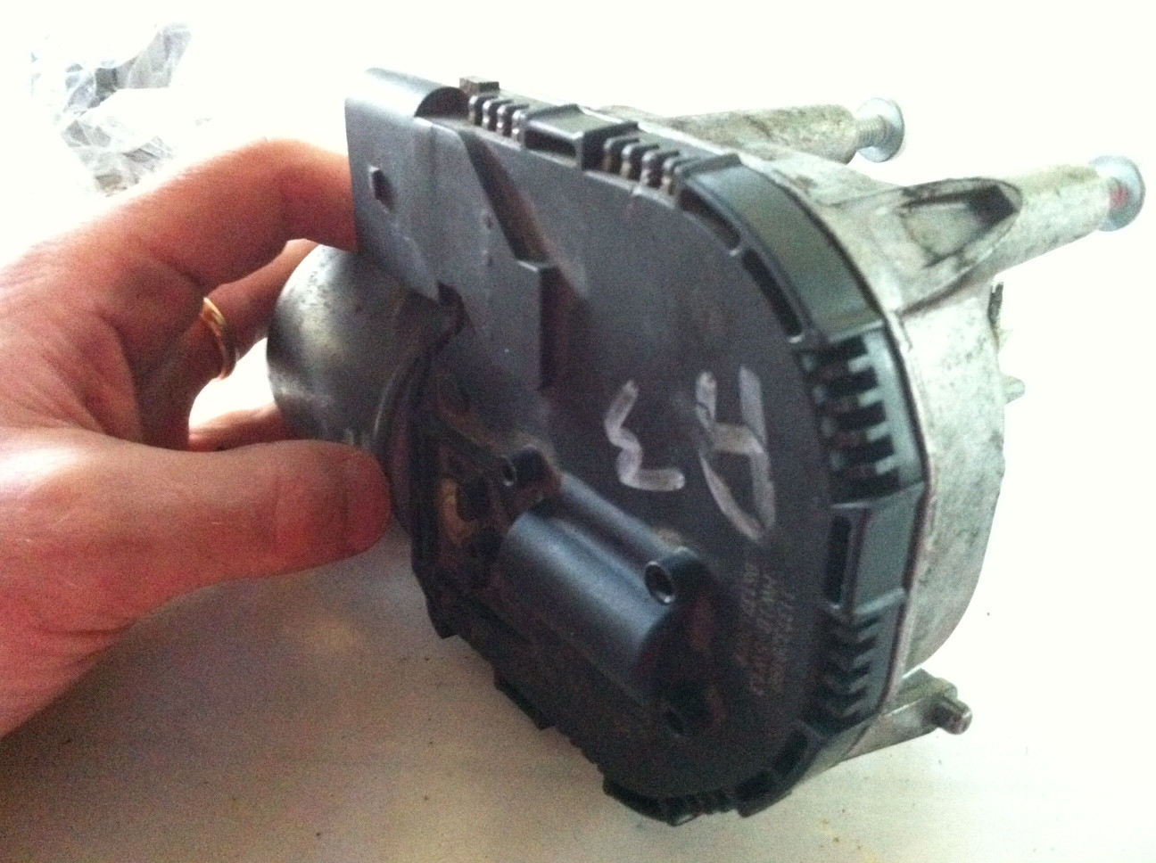

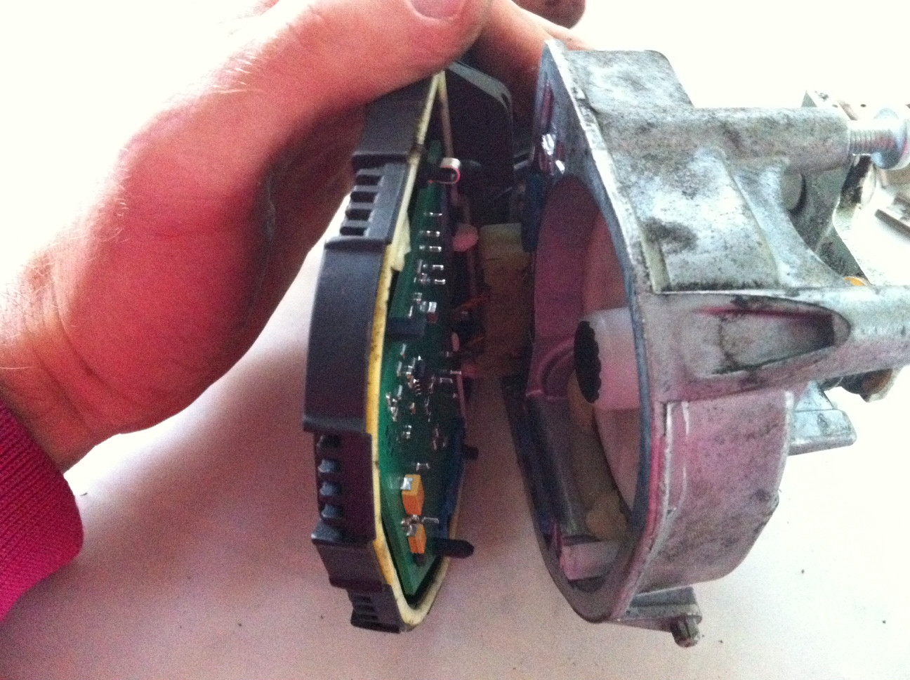

    I'm thinking to put the potentiometer on the back of the motor.
    Yesterday i have opened my 2 wiper motor to see where i can drill to put the potentiometer but when i opened it i noticed that there is pcb rear:
    How can i do?

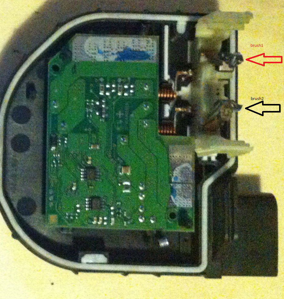

    take it out and leave connectors going to the brushes (if they are connected through the PCB)

    but for the project the pcb into the motorwiper is needed or not?
    i can remove it?
  15. insanegr
    insanegr !N$@n€
    Jan 14, 2014
    504
    Athens
    16,718Coins
    +499 / 1 / -0
    you just need the two wires going to motors brushes thats all (high speed).
    pcb is there for parking mode(when used on car for wipers).

    See the brushes:
    go behind the PCB and solder your wires straight on them
  20. insanegr
    insanegr !N$@n€
    Jan 14, 2014
    504
    Athens
    16,718Coins
    +499 / 1 / -0
    @siantic do what @RacingMat told you.
    you have only one speed as you have only two brushes
