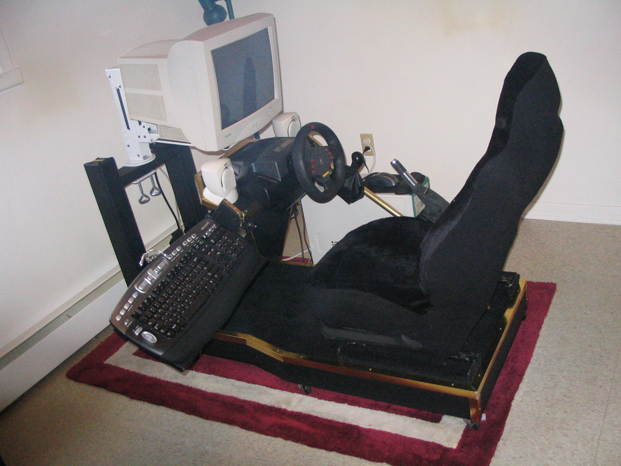

    Hi All!!!!
    i am brand new too, and i already have a platform with a car seat and everything else attached to it, wheel, pedals, shifter, handbrake, subwoofer etc..it is made of wood, leather and fake gold aluminium trim etc.. playing on a 90 inches across 3D projector, pretty cool :) !!!
    So i would like to have only a small travel to simulate road bumps and hill, road vibrations and shifting G force, a bit like the D-box, which i asked for the price (here in montreal, i am french canadian :) ) of the cheapest system, they told me about $8000.00, crazy stuff !!!!
    I am not looking for a violent movement like thoses youtube vids that i saw with the guys going almost 45 deg angle banking on the side, just want to feel the road, so i wonder if i would need more than 2 dof for the hill and bump part of simulation...or i need 3 dof for having my platform move up and down while it is still leveled....??
    And like my friend here, i also would like to have help if possible on major parts findings(actuator, motor, drivers etc) and wiring (drawing etc.), even if i am an electronics technician, it has been a while i didnt work in what i studied and i am rusted lol :)
    And To answer partially to ''iwannagofast'', i checked the actuator, look fine, but i wonder if travel speed, 8mm per sec, will be too laggy for that ?? surely the more experienced guys will answer clearly....
    Tks in advance for eveybody who is whiling to help !!! really looking forward to add that feature to my rig, which is not bad for now..i added a pic of it :)

    VERY GOOD info to start withDavid !!! tks
    would also like to know what value of the pots i will need and if i need to mount them separately from motor shaft...

    to iwannagofast, without hardware (wheel, and other), just wood, simili leather and gold trim, gold tubing, maybe 2-3 undreds dollars, seat is a car seat from scrapyard and a cover from a car parts type store, leather bought at a linen store, all other at a home depot kind of store, very simple!!
    btw, tubing is to hide cables :)
