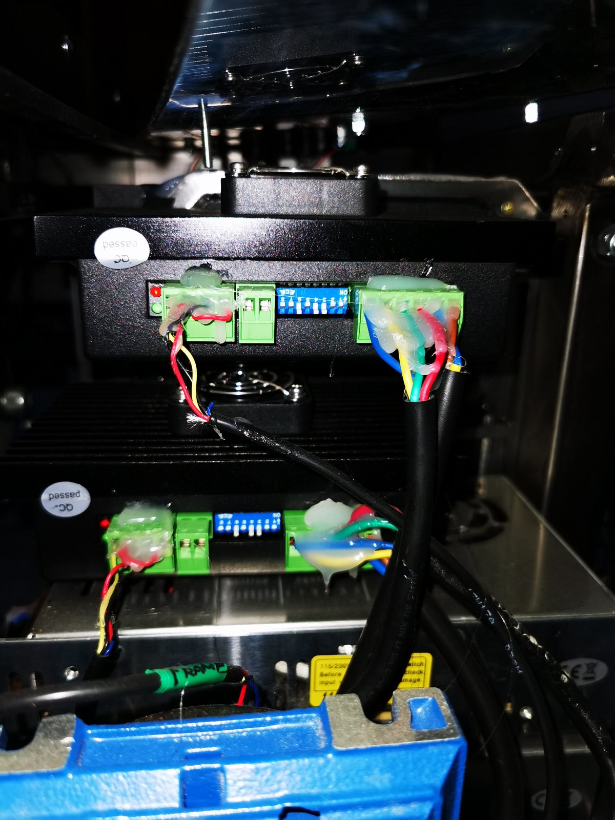

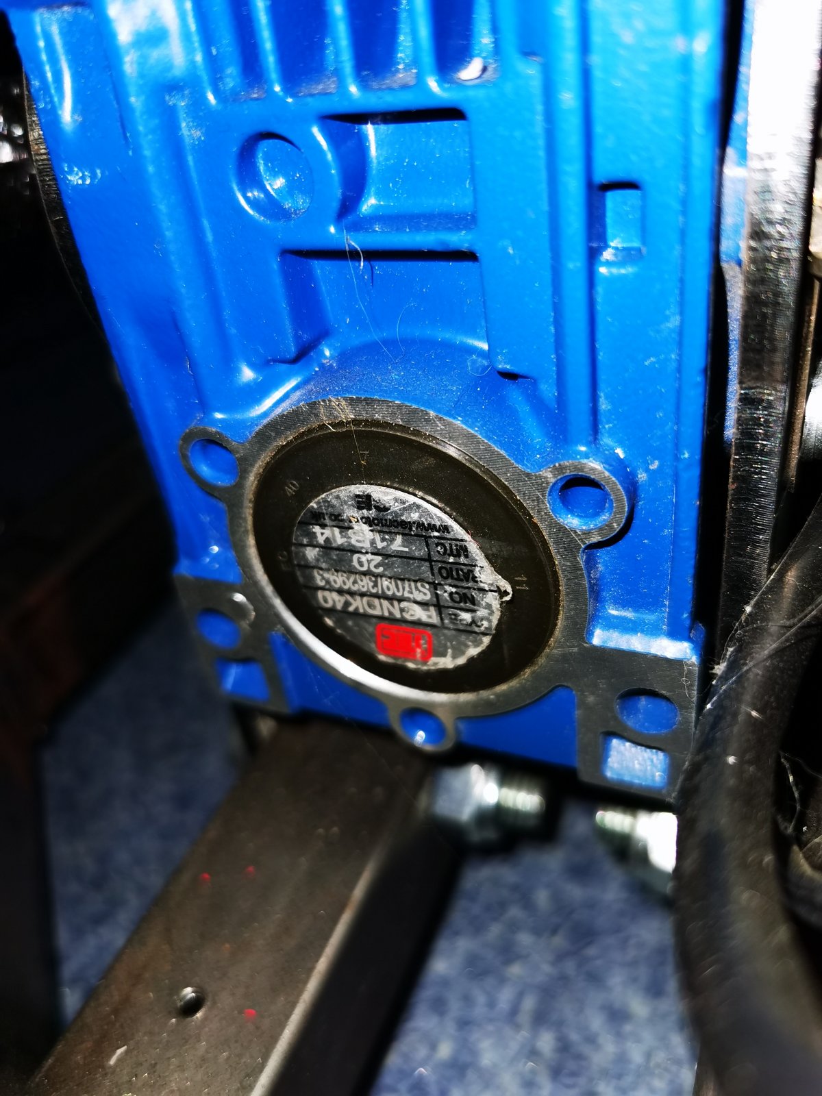

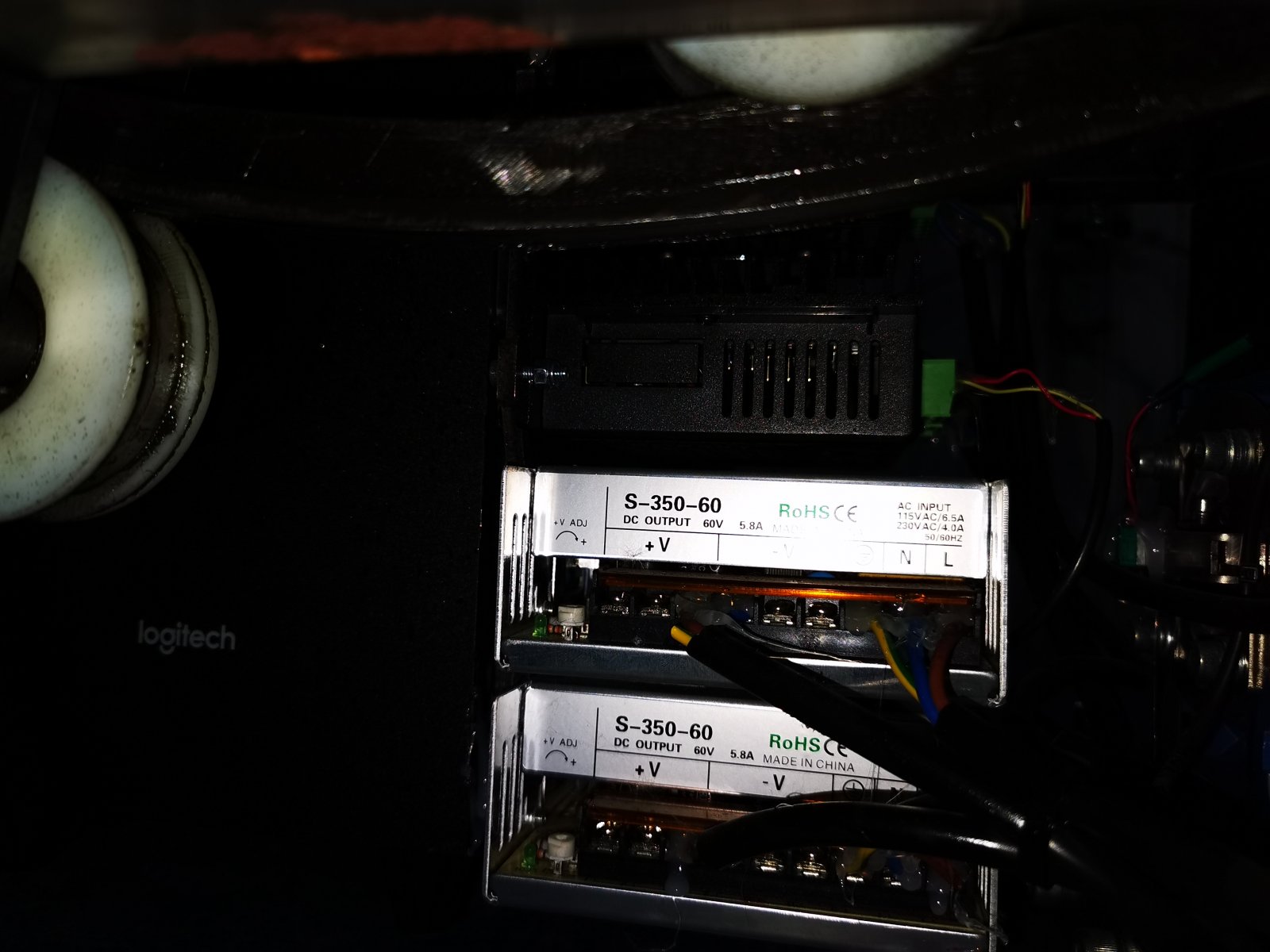

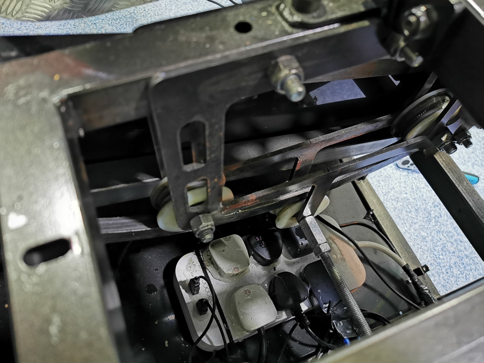

    I had some spare time to try and take pics of internals.
    It has 2 stepper motors and 2 gearboxes (with pots I asume). They are connected to individual gearboxes, control boxes and PSU. I'm not familiar with this parts.
    My goal is to transform this rig to something that uses the telemetry from the game. For now it uses the periferal inputs.
    Any ideas for parts needed?
    IMG_20200828_183010.jpg IMG_20200828_183030.jpg IMG_20200828_183230.jpg IMG_20200828_182947.jpg

    You need to remove the black boxes and see what they are
    It looks like you have a potentiometer so you need to find out how everything plugs together
    My suggestion is to find a driver for the stepper motors that can be controlled like an h bridge

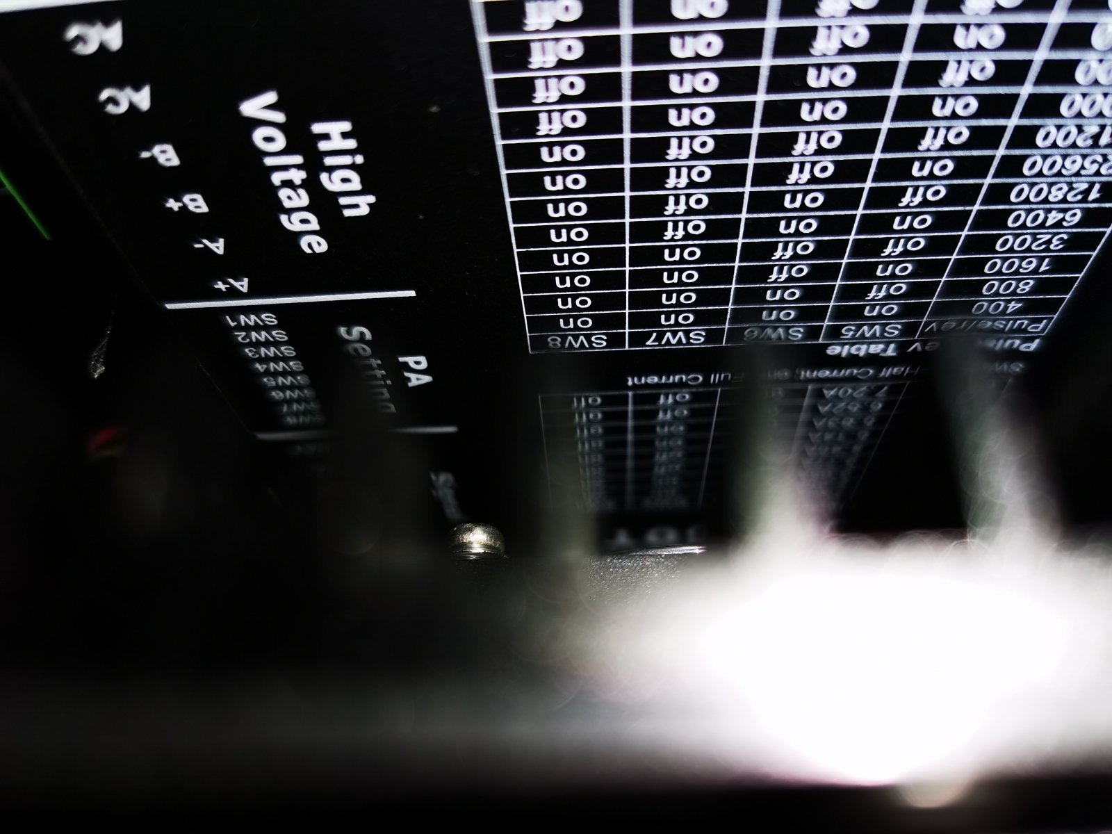

    I've managed to remove a bnoxcover and read the black nox labe and it seems like it's a DM860T Driver. This thing is put together very repair unfriendly, bolts and hot glue. I've downloaded the manual and I'm currently busy trying to understand it.
    Following
    my limited info I managed to gather, I would guess I only need an arduino to make read the telemetry and control the motors.
    If someone would point me to some more focused information would be great. The information is so spread out that I think I'll need a wee only to filter and to see what's important or not.

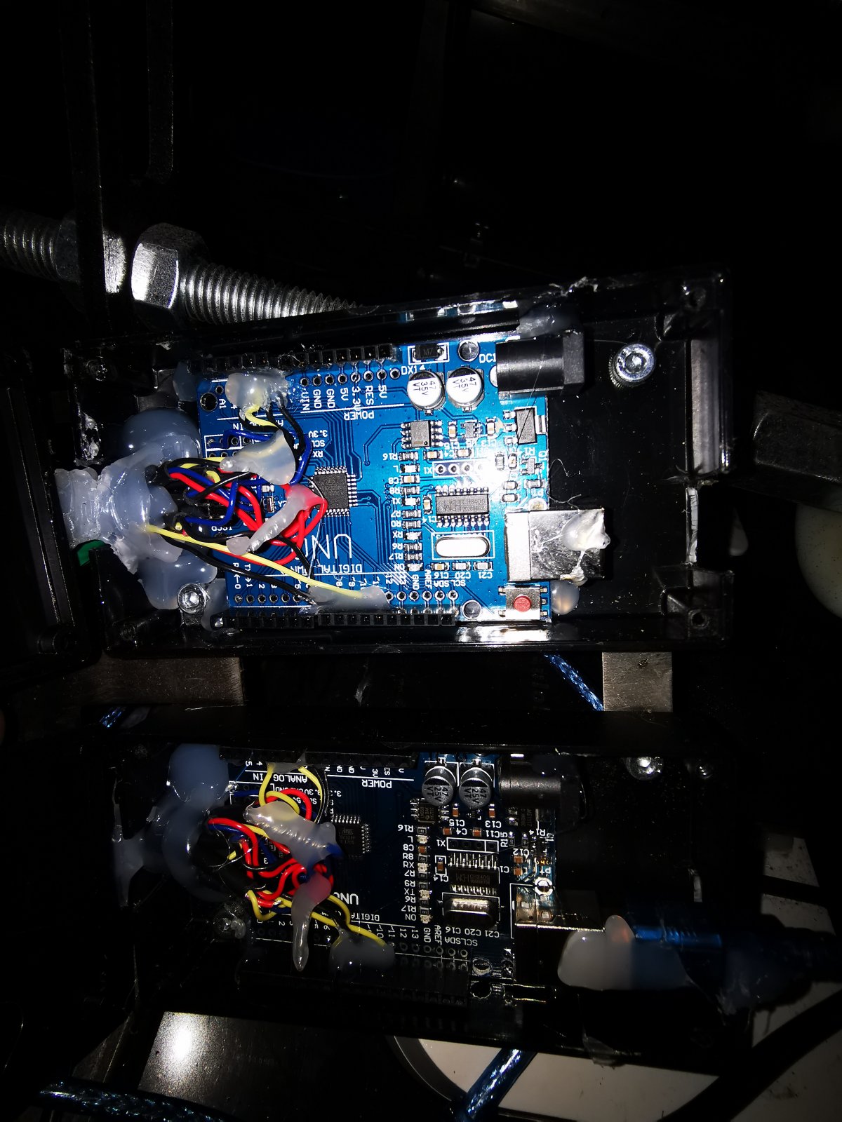

    Further digging and some hurt fingers, I found the two arduinos that control the motors. This POS is built like a sidewalk show, everythingis hold together by hot glue and tape. List price was 5700 euros....
    Motors have pots inside them.
    For now, the 2dof is functional and taking the input from the accessories, wheel and pedals. My kids are quite happy it with
    What are my options :
    1. Really dismantle everything and try to put new arduinos in.
    2. Try to read the existing ones and backup, change the void loop with a new one and go from there?
