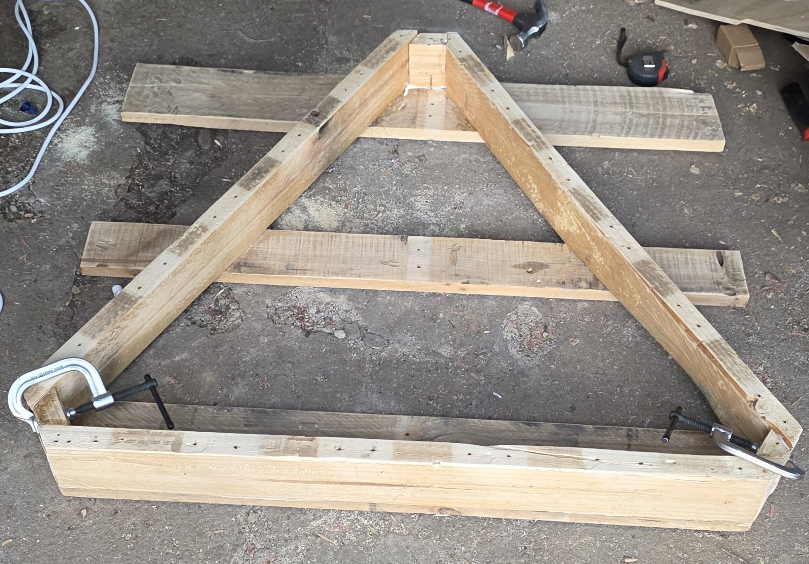

    • Base platform design and dimensions very close to original (mine was done from a wood pallet as i got one for free);

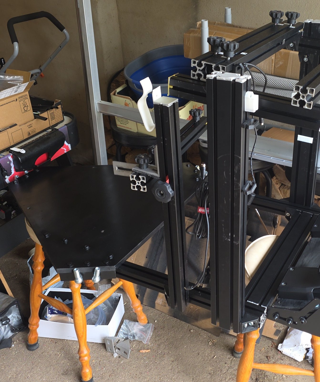

    • Top platform seat base which connects to base frame same as original, this then has been remixed to hold wheel, yoke, pedals, rudders, etc. from a fixed 8020 extrusion rig I had for the past years.

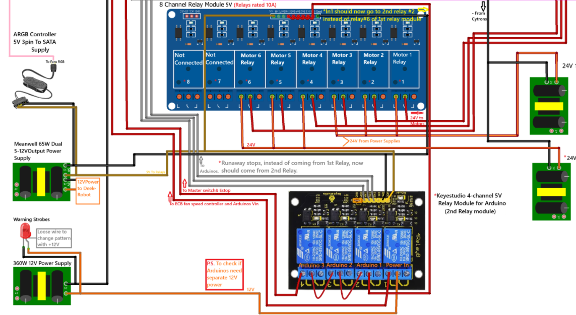

    • 1x 8-Channel 5V relay module from Aliexpress using 6 relays with individual power coming from the 24V power supplies and each relay going to each fuse holder => rectifier => Cytron => Motor (this setup is differnt from original, thanks to @Martwana idea and also due to bigger motors I am using bigger AWG cables which already singularly struggle to get in the relay COM so there was no way to fit 2 cables in 1 relay. Seems that @HyperJoel is going same route).
    • 1x Keyestudio 4-channel 5V relay module for controlling the fans and arduinos runaways (this relay module is additional to original design as the 8 channel relay have 6 relays in use for the motors). Idea thanks to @Martwana .
    • Below Electrical diagram of 2nd relay module added to original diagram (I have no idea if it is correct:grin, hope so)

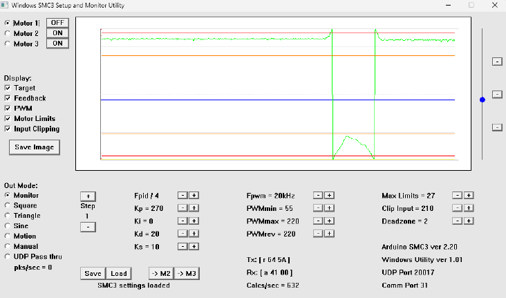

    4. Hall sensor calibration with min-max values in Arduino code done but some have quite ranges diferrences between the 2 motors on that Arduino resulting in a smaller range when choosing the final combined values to put in the code with possible overshooting / oversensibility when testing with SMC Utils. - To be investigated further (I will post my min./max values later to see if I can get any suggestions)
    5. When testing motors in SMC Utils by moving the motor arms manually, "Motor2" green line always goes in the wrong direction (so this happens to motor 2, 4 and 6). When moving the motor arm up the green line should go up and viceversa but is not the case with me for the 2nd motor in the set - Checked the magnets polarity countless time to ensure they are facing the same way but same issue.
    6. Did an SMC Utils check on a pair of motors and set the clip / cut-offs orange and red lines before the stop and after the stops respectively as instructed, when moving the motor arms manually they stay in range but connecting them to the power they just start spinning on their own breaking everything and it seems they always only move in 1 direction even if I thick manual in SMC and move the right slider the opposite way - To be resolved as I am 3D printing stops, motor arms and sesnor brackets twice daily.

    With 5 does reversing the wiring at the motor resolve it?
    With 6, is it possible the pot is 180 degrees out?

    With 5 I actually haven't tried inverting the motor wiring because when connected the first time to SMC Utils to adjust the clips/limits I did so with the motors unplugged to avoid it running away, I just moved the motor arms manually up and down till the stops.
    With 6, I tought and tried to rotate the magnet holder 180 degress but I still get issues (in this case tested bothy with motor unplugged and connected).
    Firstly by putting the arm in the center by hand and then firing up SMC the green line starts way off the center and moving the arm manually up and down the green line jumps around like if it is overshooting or going the wrong way, it looks simular to this screenshot but worse.
    Another member advised that the polarity should be the same across all motor pairs so I sticked to that.
    Actually another weird thing happend earlier. Had a pair of motors calibrated and green line stayed in range in both so I plugged the motors to check movement, at the beginning they were holding position but then when clicking on Motor2 to try it out the previous motor started spinning on it's own.

    The green line being way off suggests the pot is not correctly centered. Disconnect power to the motor, disconnect the pot from the motor, make sure the lever is centered, rotate the pot shaft by hand until it is centered in SMC3, then reconnect the pot to the motor making sure it remains centered, then reconnect power to the motor.
    In terms of the motor direction in the end it is no big deal, as it can be reversed using the DIR settings in SimTools.
