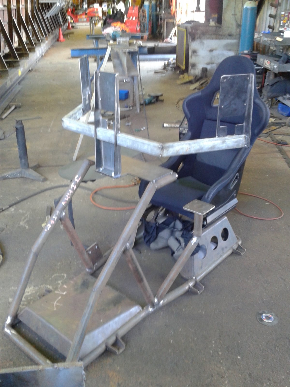

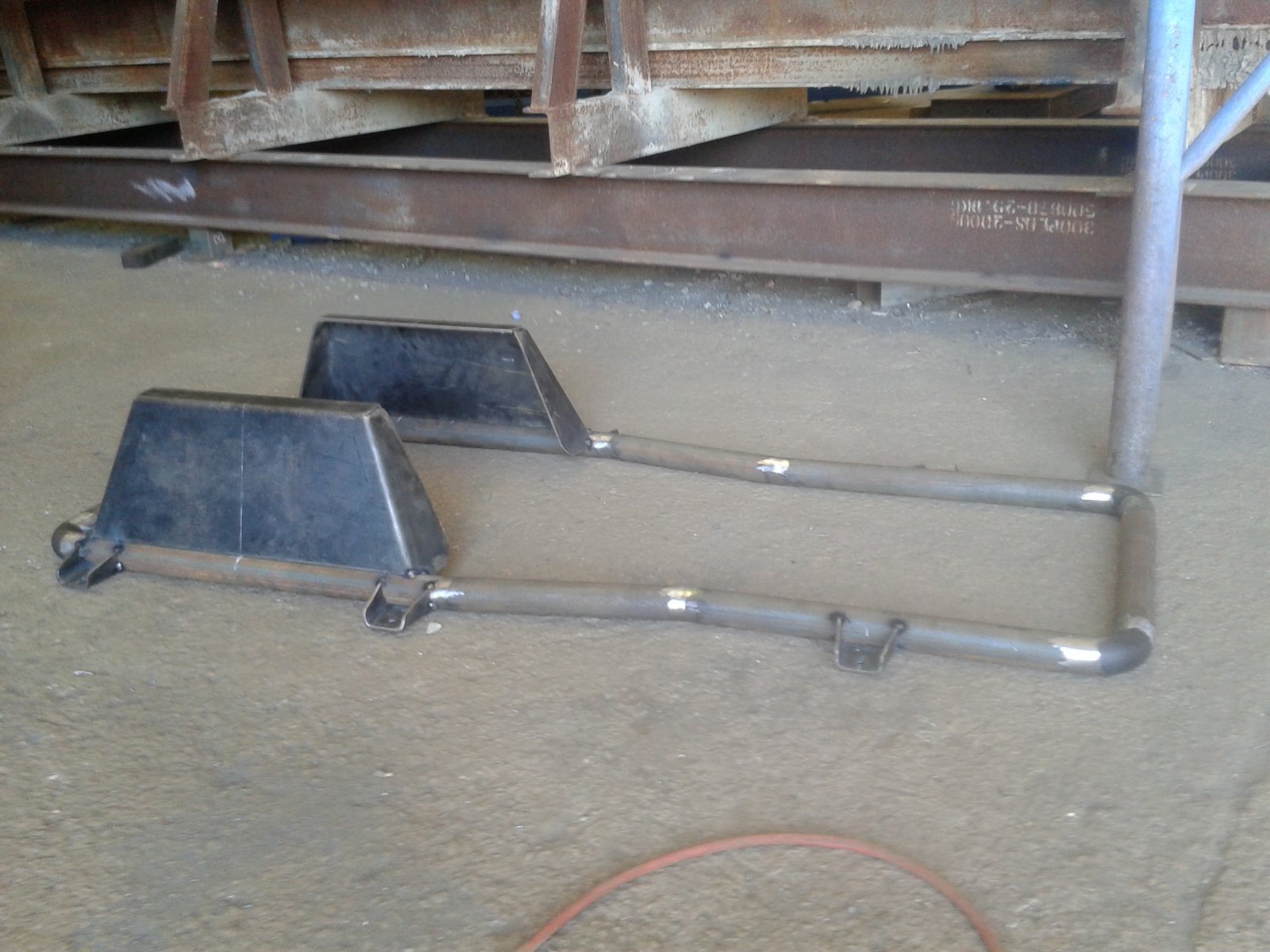

    Hello going to start building a 2 dof wiper seat mover for sim only race iracing purchased Arduino + Motomonster, 12v 47A 575Watt server Psu, 2x single turn Cermet 10k linear pots not sure what wiper motors i need want to make compact under the seat style mover. Looking around people use 2x power supply's 2x motormonsters I think i will need to use those 60:1
    High torque motors so if some one could confirm if i have got the right electrical equipment to run suggested motors that would be great !!!

    Nice job on the static rig you have already build @jimmytm3!
    You will have some choices depending on design and your weight plus the seat. If it is a compact design like @bsft's Desk Racer and you are under 100kg with a light race seat then you could use these motors and 25:1 boxes: https://www.motiondynamics.com.au/worm-drive-motor-12v-24v-200w-180-rpm-20nm-torque.html
    If you are 'big guy' then consider the 60:1. number 15 in the chart further down the page: https://www.motiondynamics.com.au/1...ve-geared-motor-200w-21-256-rpm-7.5-45nm.html
    You have the basis of what you need for the build and there is plenty of arduino info and code in the FAQ section: http://www.xsimulator.net/community/faq/arduino.6/category
    I suspect that if you have specific arduino related questions then gurus like @Pit, @RacingMat, @eaorobbie and others can help out.

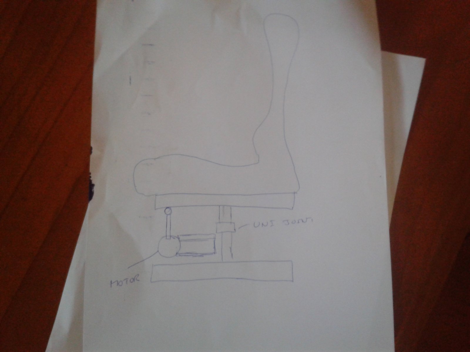

    Before finalising what motors and PSU power is needed can you supply a rough design. It can be as simple as a photo of drawings on paper but would give members an idea of what you plan so we can advise more specifically.

    crap drawing but you should get the idea going to cut off whats holding my seat and make something like that

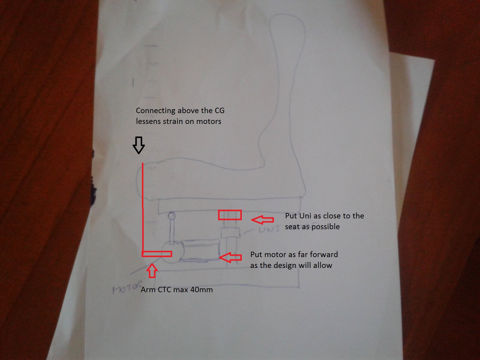

    Some initial suggestions below.
    You can connect under a seat but over the CG is less strain. If you go under the seat CTC should be less, about 25mm is the practical minimum as it really starts to limit the possible motion volume.

  12. bsft

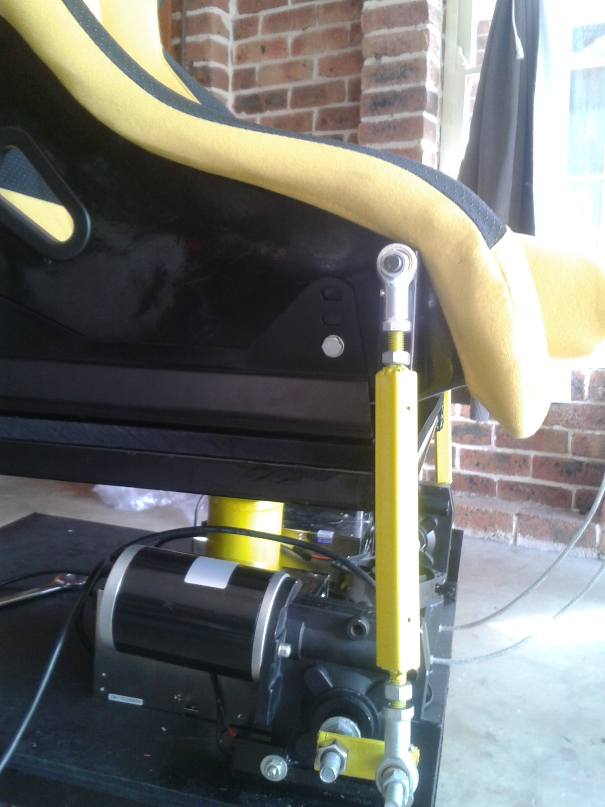

    Yes those motors will do just fine, thats what I use on desk racer. And I found out 25:1 boxes will move 110kg person no problem.
    For power supplies, get 2 and make sure they are rated at 40 amps each. One for each motor.
    For control boards, suggested is JRKS as they hook up easy, require no coding and perform very well.
    And follow noorbeasts suggestion of the design, it will work a LOT better than motors underneath.
    See how I made extra steel mounts up the side
    I can tell you this from experience what will work better.

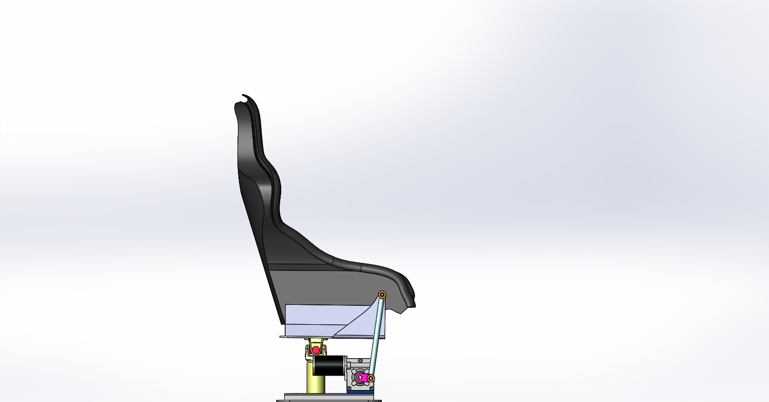

    motion assembly.JPG Have drawn this based on BSFT desk racer i think uni is a bit far back and ill move motors a bit foward any suggestions? the rhs at the bottom is the seat sliders as i think they will be handy to get in and out of my rig

    I would suggest making the base board longer for stability. It is easy to under estimate the power of the motors we use. If you turned the sim on as depicted and the motors snapped from an unloaded to center position it would lift the back of the base off the ground. Mine is 500mm, which I would consider minimum, longer would be better.

    The plan is to weld the base to my static rig that should be o.k ? the whole thing will be fabricated out of 6mm pl
