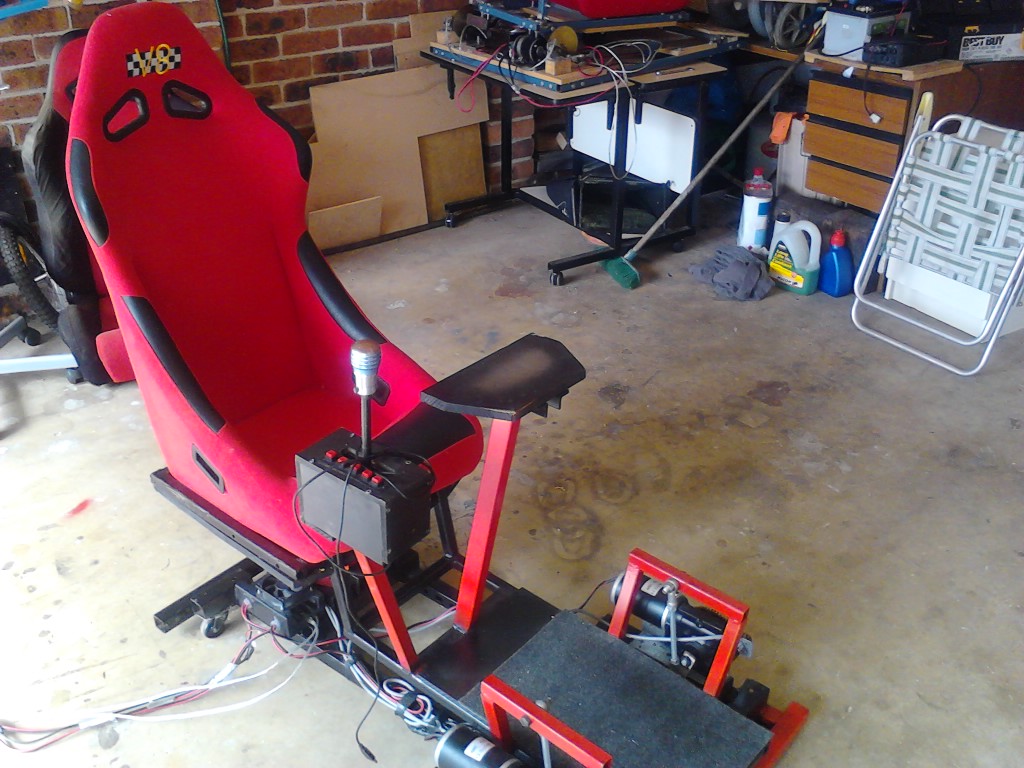

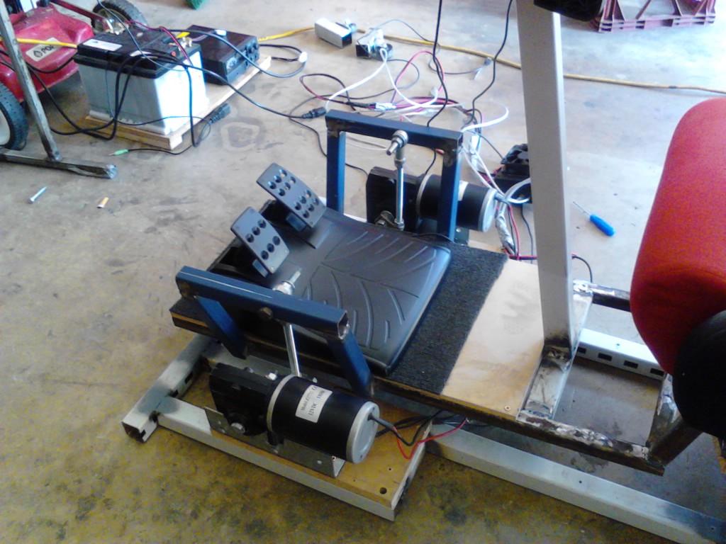

  2. bsft
    For compact design, if its a full frame, theres a way you can do that.
    Mounting the motors near the feet with a frame mod is the most compact and efficient way for a full frame
    165617350_frontmotor2_122_500lo.jpg 403452763_IMG_20120414_114631_122_338lo.jpg
    However, @noorbeast ride http://www.xsimulator.net/community/threads/dx-racer-compact-simulator.5866/page-6#post-66960 is a full frame variation of my desk racer
    We use 12v 200 watt worm gear motors, , noorbeast uses 60:1 boxes on his for extra lifting power as the motors are closer to him that my foot motor. I used 25:1.
    we both use the Pololu JRK 12v12 http://www.pololu.com/product/1393
    Just ask as you need to.
