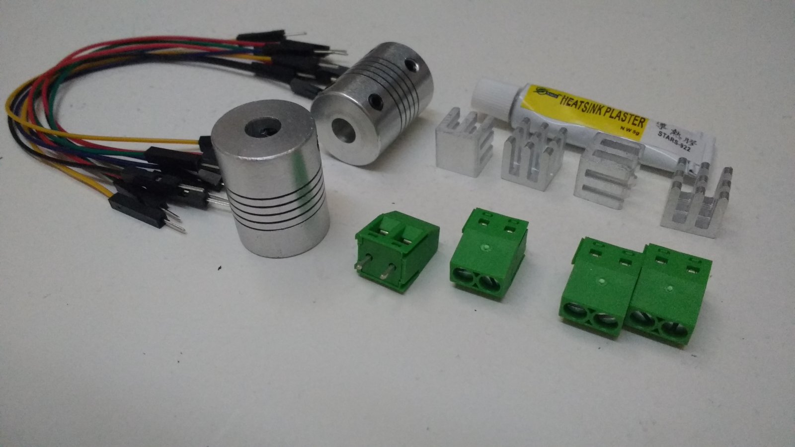

    Hi there!

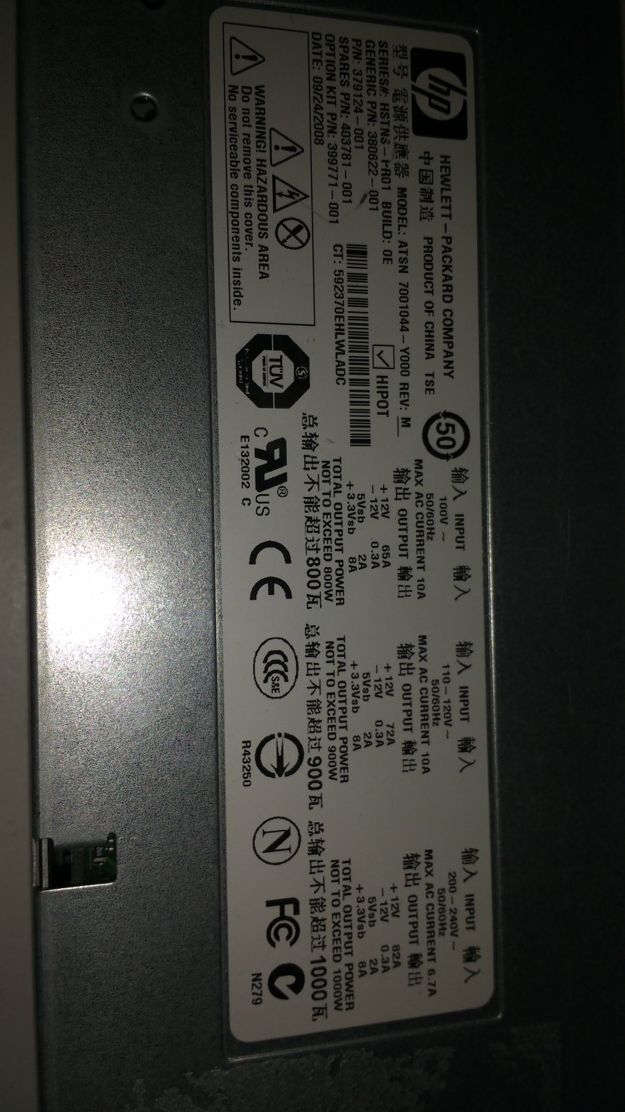

    Today i've started assembling the first parts of the Arduino system and modded the power supply.
    Power Supply Unit is a HP ATSN-7001044-y000 Rev: M (12V-69,5A +-)
    Cost New 20,- euro
    IMG_20180703_231243289.jpg IMG_20180703_231326819.jpg IMG_20180703_231450306.jpg

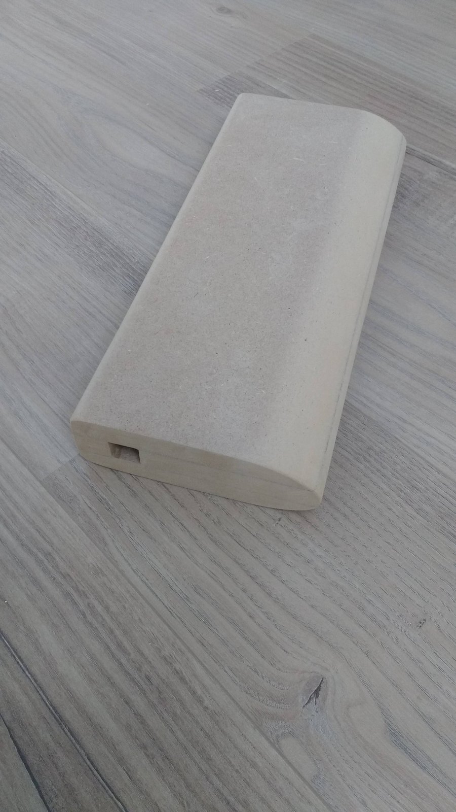

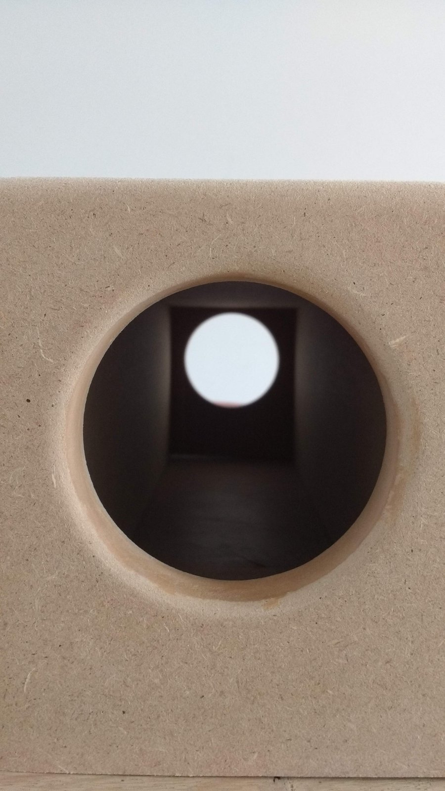

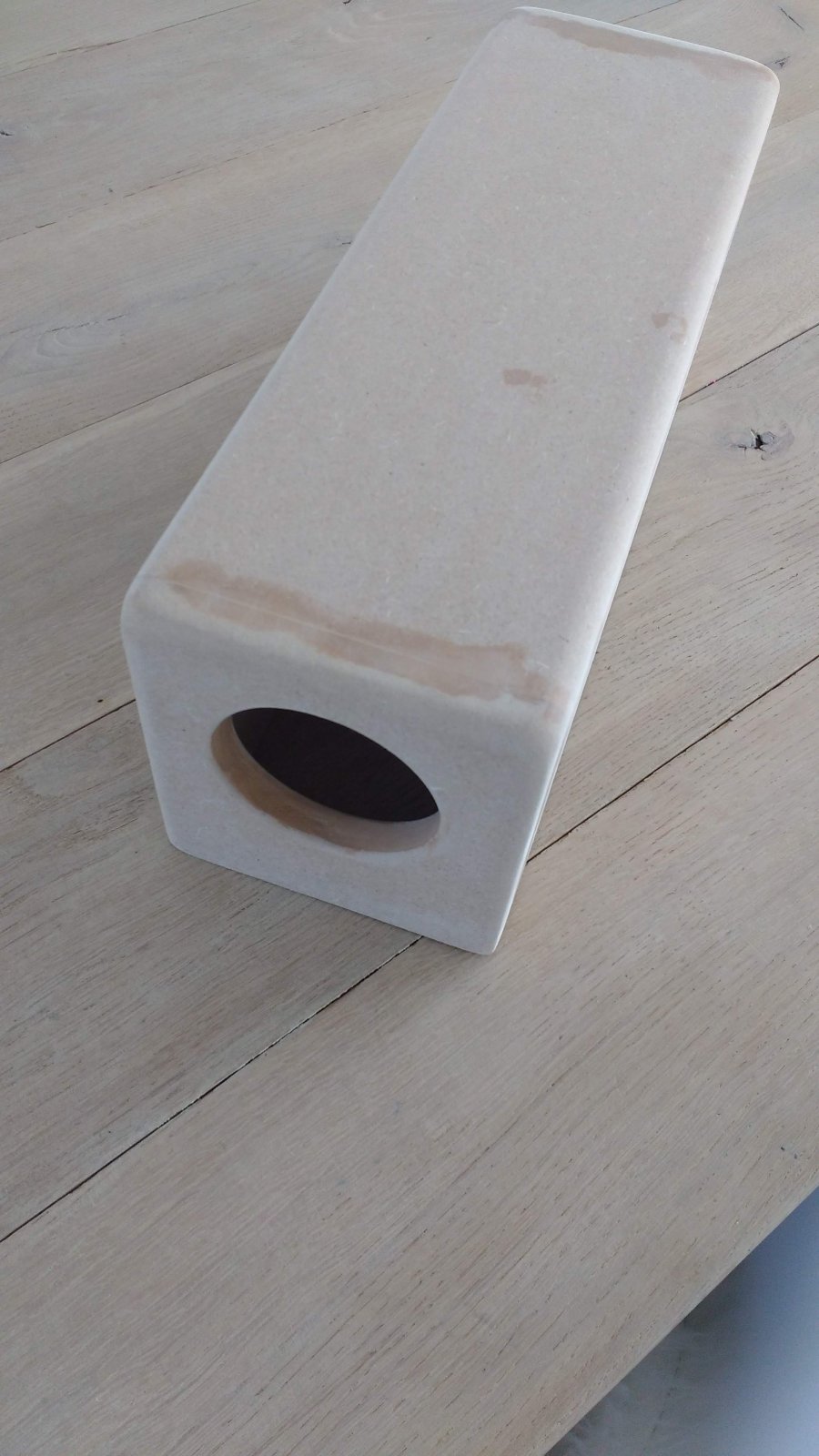

    Started with some MDF for covering the PSU and the Arduino.
    Working with the sanding machine for a couple of hours now on 'the windtunnel/psu-cover''
    I'll post some pictures tomorrow before I start painting it for the first time.
    Ready for some paint!

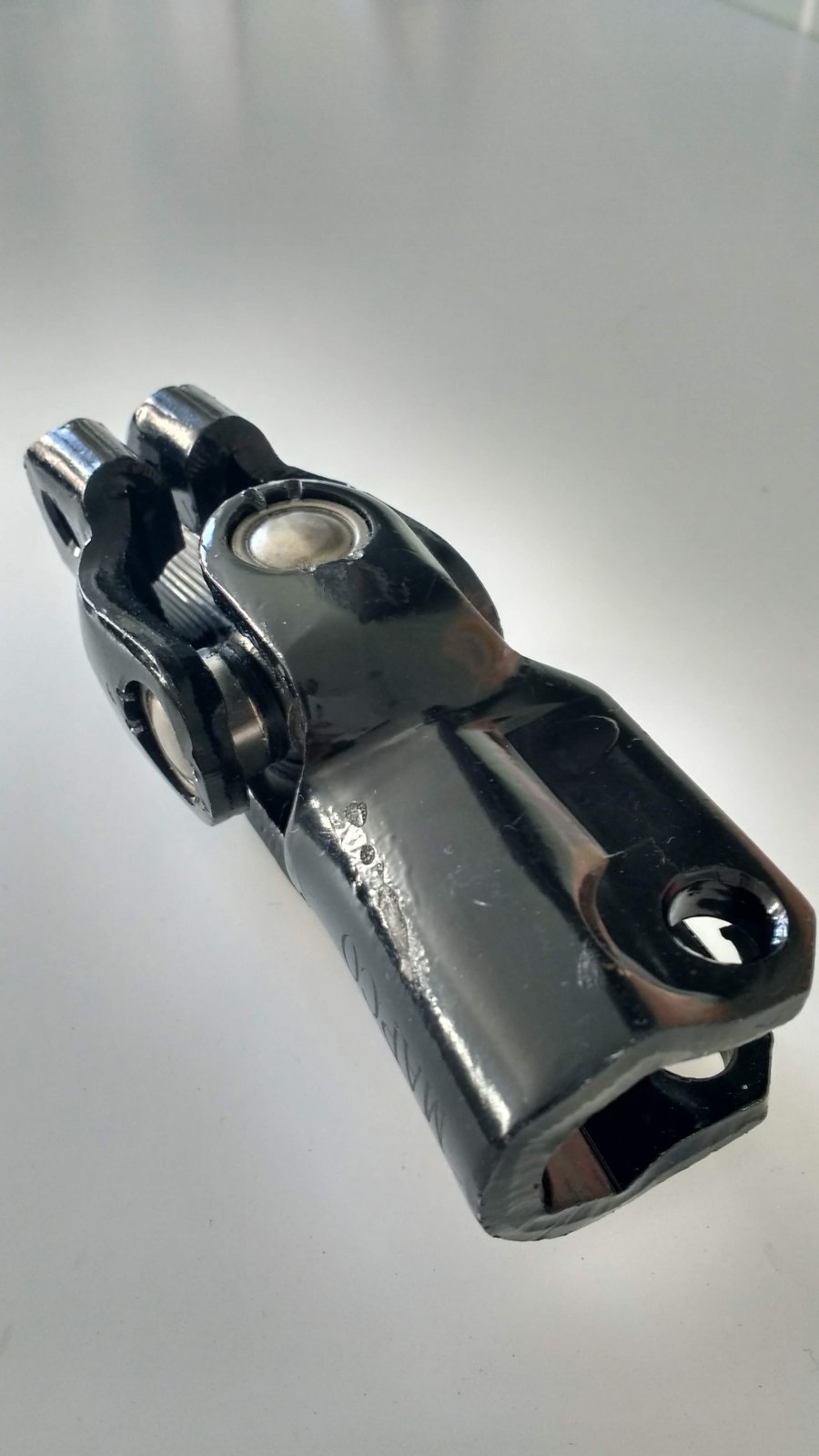

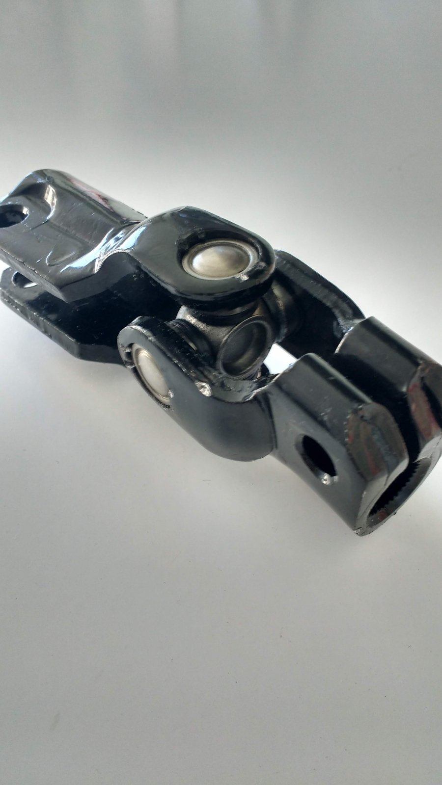

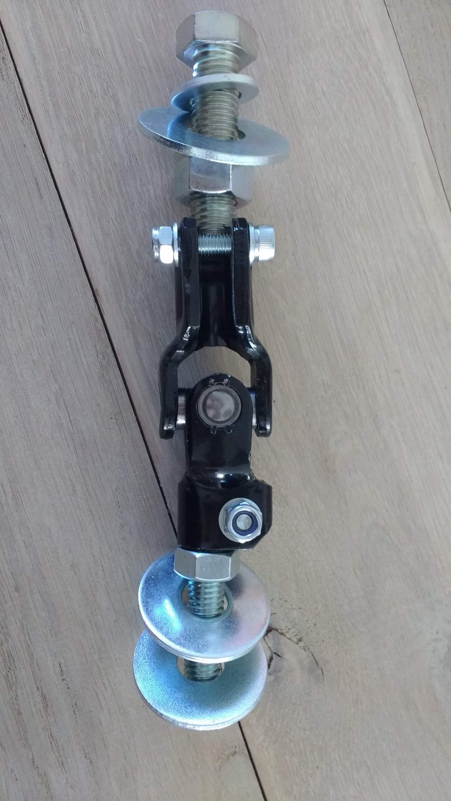

    Good job! The cardan is the spare part of a car? Please tell me how it continues

    It's part of the steering column of a car .
    Online for about 12 euro google it: ean 4043605041081

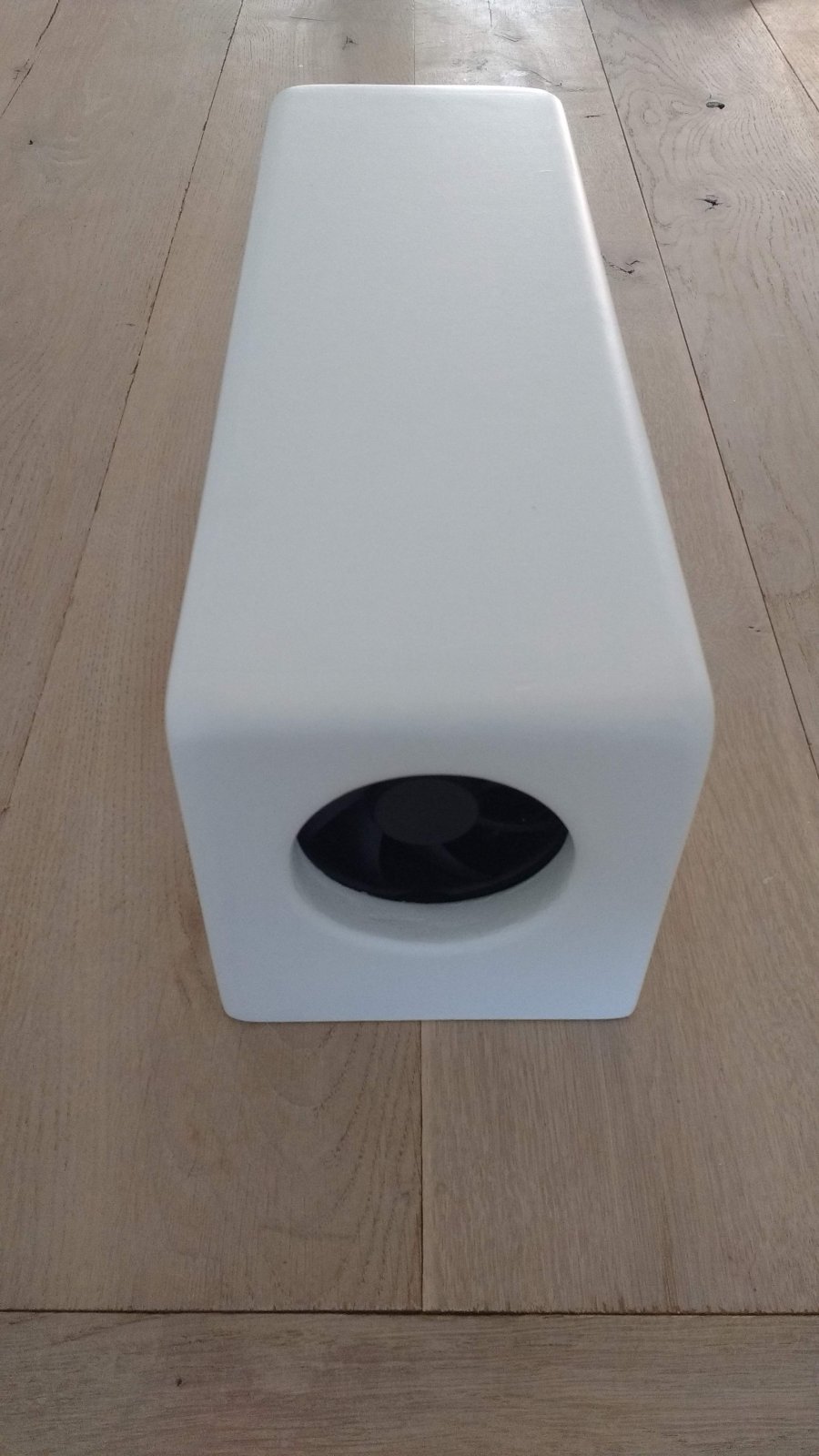

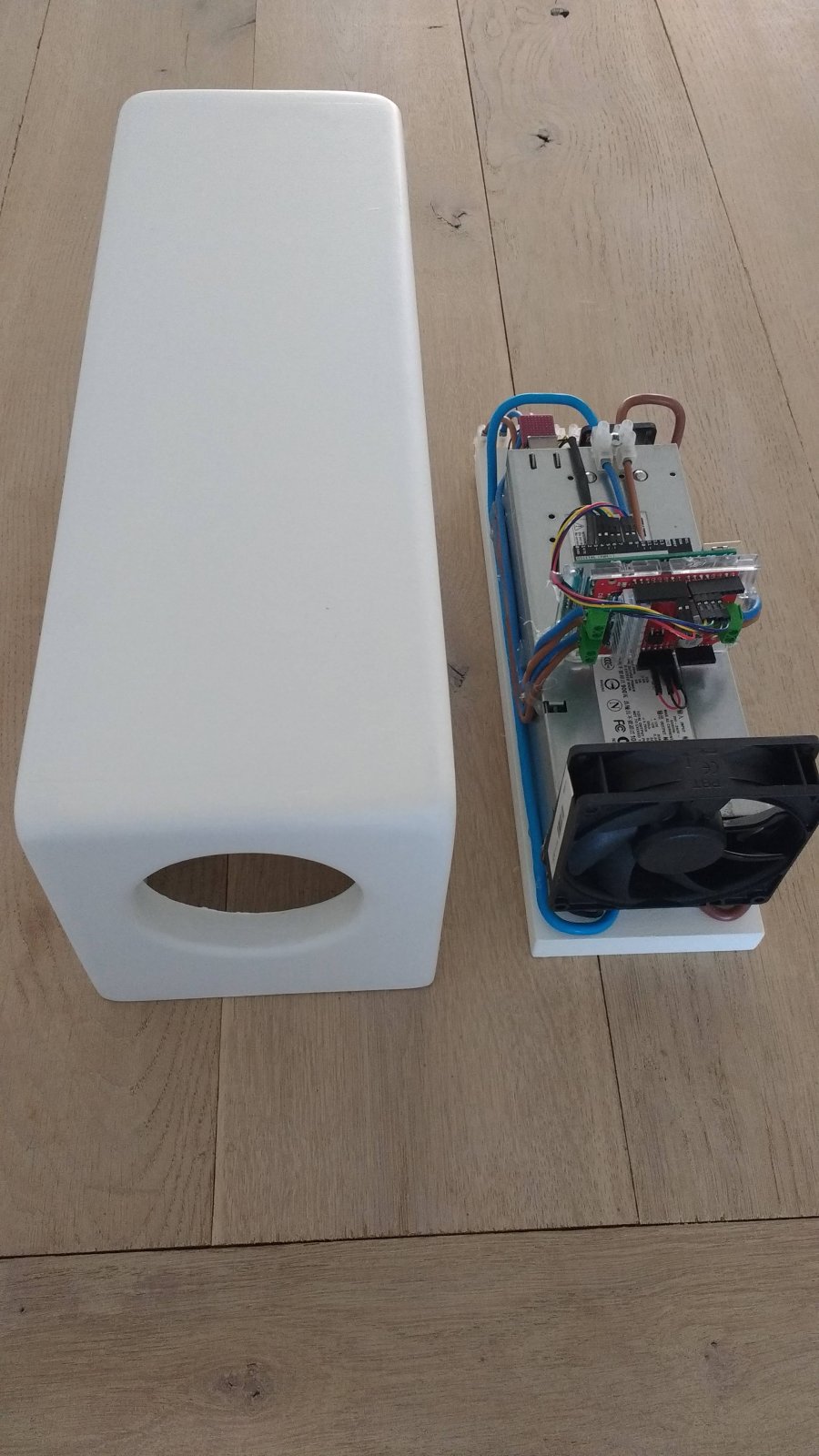

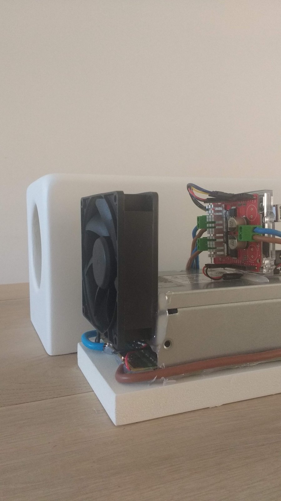

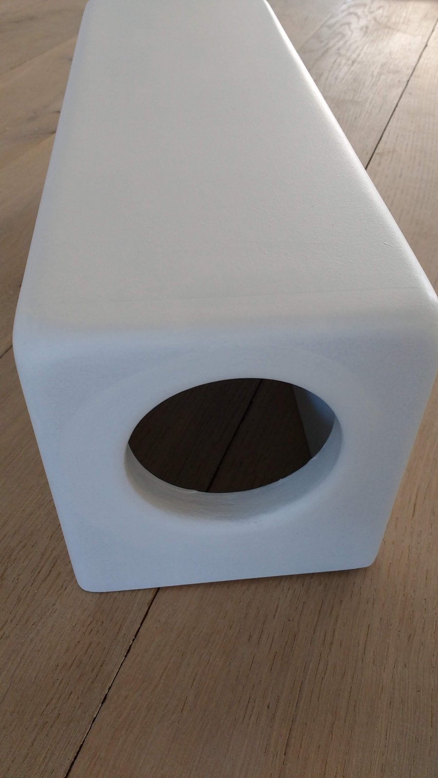

    Finished the paint job on the 'windtunnel' - placed the electric stuff inside the windtunnel for fitting

    The 'Electric stuff'

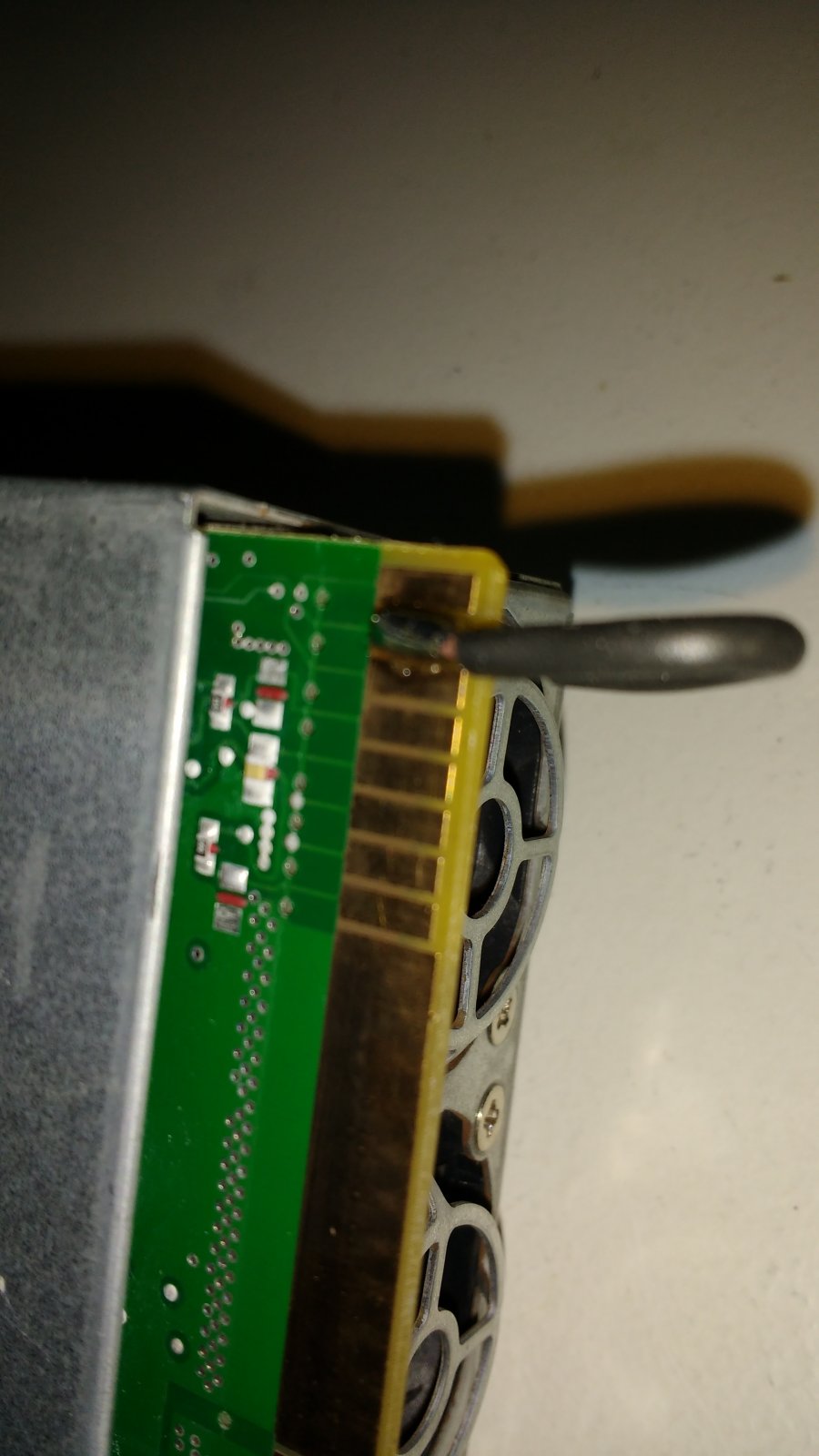

    +88 / 0 / -0

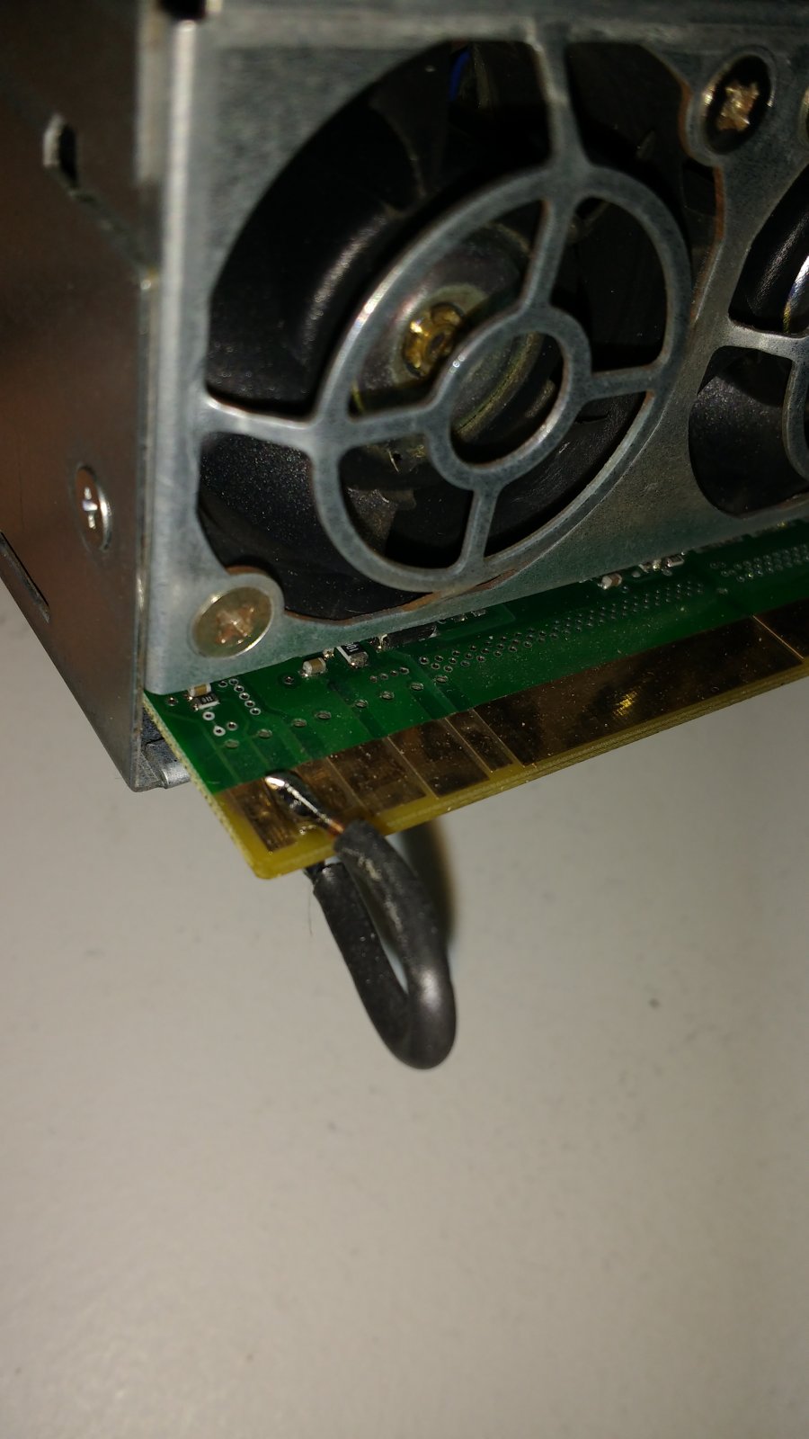

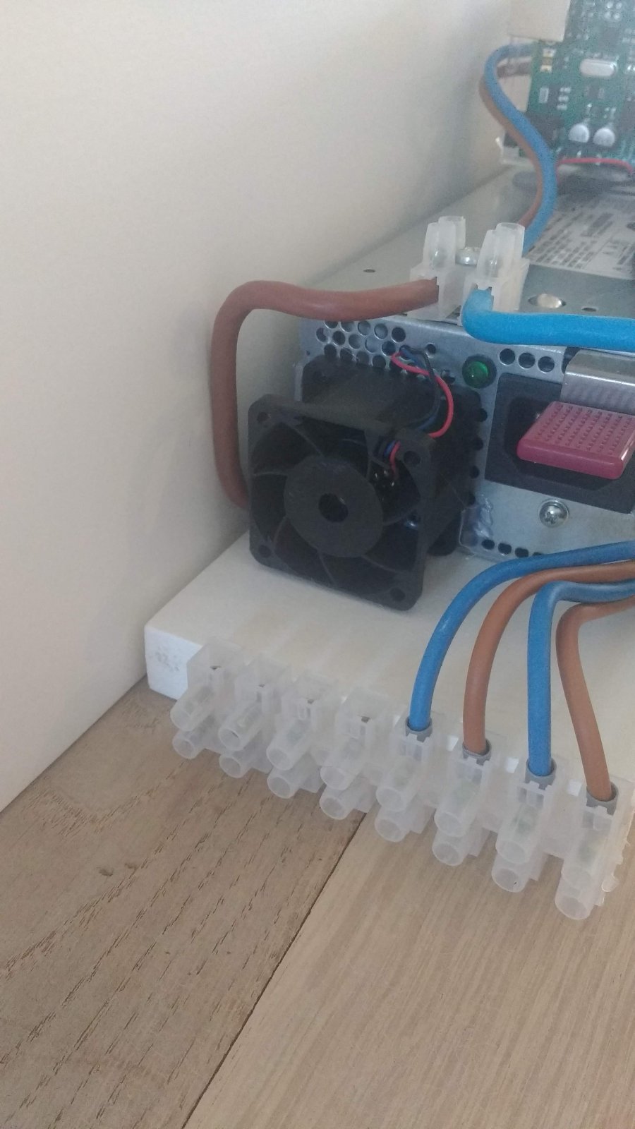

    The 120mm fan blows air partly through the SPU, which is a push-pull configuration because I took the the 2x40mm fans out the front/inside and mounted 1 on the back of the SPU (trashed 1 fan for noise cancelling)
    Normally this SPU will shut it self down ones it's sees 1 fan is missing or broken.
    I thricked the GPU by soldering the 2x3 outputs wires on the PCB SPU parallel that way 1 40mm fan is fed by two outputs.

    The 40mm pulling fan which thricks the PCB of the PSU (this sounds nerdy )

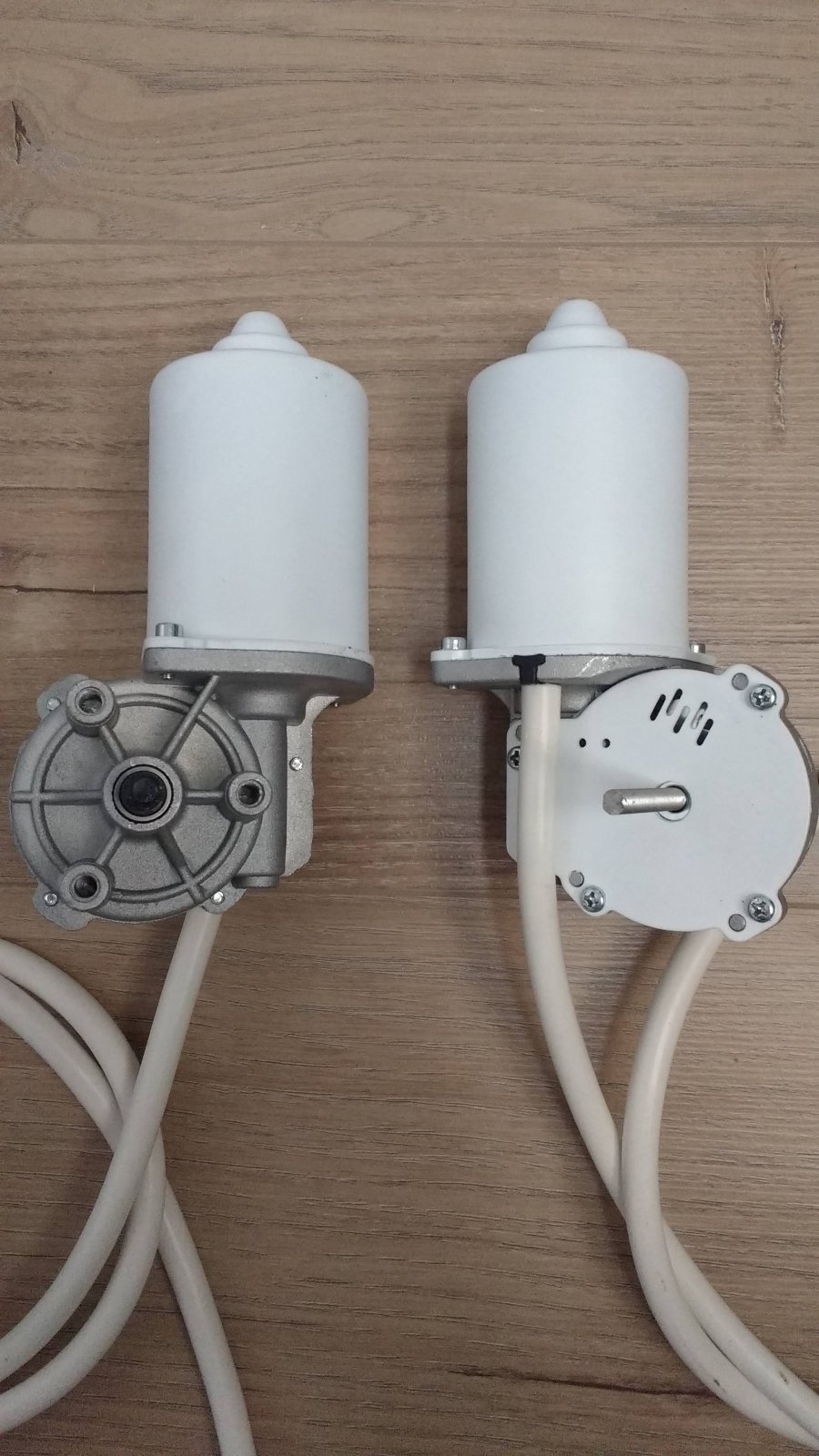

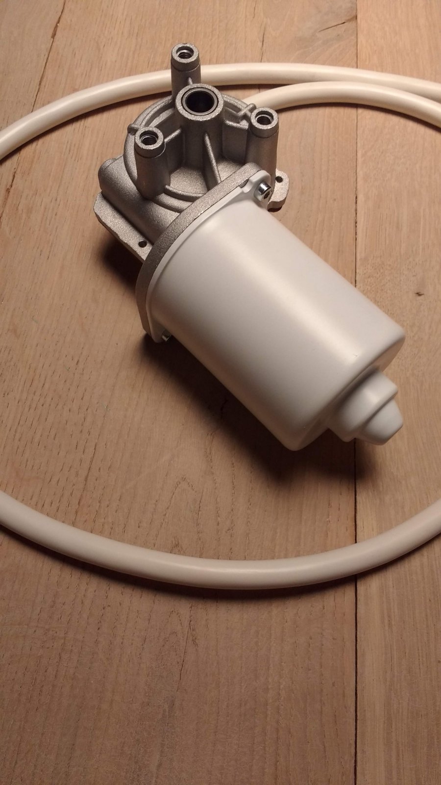

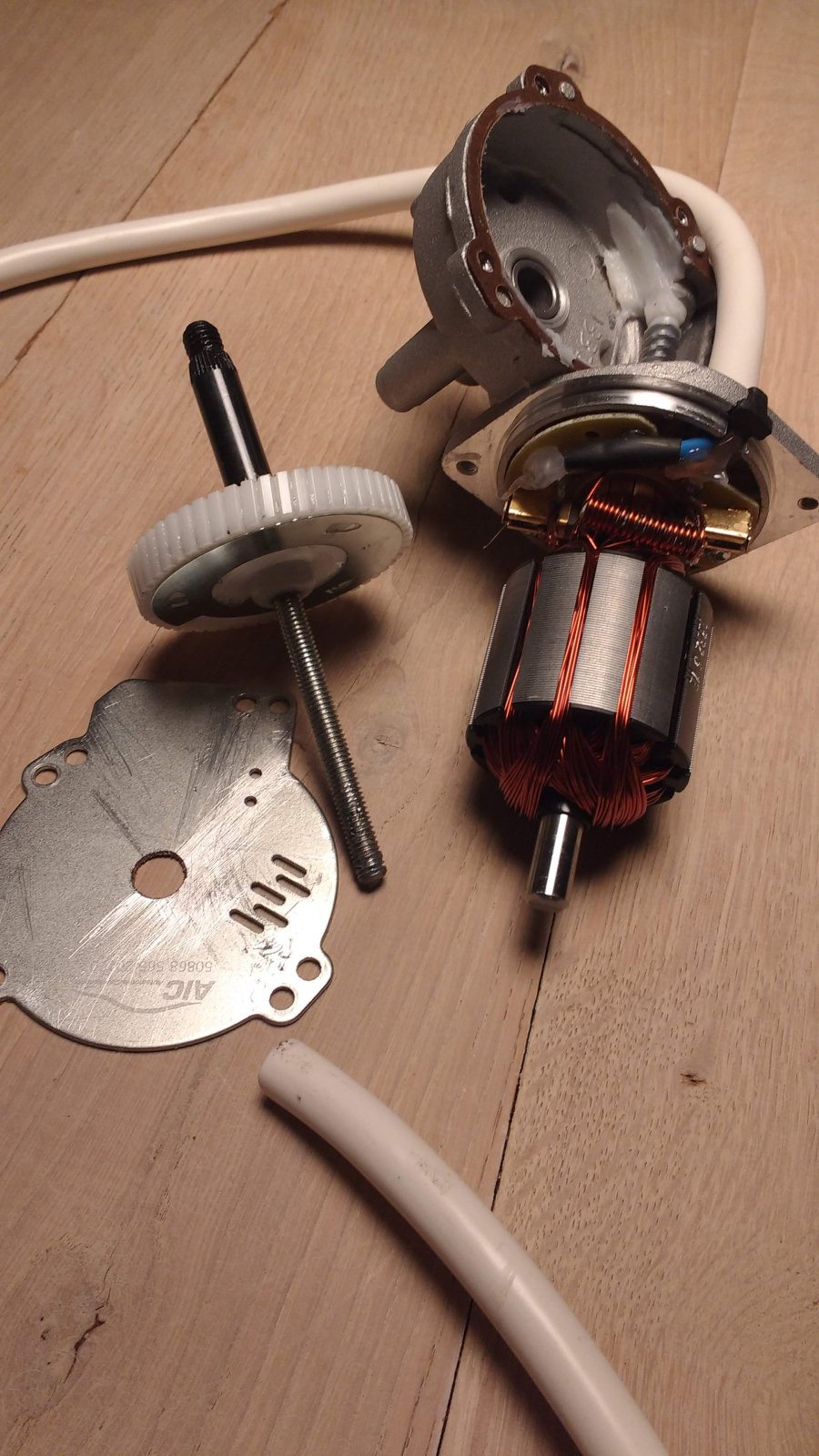

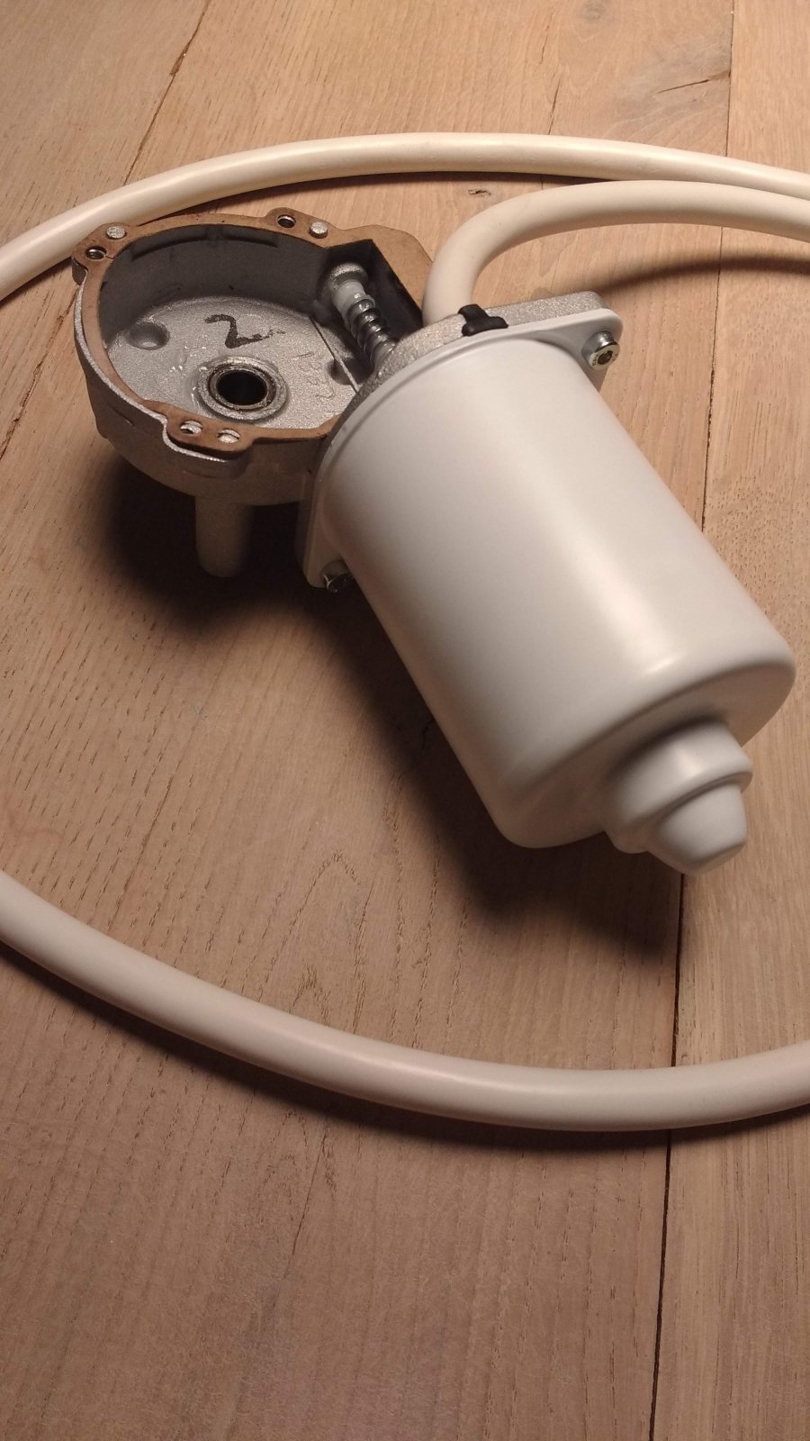

    Fixed the internal wiring of the motors and installed the freshly painted white caps.
    Tomorrow i'll be assembling the two moters after a little paint job on the sides of the motors.

    Finished the paintjob on the motors

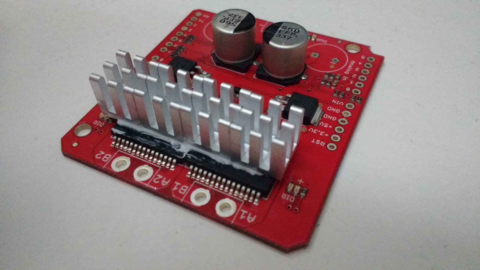

  16. Poo9jao
    Poo9jao I Like all Mod
    Jul 22, 2018
    9
    Coppy Machine Service Engineer
    Bangkok Thailand
    146Coins
    What part h-bridge
  17. Brie69
    Brie69 Active Member
    Jul 1, 2018
    100
    Beverwijk
    2Coins
    +88 / 0 / -0

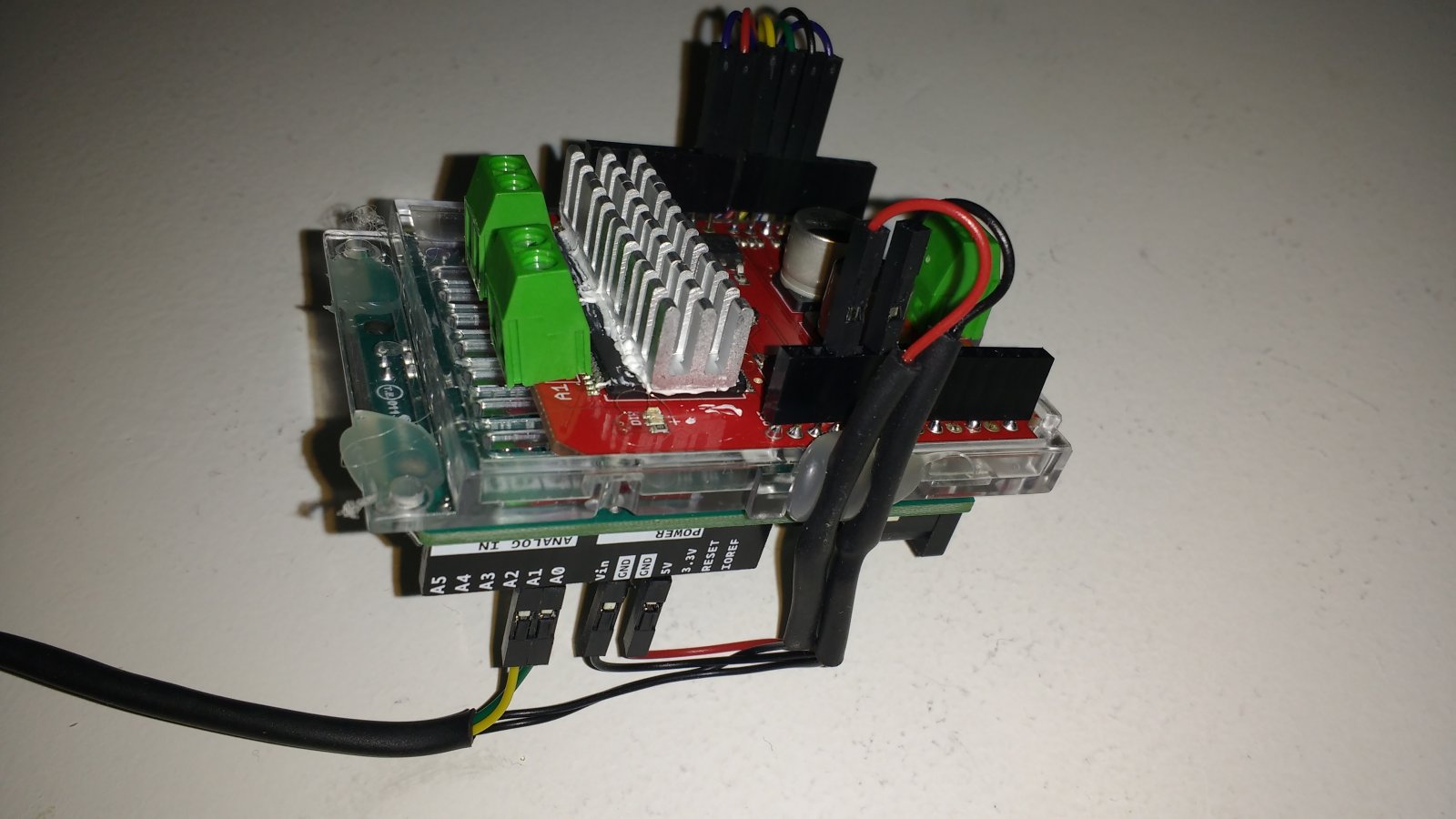

    Arduino Uno Rev3 - ATmega328
    SparkFun Monster Moto Shield

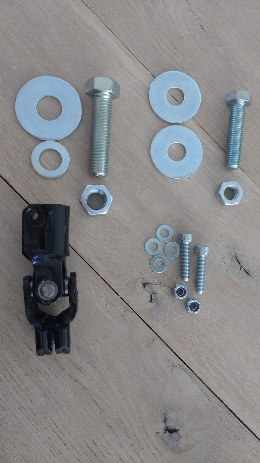

    Using M18x70mm and M16x70mm on the steering column joint (EAN: 4043605041081)
    Hand-tight..just for the photo

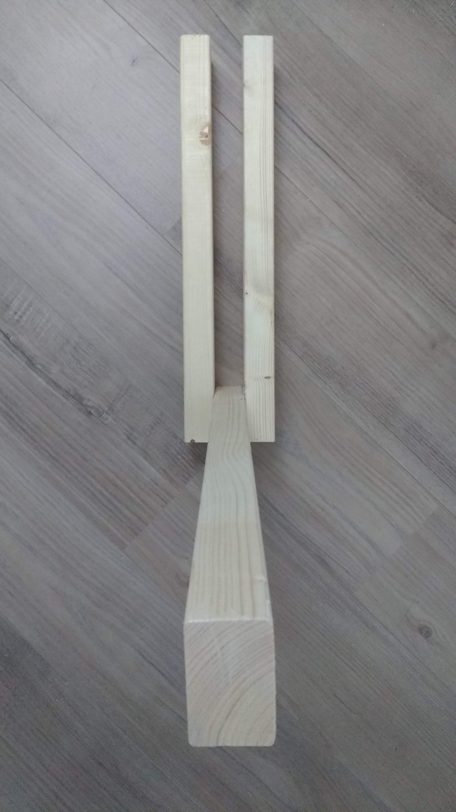

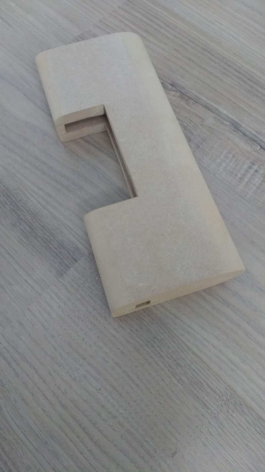

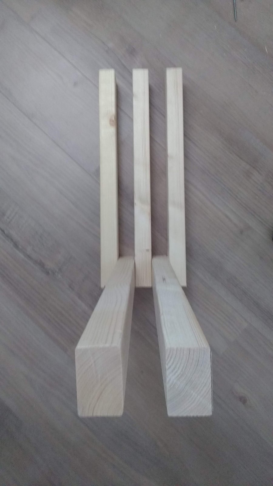

    Started with the wooden frame for underneath the seat
    Merged with the other one...like so

    Working on the backwing that will 'hold' the arms of the motors
    This the part where the M12 threaded end goes through
