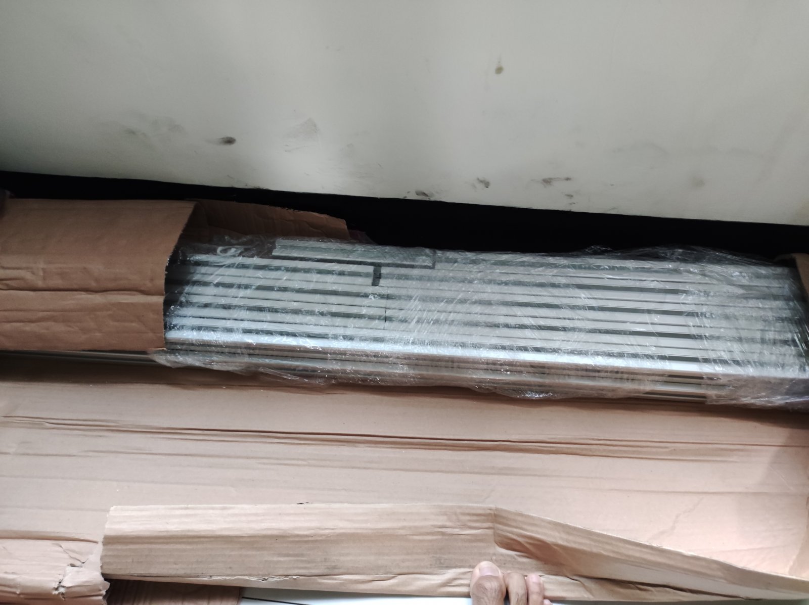

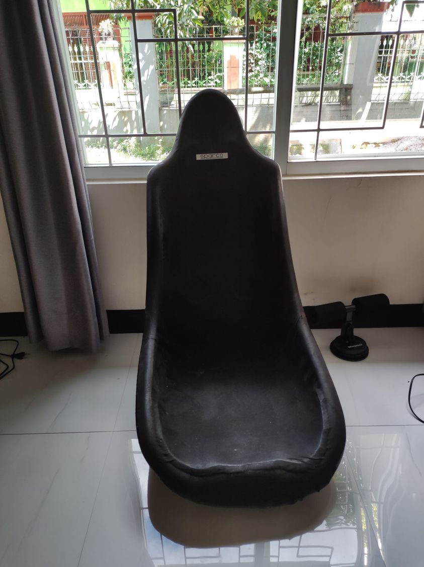

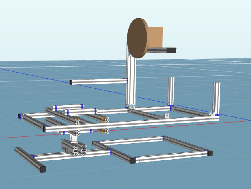

    Hi everyone, this was my first creation in this field and I wanted to share to you all, and hope I can get some feedback cause I just started to gather some material to build my own 2dof motion.
    and I thank everyone in this community for all the tips they have posted. I would never have been get the courage to start it without everyone's help.

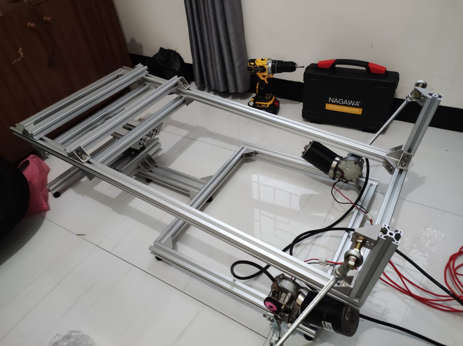

    I started with the design and gather some material that I need.

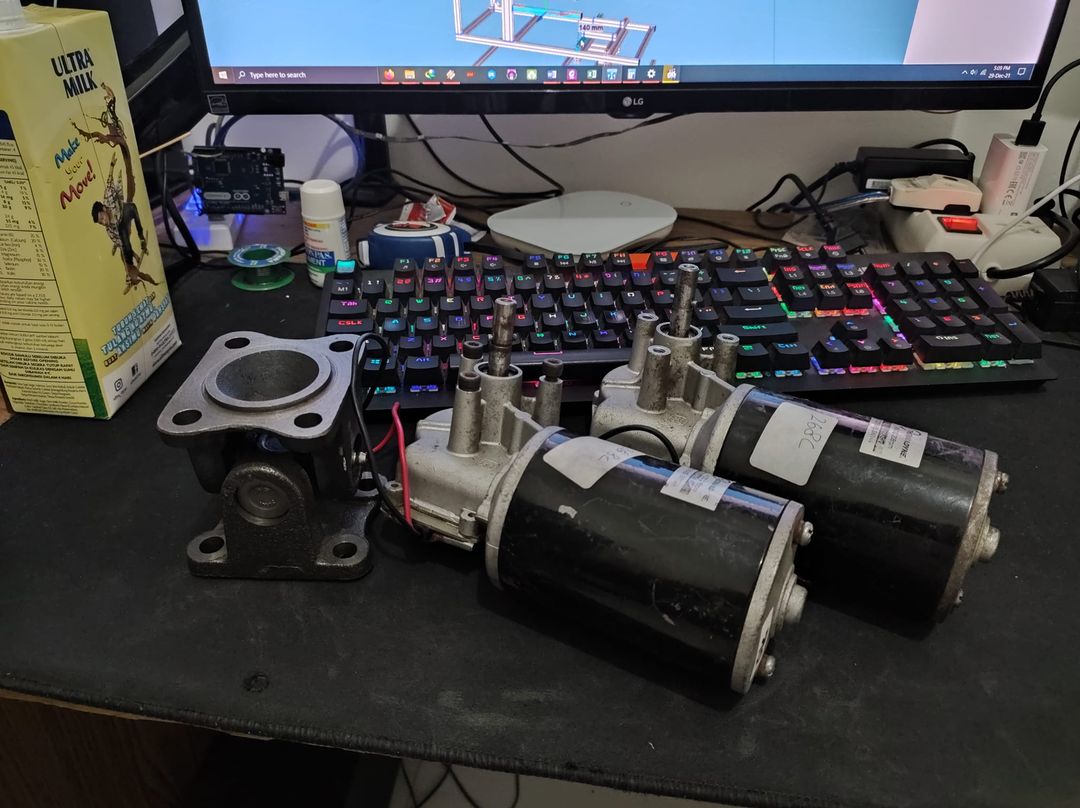

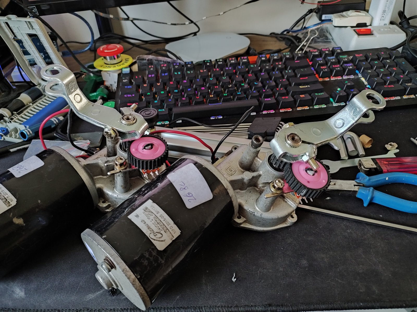

    used cheap motor, the seller say it was a wire feeding mechanism dc motor, hope it can do the job.
    just get this morning, 2 IBT-2 , and arduino uno.
    And I'm gonna use this aluminum size 3030 and 3060 to build my rig. hope I can utilize its rigidity and light weight.

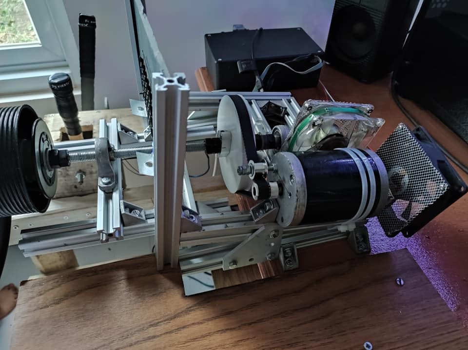

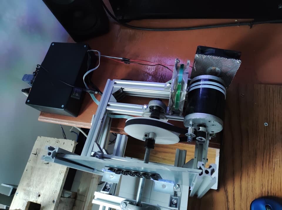

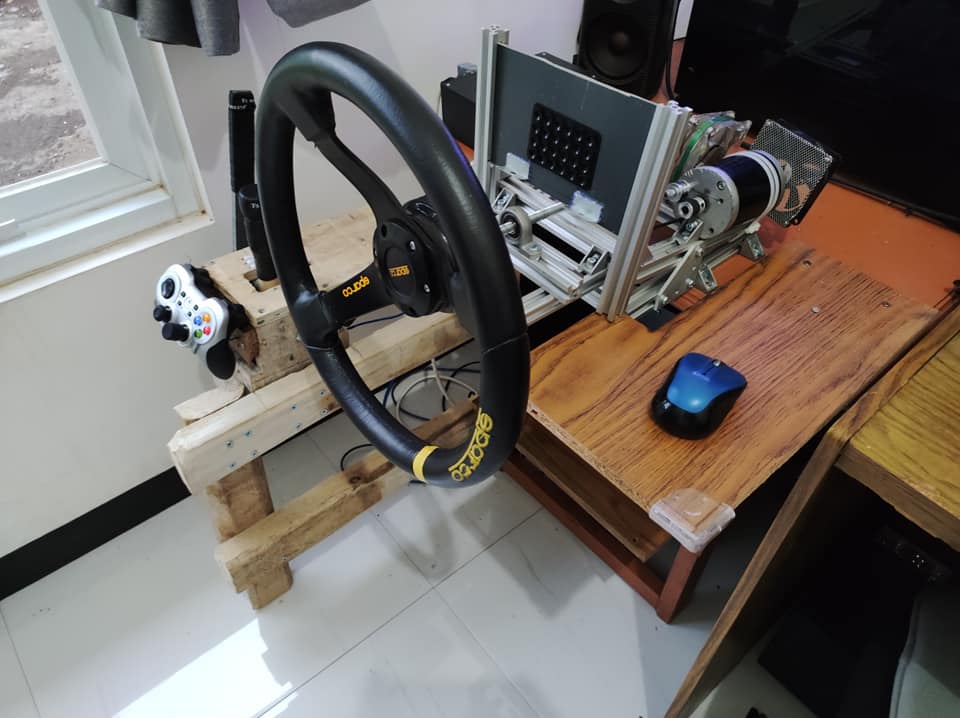

    and I want to share my finished DIY wheel, using STM32 and EMC pro utilities for the software.
    254150465_10220002810405555_4396739802029504693_n.jpg 254164660_10220002810045546_4940877150525695908_n.jpg
    still a long journey, and cant wait till all of the material arrived.
    sorry for my english. feedback is very welcome

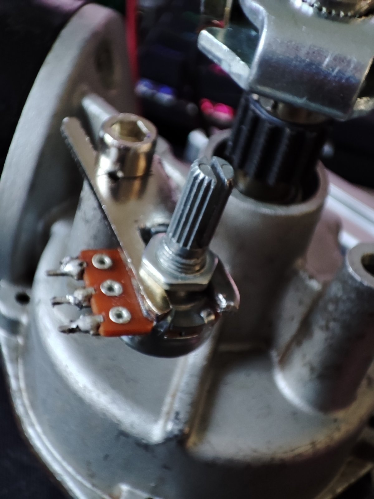

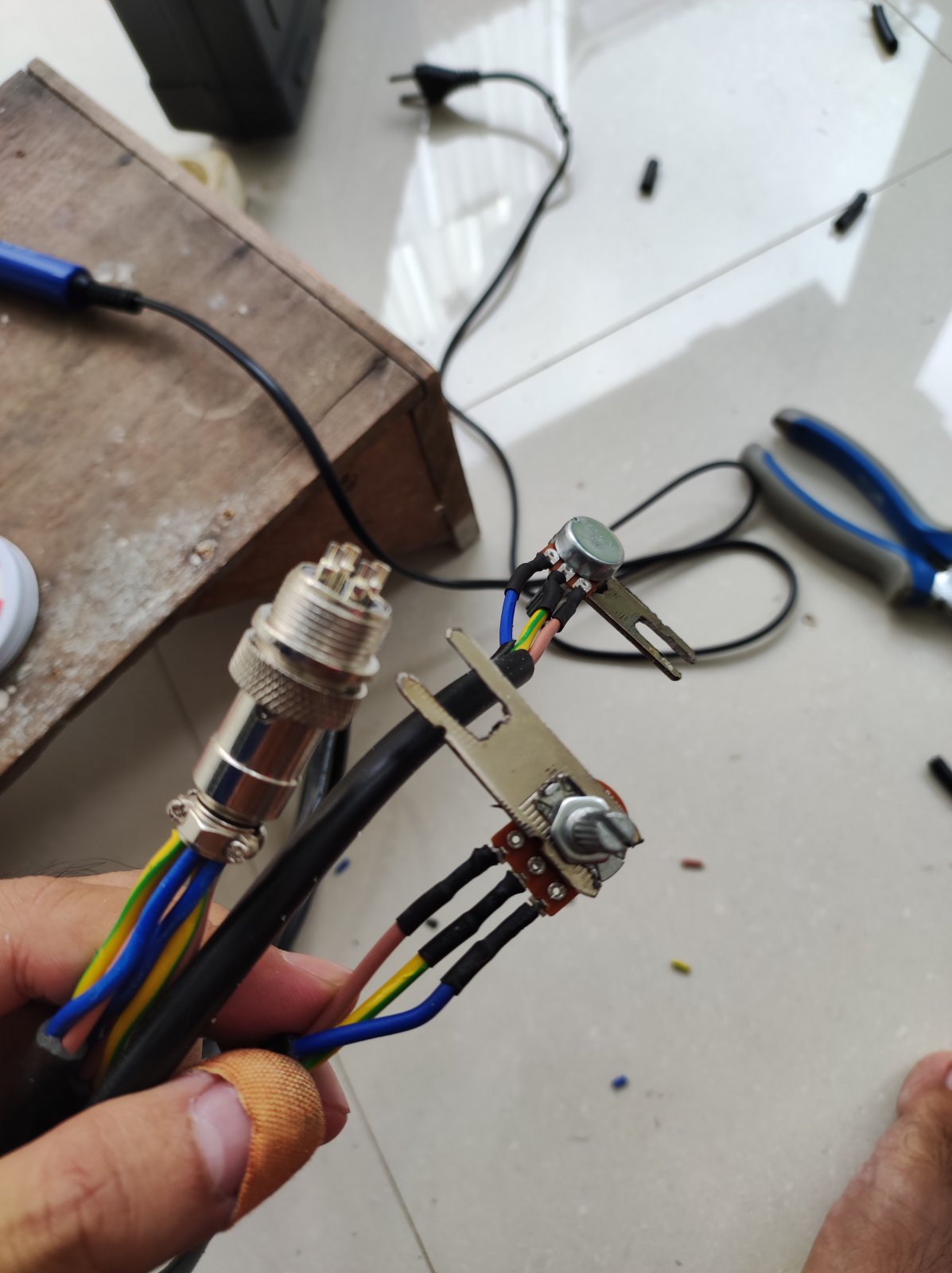

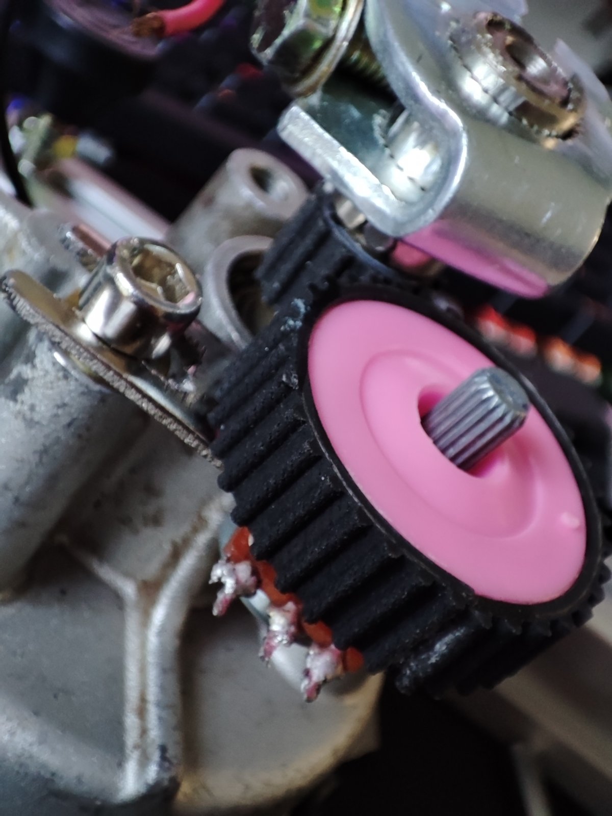

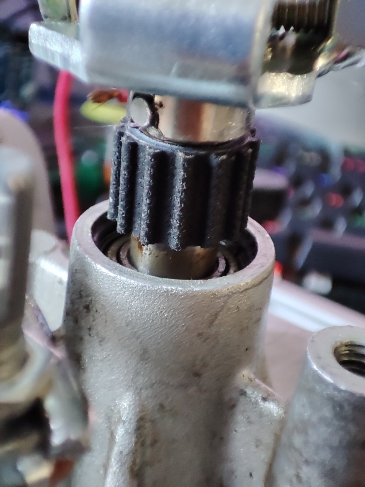

    little update, done with the potensio mechanism.
    use my son's cheap lego wheel and wrap it with Timing Belt HTD3M. works great.

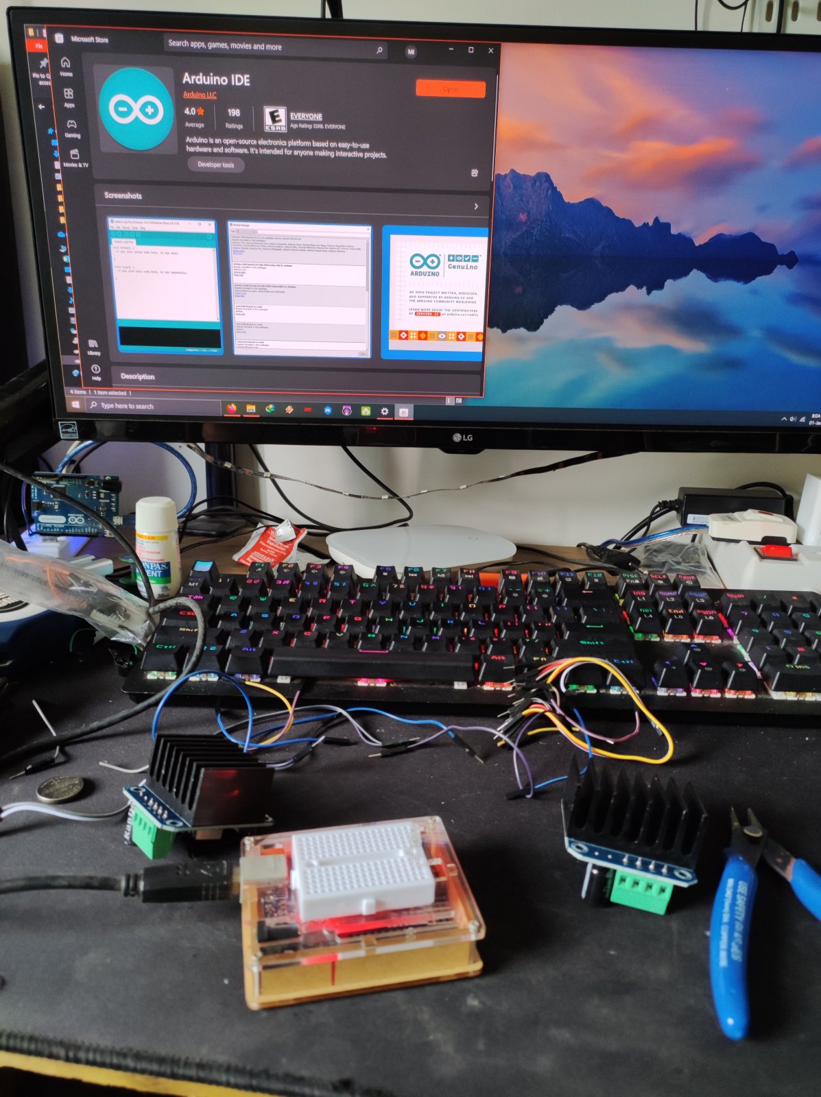

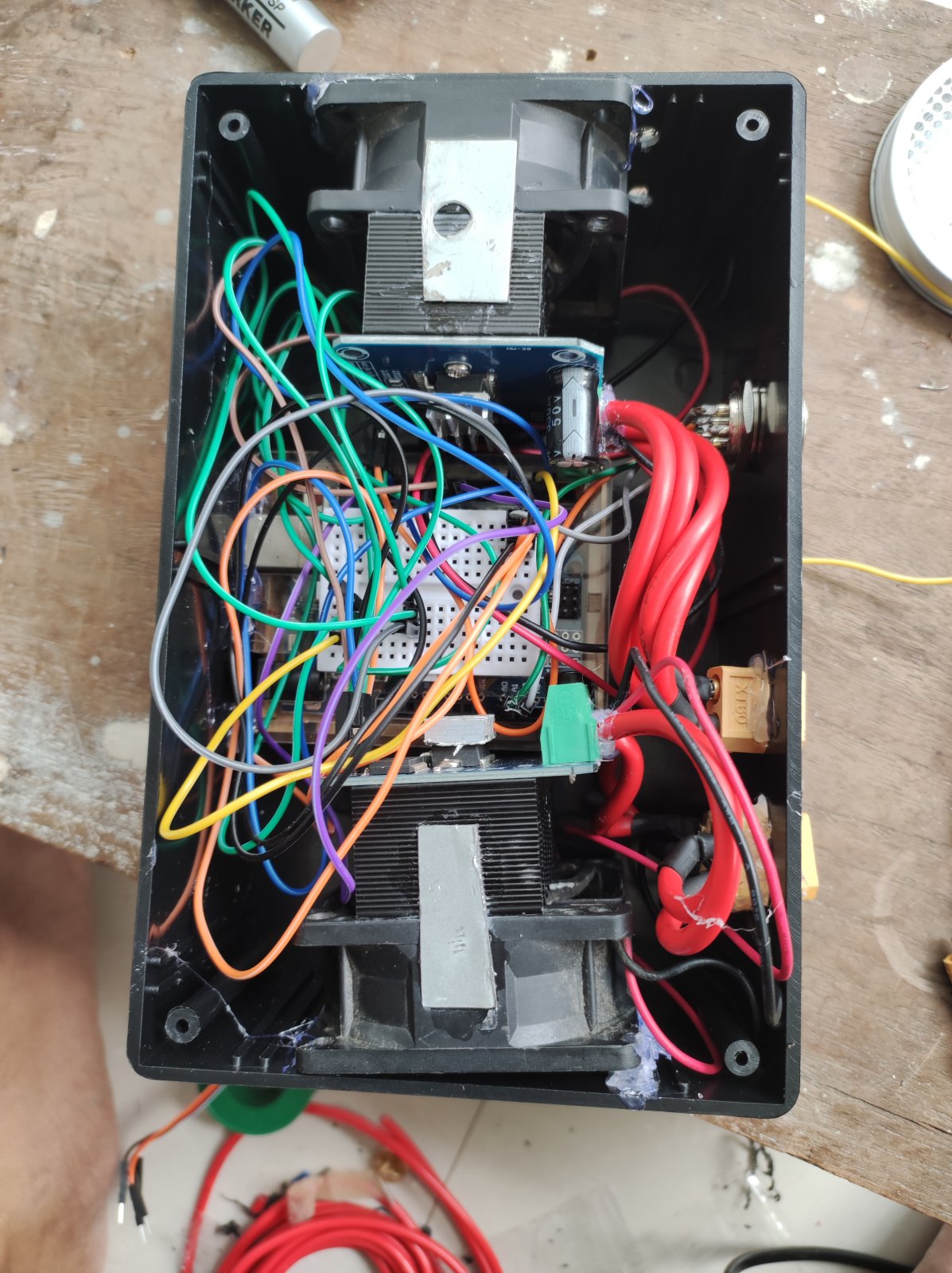

    Update, done with the electronic.
    Not a tidy work, or clean build, but hope it can do the job.

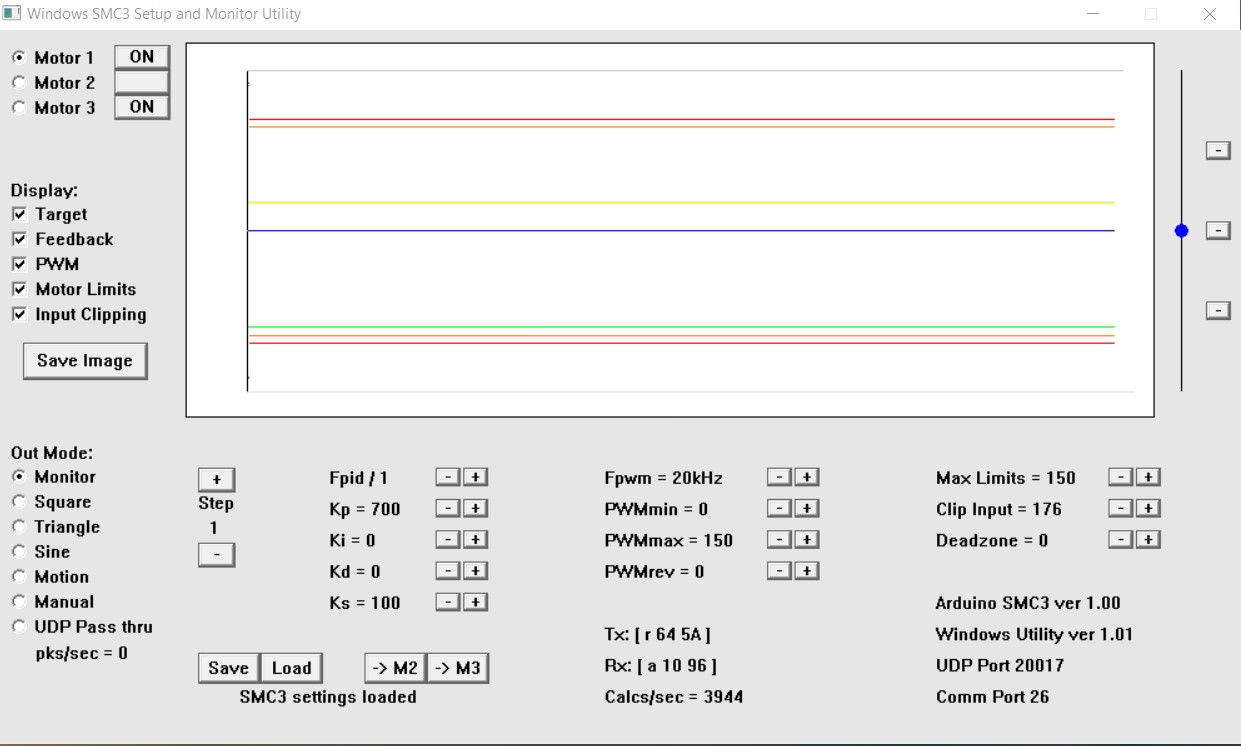

    Testing smc3 software done. The motors work fine.

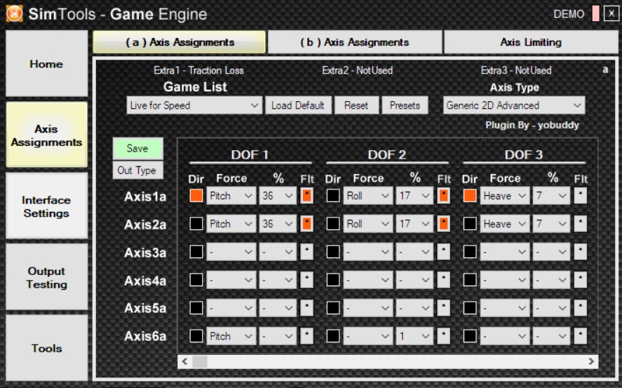

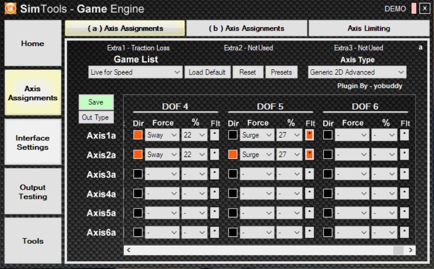

    finally testing phase on LFS.
    you can see the feedback is so rough. Its so scary to be on it.
    I have to decrease a lot of force to make it ride able.
    need some help and tips to make itu smoother. thx.
    Screenshot 2022-01-07 112125.jpg Screenshot 2022-01-07 112101.jpg smc3 settings.jpg
    21,034
    147,902Coins
    +10,880 / 54 / -2
    See the FAQ motion profile tuning tips here: https://www.xsimulator.net/community/faq/steps-to-create-a-motion-profile.228/
    You have not included it but likely you need to capture the Tuning Center Max/Min values and then tune from there. Keep in mind the the BIGGER the value the smother the motion, over a larger axis range, and the SMALLER the TC value the sharper the motion, over a smaller axis range.

    You leave motion enabled when refining a motion profile. If your base settings are way too harsh manually change the Tuning Center to higher values and then capture Max/Mins, followed by tweaking to suit personal preferences.

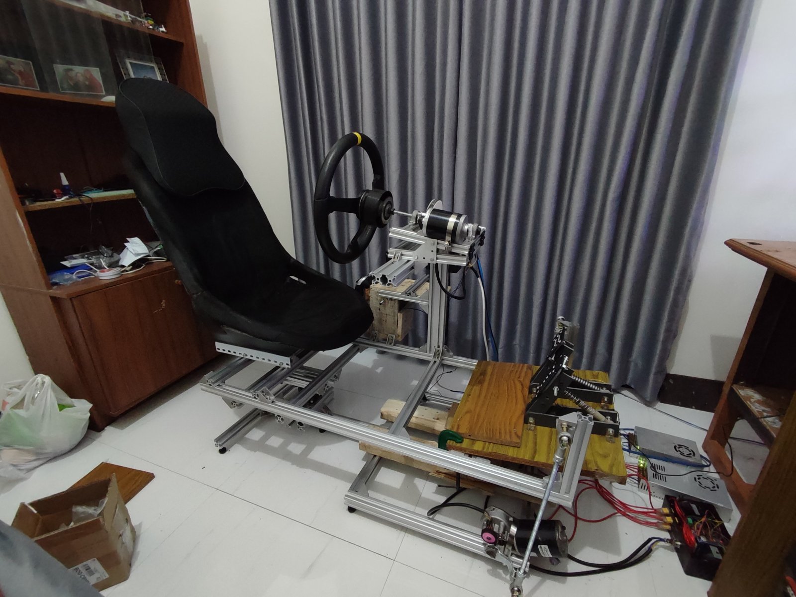

    *update. Installed my DIY wheel base and sequential shifter.
    next is building new base for my pedals.
    hope can get it done soon.
