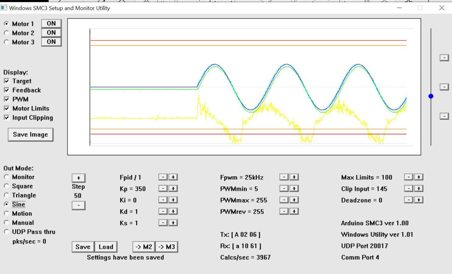

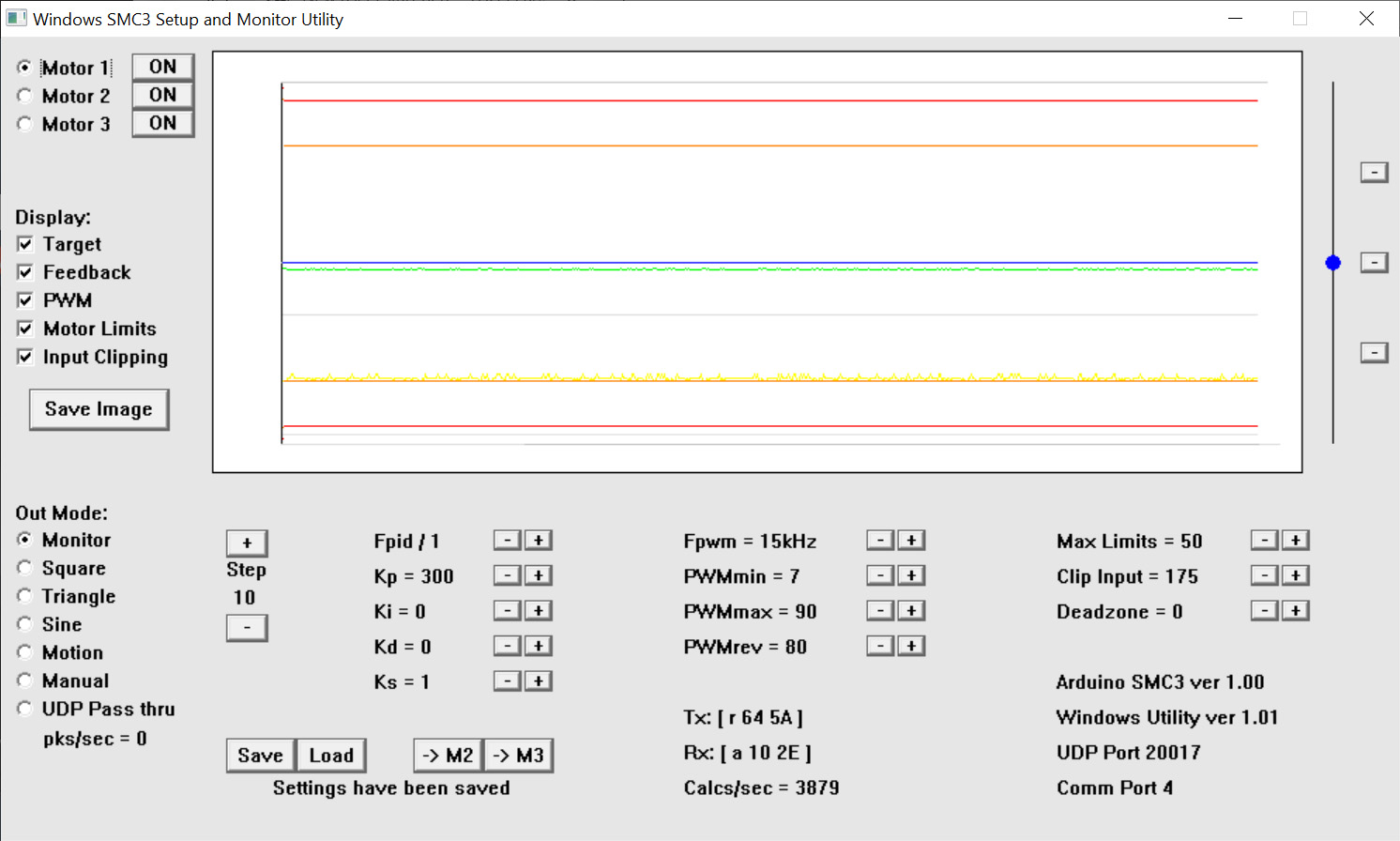

    My first version of the build felt "rough", but not like this really noticeable stair-stepping. I ran across a thread that had me try lowering the Fpwm so I lowered it from 25 to 15 and it really smoothed it out in SMC3 (sine wave pattern). The smc3 image shows my current setup with the exception of the new Fpwm=15khz. I tried 10khz just for kicks but I start getting coil whine.

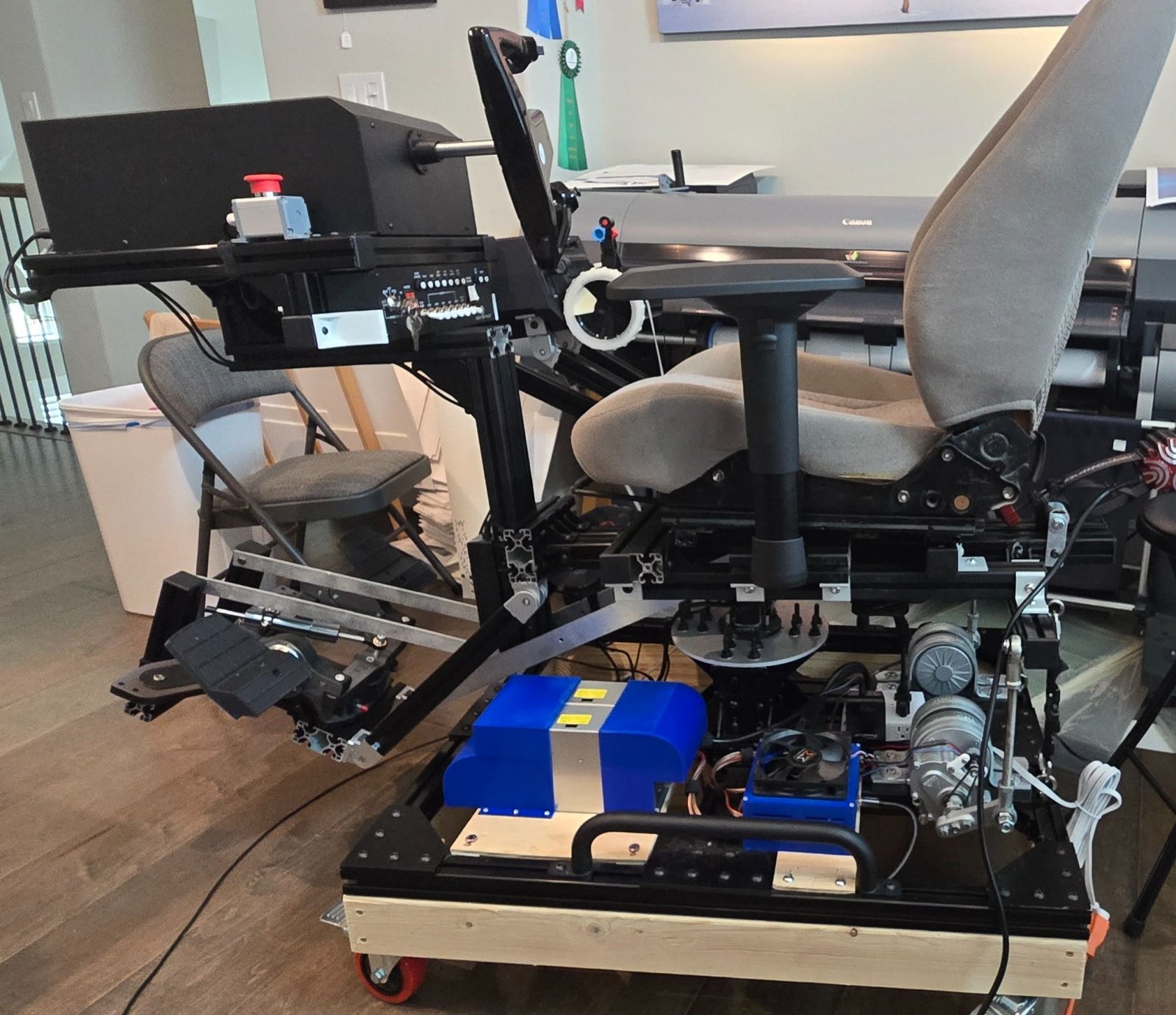

    Regarding the rebuild... the only thing I did was replace peripherals (swapped out hotas with ffb yoke, hc bravo, and vkb t-rudder with mfg crosswind which is quite a bit heaver) and a car seat which added some weight (and moment to the front end). However, when I'm on it (300lb), it is pretty well balanced. I didn't mess with the electronics or power train.

    I did some more tweaking in SMC3 to create the smoothest sine-wave motion within SMC3. Here are current settings. No change in the stair-stepping in-game however. It would be wonderful to be able to see the game data in SMC3. Or even just be able to modify the Sine amplitude in the output mode to see if I could replicate the behavior outside of msfs.

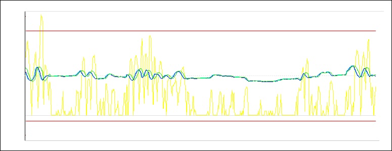

    I saw a similar problem. I zeroed all the parameters except pitch and roll. Works great now. Pretty sure that Heave was the culprit.
    I was also concerned that the rig was not tuned and the base level. That is that MSFS was sending some small signal that was exciting some resonant frequency. I knew that you could hook up a PC in the middle and I did that. The result is that the rig was following an ugly input signal from MSFS.
    I recalled that if you hook up a second computer to the Arduino you can configure SimTools to send the motion commands to a UDP port on that second computer. It's super easy to configure as a second interface. SimTools figures out what is active and does the right thing.
    Here is a screen shot from that session on MSFS 2024. Level flight clear day. It is jarring. This is before I turned off heave,

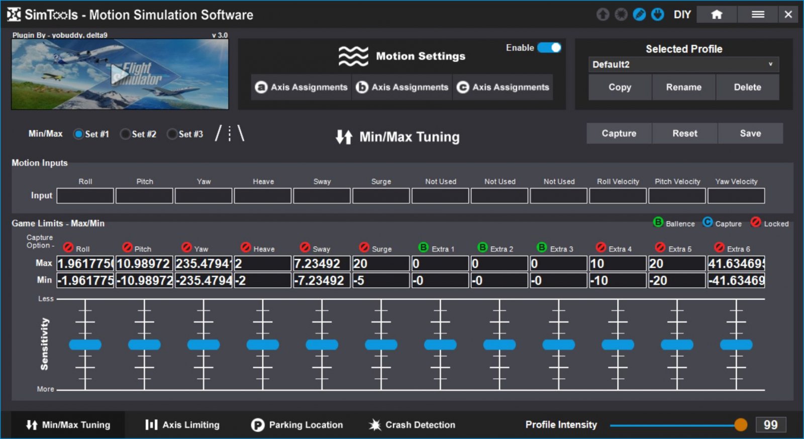

    Can I suggest you capture the Min/Max values from the Tuning Center, then refine from there.
    The smaller the value the faster the response, but that will amplify the stepping effect over a smaller axis range, while the greater the value the smoother the output, over a larger axis range.
    To test initially set Heave, Sway and Surge to zero, and set roll and pitch, or alternatively the Extra values if used in place of roll and pitch, to 80. Does that make a difference?

    The Extra 4, 5, and 6 correspond to Roll, Pitch, and Yaw velocities or acceleration. These more accurately reflect the actual forces in a cockpit than just roll pitch and yaw.
    The smc3 graph looks like turbulence to me perhaps? Therefore turning off Heave making it go away makes sense.

    I tried SMC3 Sine again and it still feels quite smooth. No sign of the stepping. Note that it could be possible that it's smooth because the SMC3 sine is fairly fast and there is no way to adjust that that I can see. If there was a way to change the parameters of the sine wave to make it much shallower, that would be helpful to troubleshoot my case.
    I do use the min/max capture and then make adjustments while in flight to each motion independently. With the exception of the stair-stepping, the sensitivities and overall motion feels good and reasonable.

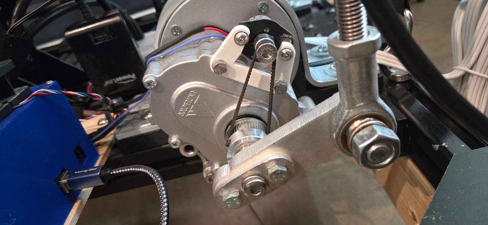

    I think I may have found something. I took off the pot belt and the linkage from the motor to the chair so it can spin freely. I turned on smc3 and set the pot so that it will turn at it's slowest speed that I could manage. I noticed that I could stop the lever with my hand. If I turn the pot up a bit, at some speed I can no longer stop it. It seems either my Kp or PWMmax isn't high enough. I'm reassembling now to see if that solves the issue.

    No dice. I tried raising either/both Kp and PWMmax and it just made the stepping more abrupt. I tried lowering it and it made it "mushy" but still obvious. It's like the output is low resolution, making it behave like an etch-a-sketch.

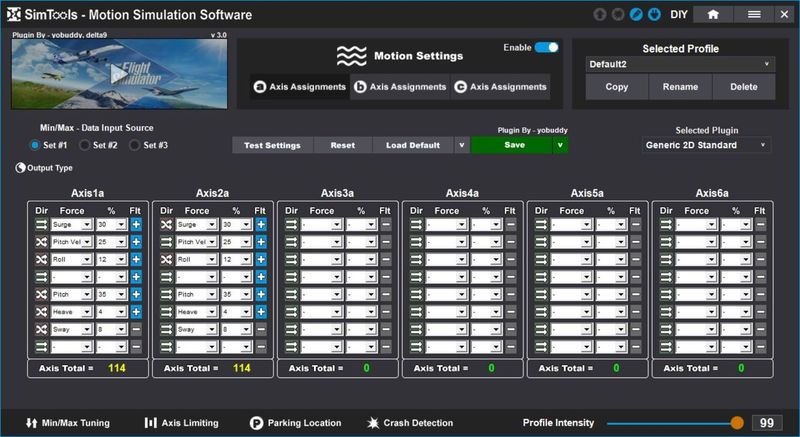

    Uploading my ST3 interface settings just in case something here isn't right.

    After much reading, I becoming convinced that I'm experiencing cogging and I suspect the gear ratio is wrong for my flight sim. This set up would probably be great for racing, but I either need to use a shorter ctc, or get a different motor. Or come up with a gearing solution. First step will be to drill a shorter hole in my lever to see how much of an improvement that makes. Fortunately I designed it with quite a bit of range of motion to play with.
