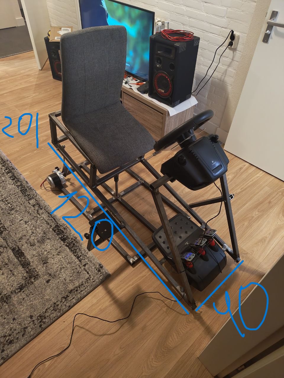

    if you have welding at hand, you can use a steel profile 25x25 and 30x30. here is a photo of my project, the paper with the drawings got lost somewhere. The lower rectangle is 50 by 100 cm. I inserted a 25x25 profile into 30x30 to allow future adjustments for the height of the seat and the length of the pedals. Also, in my case, it seems to me that it is better to place the motor in the front. Take the cardan from the car so that it doesn’t wobble. Before starting assembly, read the forum.

    Hi. Thank you for your input. Yes I have welder ready. Went thorough forum few times, I'm kinda type of person who first spend few hrs doing research and then posting. Thanks a lot again. :)
