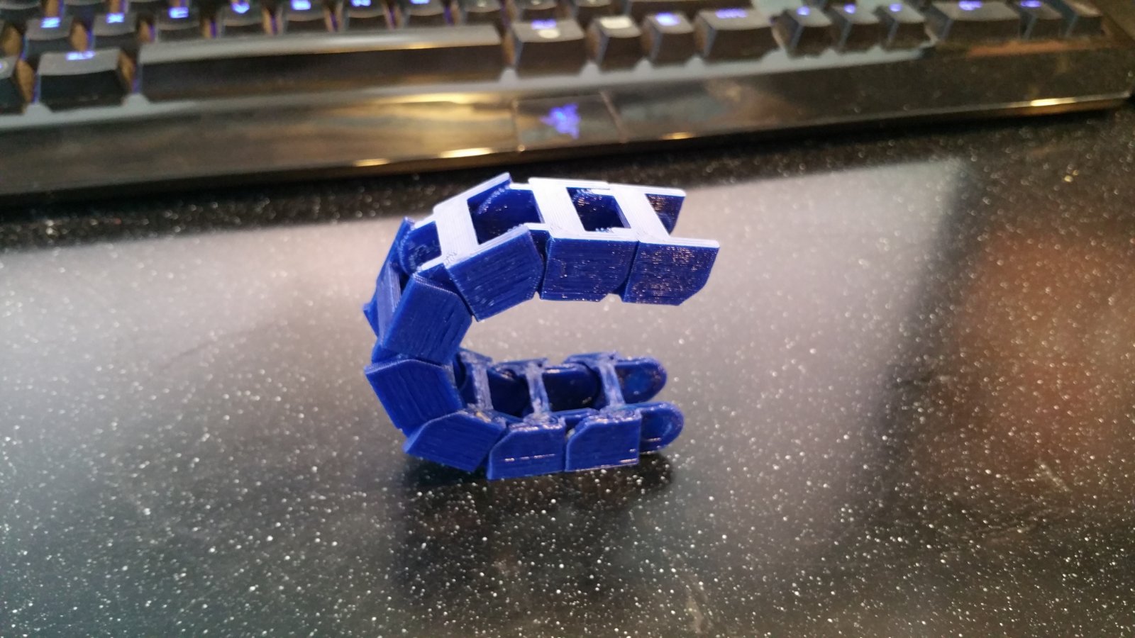

    Not sure I will actually use these on my simpits but it will work a treat for my CNC router table.
    http://www.thingiverse.com/thing:11978/#files

    Search amazon for Drag Chain
    I highly suggest buying a drag chain over printing them. They take quite a bit of time and are relatively cheap to buy. The one you shared is off of thingiverse and actually will unclip pretty easy at the right angle.

    I printed like 100 of them for my CNC machine, was pretty much a pain in the butt as far as I was concerned. The longer you get the more they seem to pull apart so just me mindful of length. The other thing I would say is make sure the wires that you run through them you wont be unplugging and moving much because its a pain to run the wire through them and back out if you need to move something around.
    Sorry, I didnt see the link because that enormous picture drew me in.

    I have another design that I am going to work on later as well. It is actually a kit created to be cut on the cnc found on cnczone. It has interlocks to keep the links from coming apart. Thought I might run them on the 3D printer instead and see how they go.
    I am pretty impressed with the ones I have run though. I can see that binding would break them apart but if I run my wires well that would not be an issue. The PLA is pretty ridged, what type of filament did you use?

    Both PLA and ABS. I wondered if PETG would work best since its more flexible but might not bind enough to hold the pins in the holes.
    I think ideally it would be best if we could design a drag chain that could bend both ways...I would imagine it to look more like triangles or scales on a snake kind of.

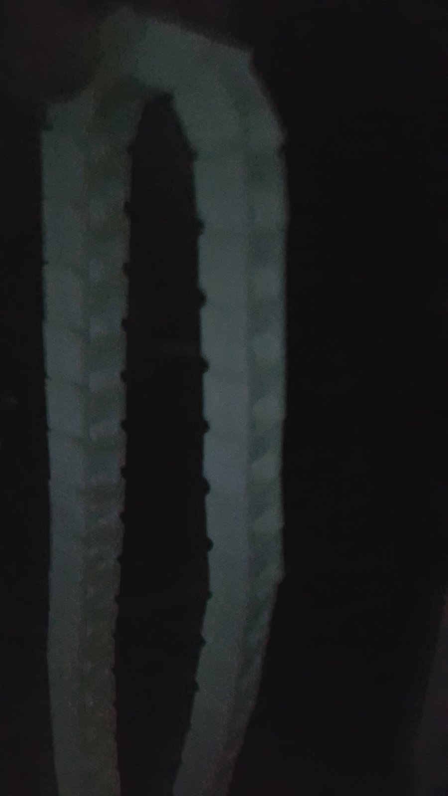

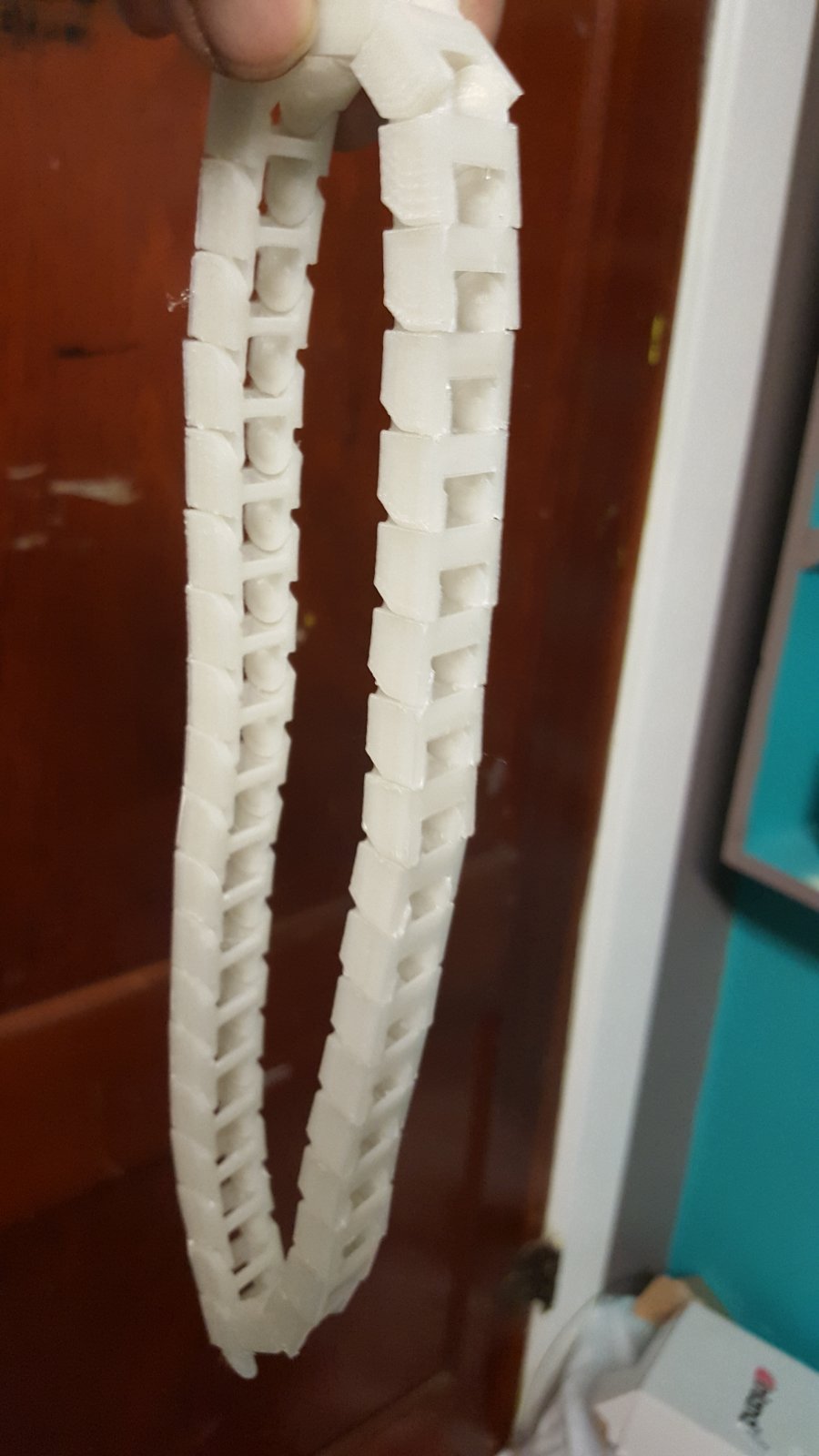

    I printed a bunch of these in luminous pla. Once cleaned up they work decent.
