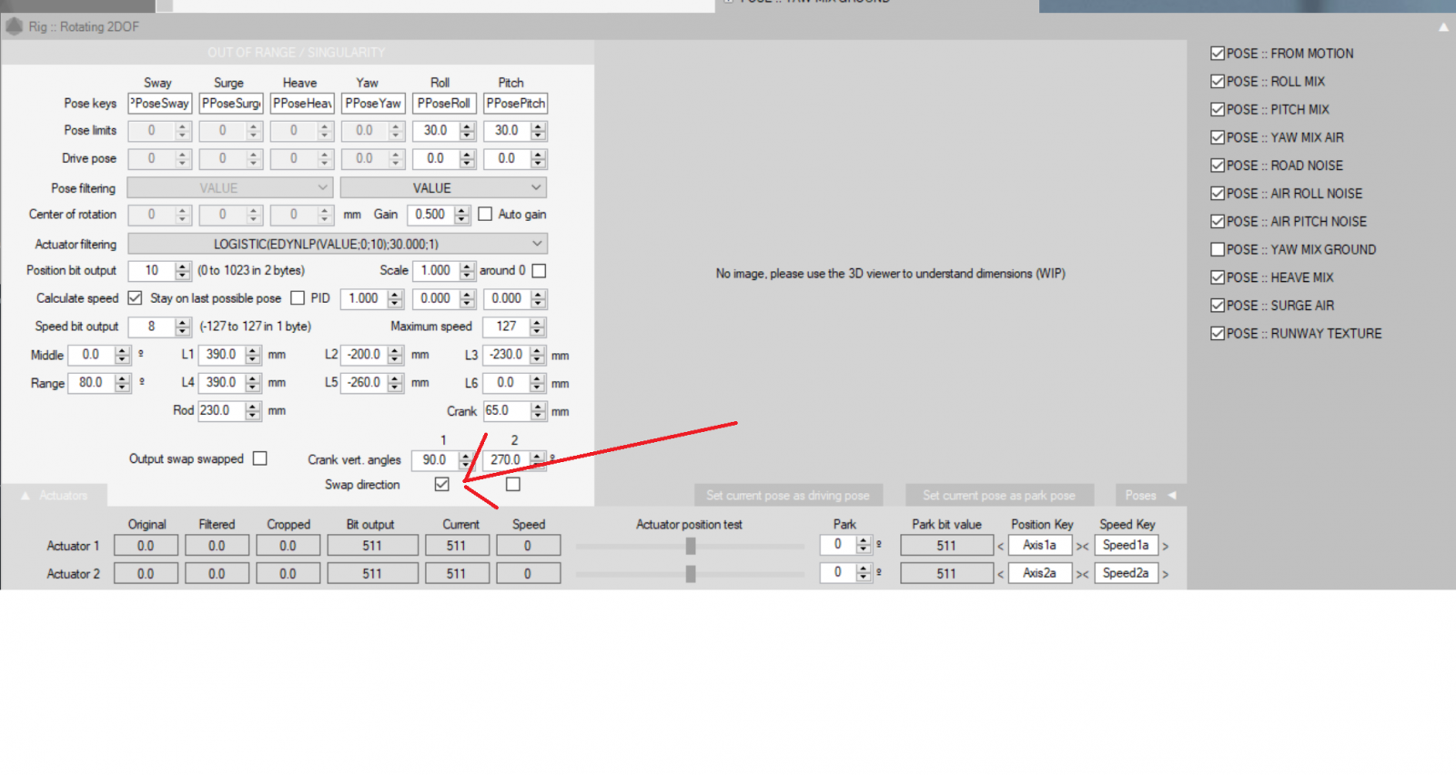

    I've constructed rack & pinion drives from the ali wheel chair motors but because they behave like actuators (not a rotating crank), I'm setting up the rig in FlyPT as a 2DOF linear actuator rig. However, because the motors are mounted mirrored, one is reversed. I already swapped the power to the motor but realized I need to change the polarity of the hall sensor too, so before I mess with that, is there an easier way to do this within FlyPT? Seems like there should be a way to reverse a linear actuator's direction like you can reverse the motor's direction when setting up the 2DOF rotating rig.

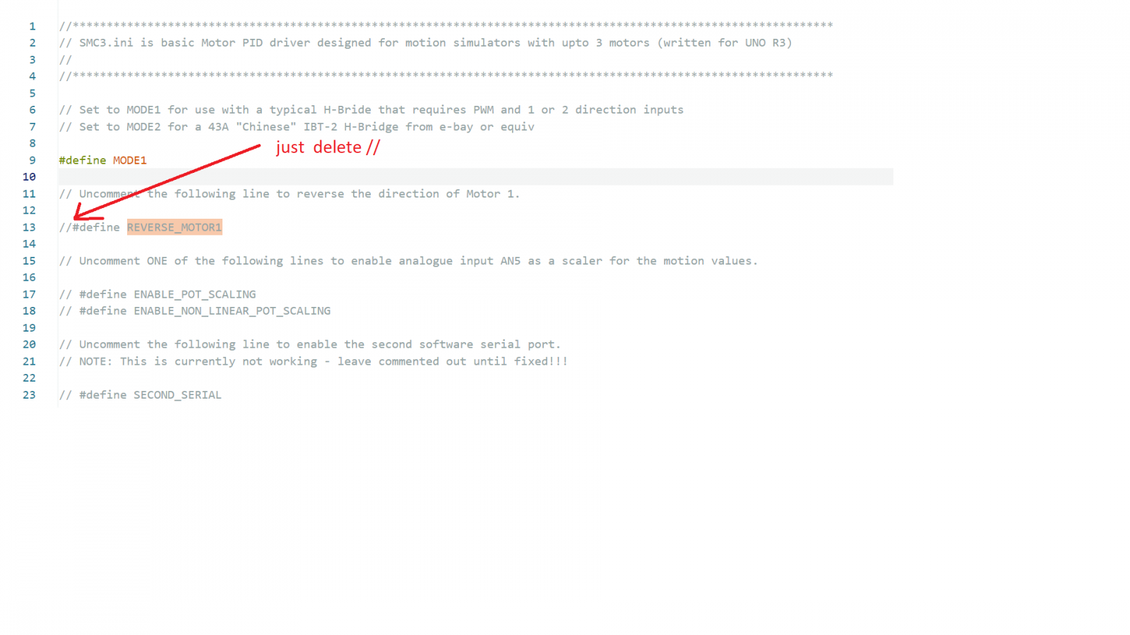

    See, I think in arduino smc3.ino you can reverse the movement of the motor.
    Possibly in flyptmover swap direction

    That's a rotating DoF. I need it for a linear.
    I suspect it's easily done in SMC3 but my coding ability isn't great so if anyone knows how to do it off hand, please let me know.

    Just edit the draft smc3.ino in line 13 and delete the // characters
    Motor 1 will move in the opposite direction of the instructions sent from the program.
    Note, I have not tested this function personally reverse Motor 1 direction.png

    Finally got around to trying this, but I'm using Sebastian's I & D fix + slow start version and it's not there. I wonder if I could just add the line? Doubt it.
  8. Attyla.pl
    Attyla.pl Active Member
    Oct 1, 2023
    308
    Polska
    1,329Coins
    +92 / 2 / -0
    Unfortunately this is not enough, maybe Sebastian could add the code from the original smc3.ino ?
