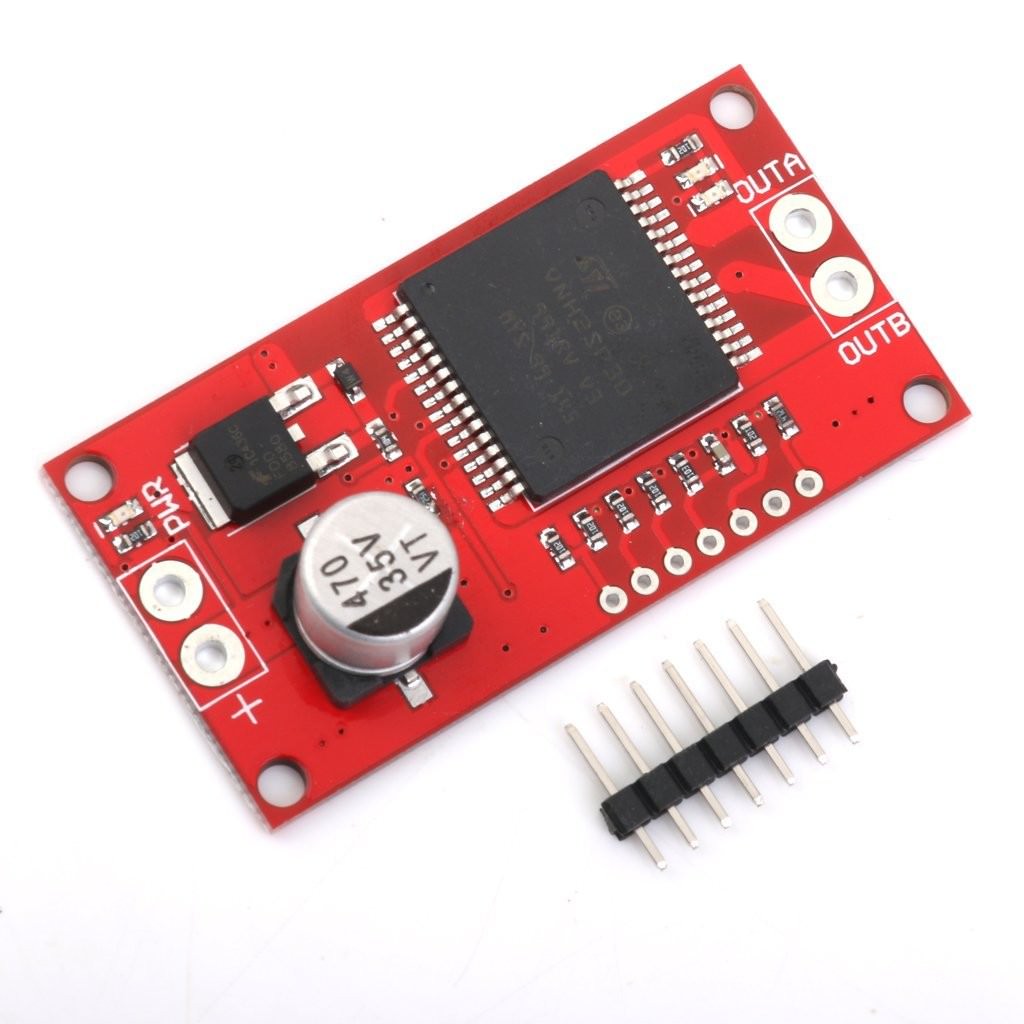

    I don't see any numbers or marking on the headers so that's why I'm asking.

    +261 / 5 / -0
    2DOF, 6DOF
    Yes

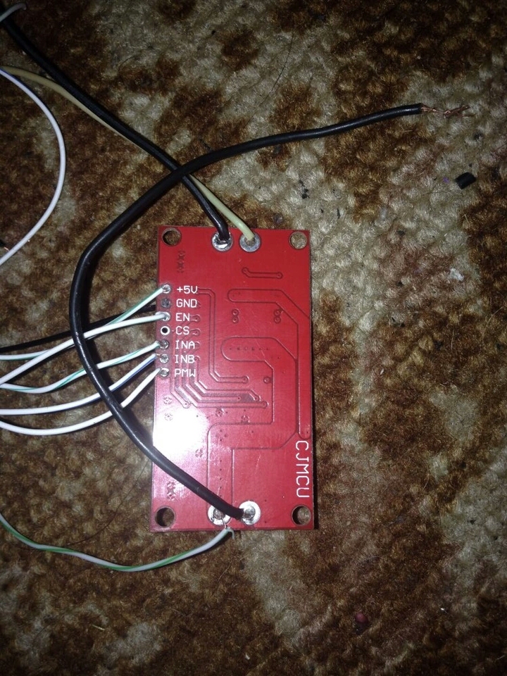

    Came in the mail today! I wired it up but it isn't working correctly. Motor is moving slow in one direction and even slower in the other direction. Where does the one labeled EN go? I'm using SMC3..

    Yes it is. You have to buy several to find one that works well and have a spare.

    Yes, luckily I had ordered 2 from different sellers on amazon and the second one works perfectly! Yes!!!! Traction loss is better than I expected.:grin
    Thanks for your help!!
