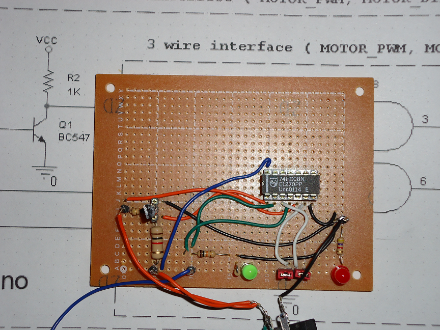

    Another way tried is to wire a card in between like this :
    This would be my preferred method.

    A couple of alternate ways of using these H-Bridges with existing Arduino controlles:
    1. Use the H-Bridge EN pin as the PWM input and use the PWM inputs as the Direction pins. Sounds odd but this drives the H-Bridge in drive/coast mode which is generally fine for motion sims as they are always in motion.
    Arduino DIR1 -> H-Bridge LPWM
    Arduino DIR2 -> H-Bridge RPWM
    Arduino PWM -> H-Bridge EN
    2. Use the SMC3 Arduino software in MODE2 - its already configured for this type of H-Bridge (Refer to the doco for connection setup details) This will drive te H-Bridge in drive/brake mode.
