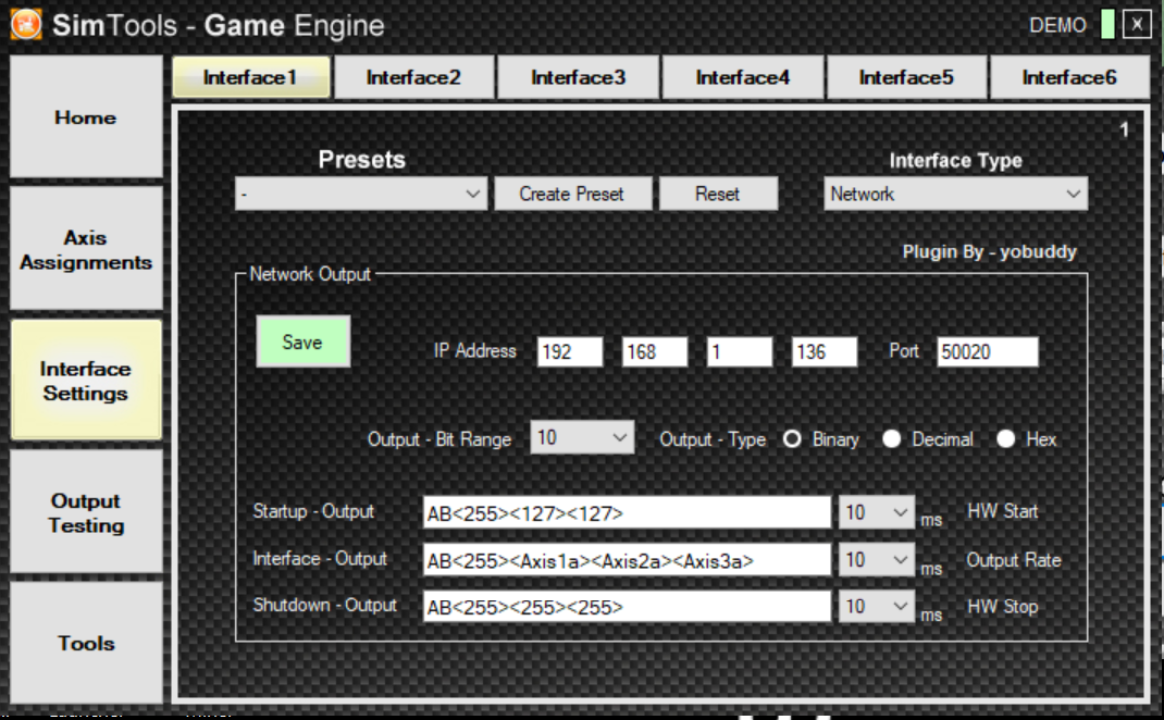

    I already read and follow the manual of SimTool and YawVR. However the testing didn't work. :(
    I configure the settings as in the screenshot. Am I wrong something in there. Please Help Me!

    Don't know how I missed this post in my searches. That looks nothing like the settings from their manual.
    On Interface 1 set the IP address to the device's IP address shown in the YawVR app.
    Change the port to 50010
    Output bitrange of 10 is fine.
    Change Output-type to Decimal
    Change Startup-output to: SIMTOOLS_INIT and change ms to 0
    Change Interface-output to: YS[<Axis1a>]P[<Axis2a>]R[<Axis3a>]B[10] and change ms to 12
    Change Shutdown-output to SIMTOOLS_EXIT and change ms to 0
    Don't use any forces on Axis1a for now.
    Set simtools axis limiting on Axis2a and Axis3a to 8% or less to start with.
