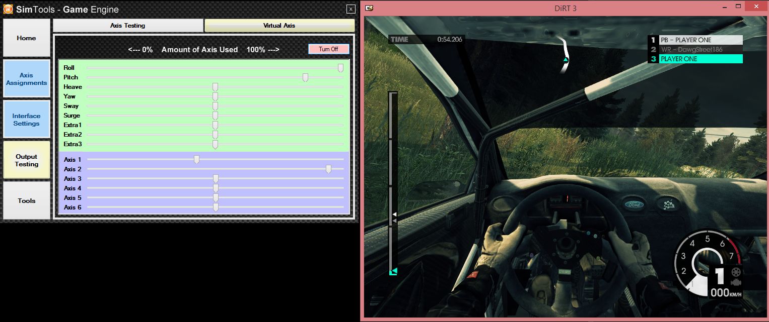

    Looks like the roll is inverted in this plugin, too... :)
  3. eaorobbie
    20,431Coins
    +1,684 / 23 / -2
    The CodeMaster plugin is awaiting and overhaul so we can add dash out data to it.
    We will fix this little issue, for now just invert it in the Axis Assignments, Sorry.

    Hey all! I am running Dirt 3.
    The game plugin installed, motion patch installed successfully, but the tuning center does not show any value.
    Furthermore, the Game Engine crashes at the start of the race.
    Any suggestions/fixes?
    P.S: I am not new with the sim tools thing. I have already used plugins for NFS successfully.

    good evening everyone.
    I have a problem with the patch of dirt 3.
    I not only have no value in sight in the green part but also at each end of the stage the game crashes with an error message.
    someone was there an idea.
    thank you

    Is Dirt 3 on X86 or 64 system?
    For 64 the patch path is in the Game folder in My Documents. For X86 the patch path is the install directory of Dirt 3.
  19. matrixpascal
    matrixpascal Member
    38
    305Coins
    x86 when I patch the game he told me ok
  20. noorbeast
    21,020
    147,824Coins
    +10,876 / 54 / -2
    Can you please confirm you have patched to the install directory of Dirt 3?
    Try un-patching, close Game Manager, then run Game Manager as Admin, then patch to the the install directory of Dirt 3.
