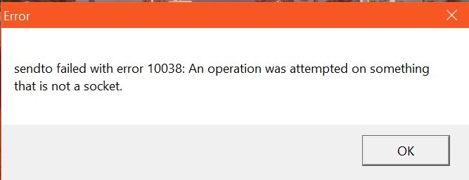

    Another issue, the plugin for this game seems to break it. Once the game is patched, I can recreate this error every time I complete a race in the showdown tour. Once the race is complete, the game crashes and produces the following error;
    If I unpatch the game for motion, the game works perfectly fine, so it appears that the motion patch is what is breaking it.

    I wasn't aware, that Dirt Showdown also has this issue with extradata = 1
    I will have to change back to extradata = 0 :(

    value1 updated Codemasters Dirt Showdown Plugin with a new update entry:
    Extradata=0
    Read the rest of this update entry...

    Thanks value1, played this for a an hour or so this morning, different modes etc, doesn't crash anymore.
