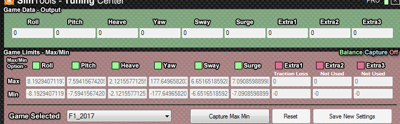

    Have you tried capturing new Min/Max settings for your sim?

    I make new tets and I realize that the surge and sway pose problem
    Roll and pitch work very well ...
    I tried with new capture and reloaded the plugin it's the same
    the values are unstable in motion
    I am the only one to have this problem?

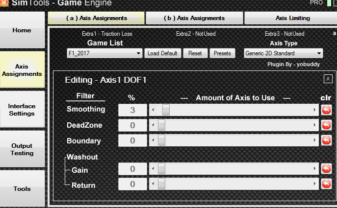

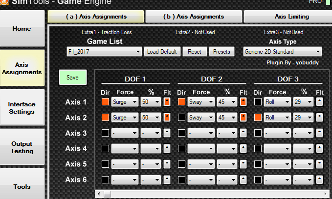

  13. Djules
    Djules New Member
    Nov 4, 2015
    19
    78360
    - 175Coins
    DC motor, Arduino, 4DOF
    Hi Noorbeast
    This my setting
    21,043
    147,956Coins
    +10,883 / 54 / -2
    You seem to have an unusually high Axis Allocation for surge and you mention pitch being OK but it is not shown in your settings. If pitch has an axis allocation then the total for all allocations is too high, as it is already well over 100% with just sway, surge and roll.
    I also am not clear what you mean by this, "values are unstable in motion". Do you have a video that can show what the problem is?
    I would suggest that you redo your profile one Axis at a time, following these steps: https://www.xsimulator.net/community/faq/steps-to-create-a-motion-profile.228/

    My guess is that you need to re-capture your max/min settings for the game.
    Also, consider adding one DOF to the axis assignments at a time.
    Once that one feels good, adjust it to 0% for output (so it is off) and add another.
    Once all effects feel right, turn them all on and adjust percent's as needed.
    This way you will find and eliminate your problem buddy,

    @Leandro Kemp for capturing min max you should do a clear round without crashing and then fine tune one dof per time and then mix them all and fine tune them a bit again.
    i see you are running the game in window mode. there was something similar reported from a member here for dirt rally too. could be the same bug for the f1 2017 https://www.xsimulator.net/community/threads/codemasters-dirt-rally-plugin.6823/page-4#post-78802
    http://forums.codemasters.com/discussion/6550/dirt-rally-erratic-annd-jittery-motion-telemetry
