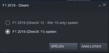

    The plugin runs live 11 but if we launch the game live 12 Game Engine and Game Manager does not turn blue.

    Hello, the plugin works in dx12 or in dx11 thanks

    With me works with direct 11 but not with direct 12

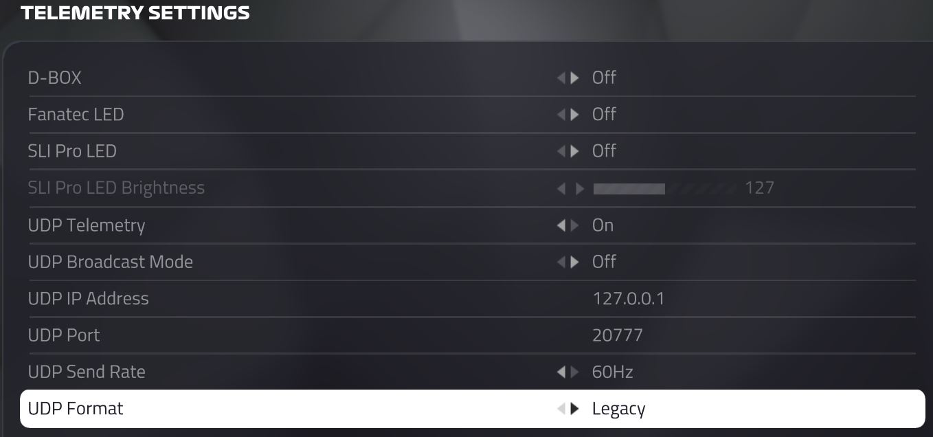

    Bonjour, simtools ne detect meme pas que je lance le jeu. une idee ?
  12. yobuddy
    5,282
    49,206Coins
    +5,093 / 18 / -0
  13. Pascal TALAVERA
    Pascal TALAVERA New Member
    Jun 16, 2019
    149Coins
    quand je lance simtools . il ne detecte pas f1 2019. donc rien ne fonctionne
  14. DoubleM
    DoubleM Member Gold Contributor
    Jan 2, 2018
    46
    Amsterdam
    - 23Coins
    +20 / 0 / -0
    Try these settings.

    The plug-in only runs in dx 11 legacy mode. So starting the game in dx 12 mode, will result in no motion.

    pity because the dx12 version works really much much faster thank you for the info

    [QUOTE = "DoubleM ext 181777, member: 28544"] Try these settings.
    [Attach = full] 63943 [/ attach]
    [Attach = full] 63944 [/ attach] [/ QUOTE]
    everything is ok works with DX 11.
    thank you so much
