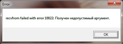

    After installing the patch, the game is started but the error comes before the race recvfrom failed with error 10022:received is not a valid argument. Remove patches, the game works. Sorry for my english.

    10022: WSAEINVAL (Invalid argument).

    Ok so thats a windows socket error. Any sort of malware or virus protection running? Have you allowed all permissions? Are you running as administrator? Does this happen on all games? What version of windows? 1 computer or 2 for your setup? Has it ever worked before?

    Have you made these adjustments?
    Open \documents\My Games\DIRT2\hardwaresettings\hardware_settings_config.xml
    with an XML editor, best is editor notepad++
    Change the "motion enabled" parameters to the one you see below:
    motion enabled="true" ip="127.0.0.1" port="20777" delay="1" extradata="1"

    Also are you running simvibe or anything other sim type software at the same time? If the above doesnt work I would close everything out that I possibly could. I think you have a sharing conflict in regards to your sockets.

    For completeness:
    With RecvFrom, WSAGetLastError result: WSAEINVAL, the socket is not bound (ie. prior call to bind failed).
    If the program works sometimes and not others, or frequently works after a boot but fails after computer has been running a while, I'd ensure other software like Skype hasn't nab'd the port your looking for.
    Their are software from SysInternals (all free, they are now owned by Microsoft) called TCP View (tcpview) that will show which processes are currently in control of which ports (both TCP and UDP).
    If all else fails, ProcessMonitor (also from SysInternals, and free) can show you all the TCP/UDP activity for all processes, and most importantly, even if software isn't written to give an error message for a bind that fails (they nearly always succeed), you can click on it and get a call stack and error information.
