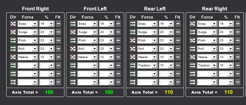

    I'm new to SimTools and have installed the new V3 Version. I don't know if it was a good idea, because most of the posts does not match the V3 Version :(
    I have setup F1-22 with a bit of try and error to my 4 Axis and have assigned, Pitch and Roll + Sway Surge Heave with 20% each. Basically the actors are working, but I would like to know, what common mapping you other people use?
    I have read something about the tuning center etc. but I haven't found it yet in V3 ...
    So I would love to get some informations about your mixings of the Axis for a 4DOF (or is this a 3 DOF? I'm confused here too ... )

    I found a good basic setup from Force2Motion:
    This feels nice with my VR Headset!
