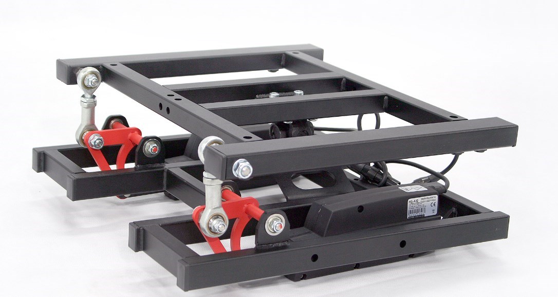

    I read a lot of great posts on this website and looking to jump in and build a motion Flight Simulator sim. I got my Thrustmaster Joystick, Rudder Pedals and Throttle and having some good fun on Prepar3D general aviation airplanes. But something is missing :grin

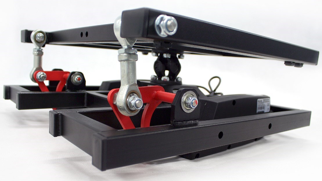

    Reading the forums, many smart guys have had good experiences with the 24V 75RPM wheelchair motors. What are your thoughts on motorized Actuators? I have attached the datasheet of the PC-09-HALL linear actuator from Progressive Automation ($174 each, 8" stroke) and a picture of the inspiration model. This also comes with the Hall effect sensors built in. I would be using the usual hardware; IBT2's, Arduino UNO3 and 24V power supplies.

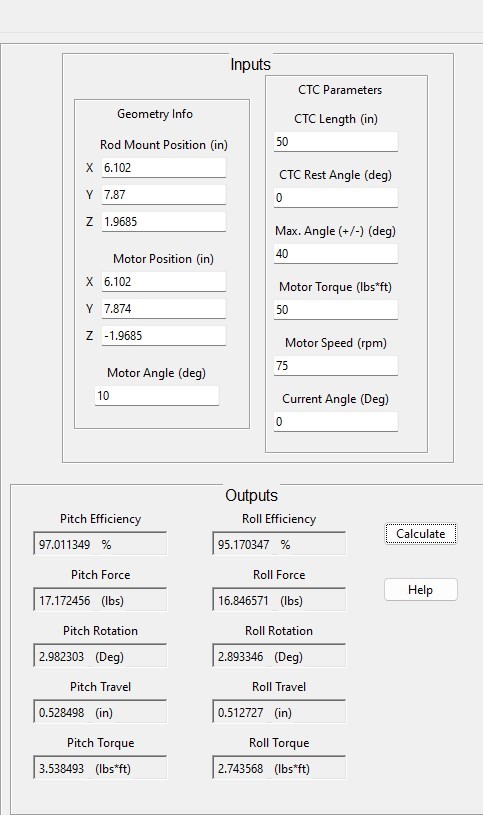

    Looking at the SimCalcs software, it seems the Linear Actuator button is greyed out. I have attached a screenshot of calcs of a similar seat mover using motors.
    Any feedback is appreciated regarding the use of these actuators. Thanks!
