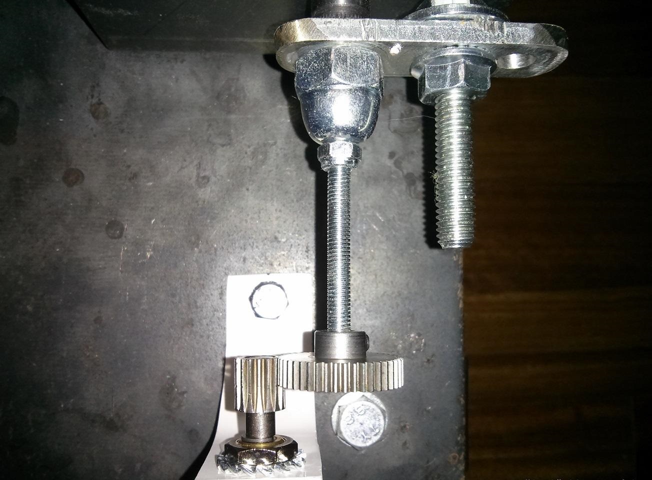

    i am Bernd from Germany and new at this forum. I'm working as a "Measurement and control mechanic" and like to introduce my DIY-project of an 2DOF seatmover. It should be a compact design with wiper motors under the seat. So i decided to use a 3D-program to check if the proportions and movement possibilities are ok.
    The first photos of the building process will follow soon.

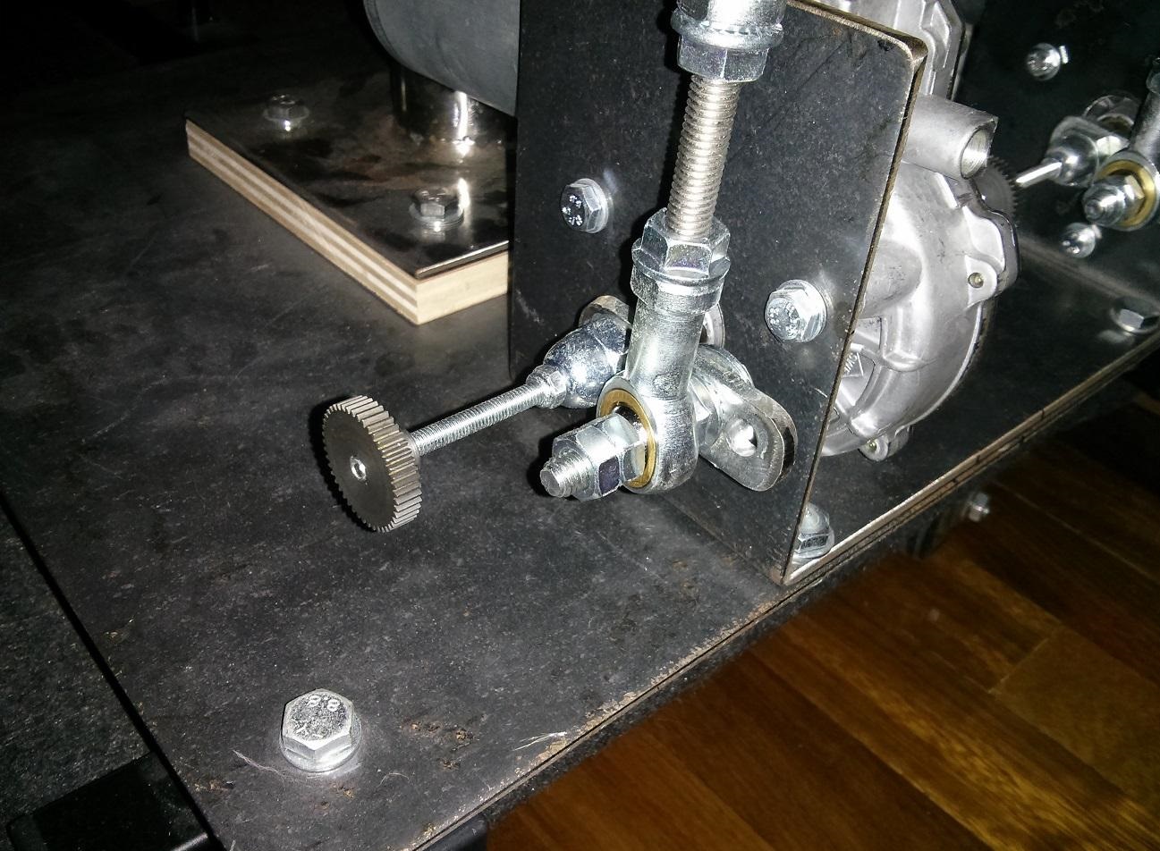

    You may need to shorten your connecting rods(the ones attached directly on the motor shaft). I can't be sure but they seem quite long on the pic.
    Such a compact position of the motors may lead you ending up anywhere from 2,5cm to 3,5cm C-C(hole to hole) rods.

    Hello pipis2015,
    the pics deceive, hole to hole on the connecting rods is 3,5cm.
    As you can see on the new attached pictures, i've added 2 pots on my circuit board, one for zero point and one for range of motion for the motors. They will be added to the Arduino program.
    Also i've added 2 slotted optical switches for each motor, they switch it of (brake to GND) by hardware (TTL and-gates) as a precaution for motor pot break and software faults.
